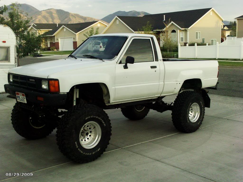

I prefer the sas purely because of the simplicity of it, less moving parts, lets parts to break, but that's just my opinion, i'm sure the ifs can be made plenty strong.
heres my 86 sas, this is not a store bought kit the axle and brackets all came off a 85. Check my sig for mods
