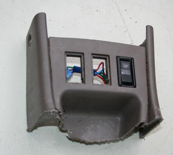

So I ordered the Tuffy 6.5 inch locking console in camel/light tan. It is a snug fit in my 4Runner; the 8 inch console would have been too big. I also kept the rear window switch in its original location, with the help of a Sawzall, Dremel, and file. Since I could find no helpful photos of the Tuffy box installed in a 4Runner, I'm uploading my own. I also have "before" pics and some comparison pics of the original console and the Tuffy, side-by-side. Enjoy!

Attached Thumbnails Locking Center Console-consoles-compared-1.jpg   Locking Center Console-hacked-piece.jpg   Locking Center Console-tuffy-installed-2.jpg
