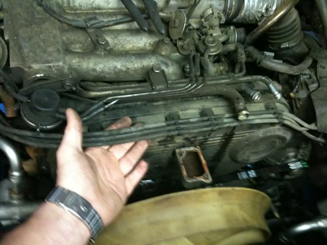

This is how mine started, then the leak got worse, then while on my way to my uncle's house to change my water pump it seized, overheated and I had to call a tow truck... TRIPLE check it's not coming from the water pump before you drive it a bunch!
Another place it could be leaking is the upper radiator hose attachment point... (thing in the middle of the pic)... Mine leaks just a TINY bit off the skidplate from not using enough RTV when I did my water pump. (I'm too lazy to drain the radiator to fix it though)
