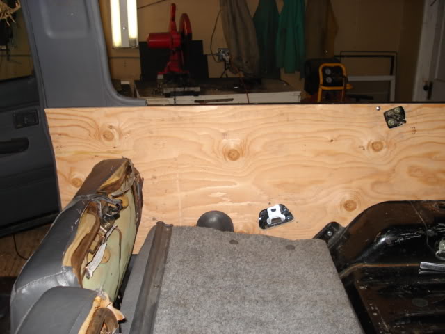

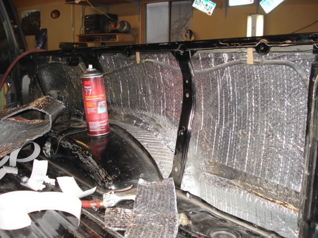

I started mine a while ago, but got more into building my other truck and put the project on hold. Here's the start...
Insulated the entire rear cargo area with this aluminum bubble wrap. Nice stuff, and cheap, like $25 to do the entire cargo area. I form fit it, and then glued it with spray adhesive.

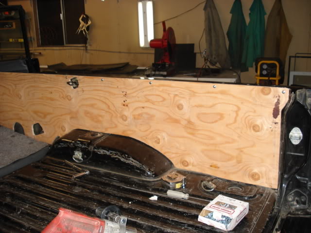

Then I build my side walls. I will be able to screw right into these, so my mounting points are almost endless.
I suddenly want to finish this project.

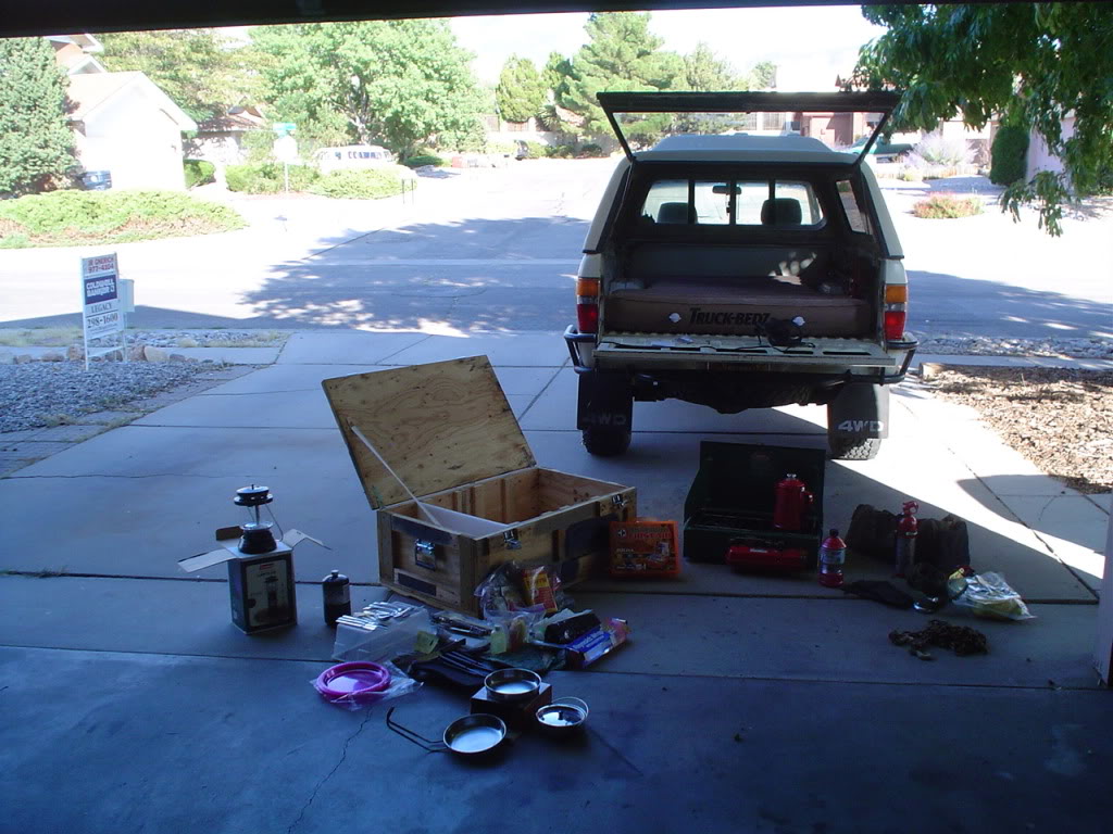

Here is mine.
Box opened up to show the goodies. (I don't own that truck anymore but that's what the box was built for)
Box inside the 1st gen runner.
Sleeping pad after the box is pulled out and set aside. No that isn't my kid.
I can put the camping box in there in about 2 minutes and have it tied down. It works great for a last minute camping decision.
