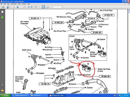

here is a pic of where it goes.
Originally Posted by NYChopshop
thanks! at least I know where it is and what its called... if only I knew what the durn thing did now...
It's right there in the FSM screen capture; water bypass outlet hose.
