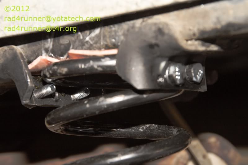

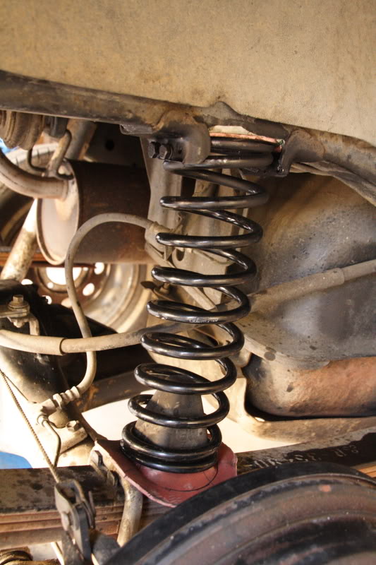

Cool! regarding cutting idea, if you'd like to cut bumpstops very short to prevent stop from "plucking" the spring, and yet help prevent spring from popping out, consider this:

thats not a bad idea rad what do you use to keep the bottom in place? because i was thinking when i flex my rear axle all the way out the side with the tire that is forced down farther the gap between stops is probably going to be way larger than the coil itself so it would just pop right out.. my idea was just to get coils that go around the outside of both stops and tack weld it to the metal part of each bump stop on the very top coil and the bottom coil this way my springs are attached top and bottom allowing them to stretch as well as compress when crawling and flexed
You can see in the last picture there is no additional retainer, atleast non I can spot.
If your size the springs properly and follow the directions.. The leaf springs or shocks keep the gap from opening enough to let the coil loose. Notice the bits where people have either jacked the axle apart from the body or droped the leaf spring shackles, and they still need to use a coil compressor to get them in..
If your undersize the springs you'll want to get the "cups" that replace the lower bump stop. Then your axle drop will be tied to the coil spring.

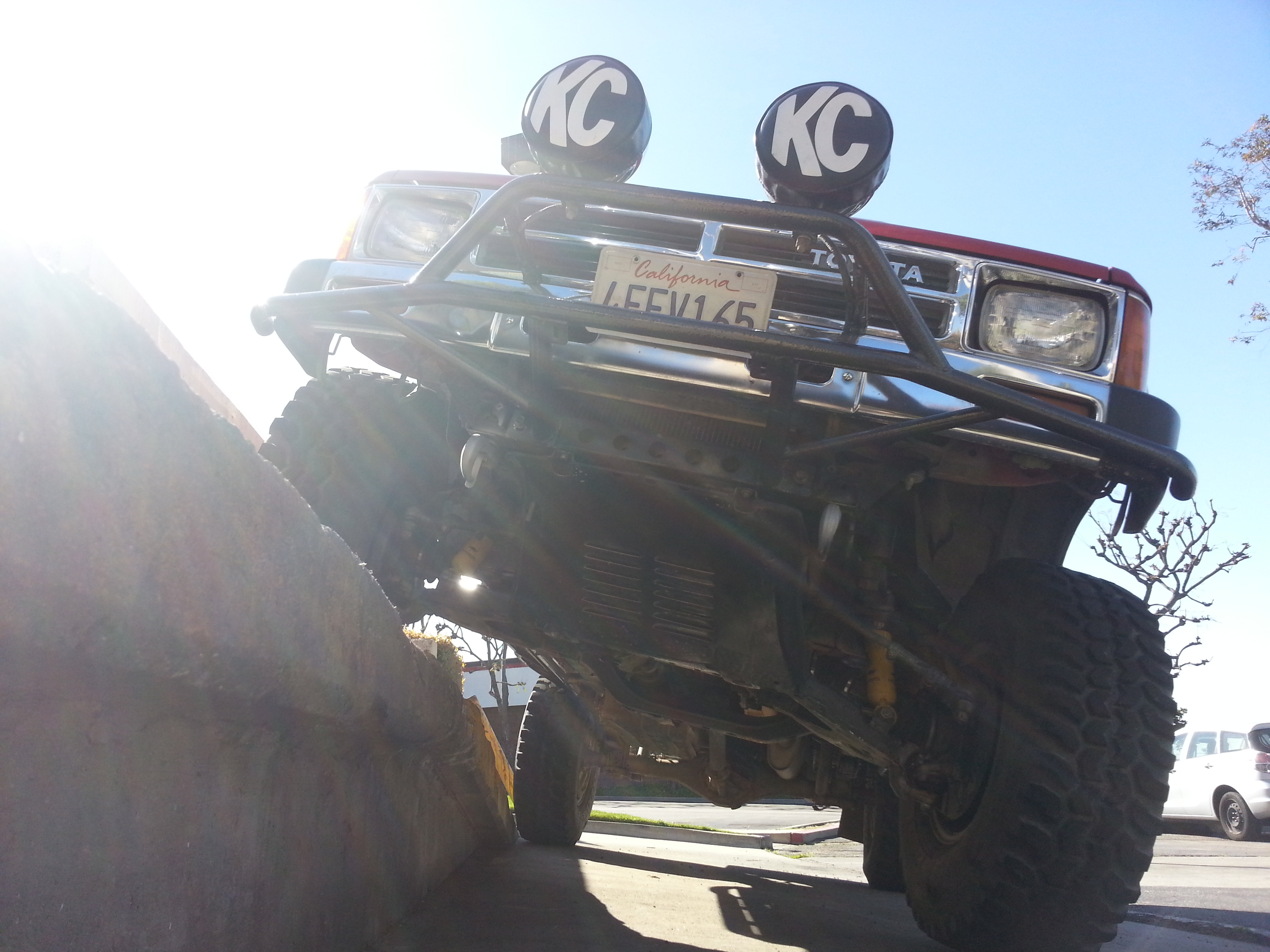

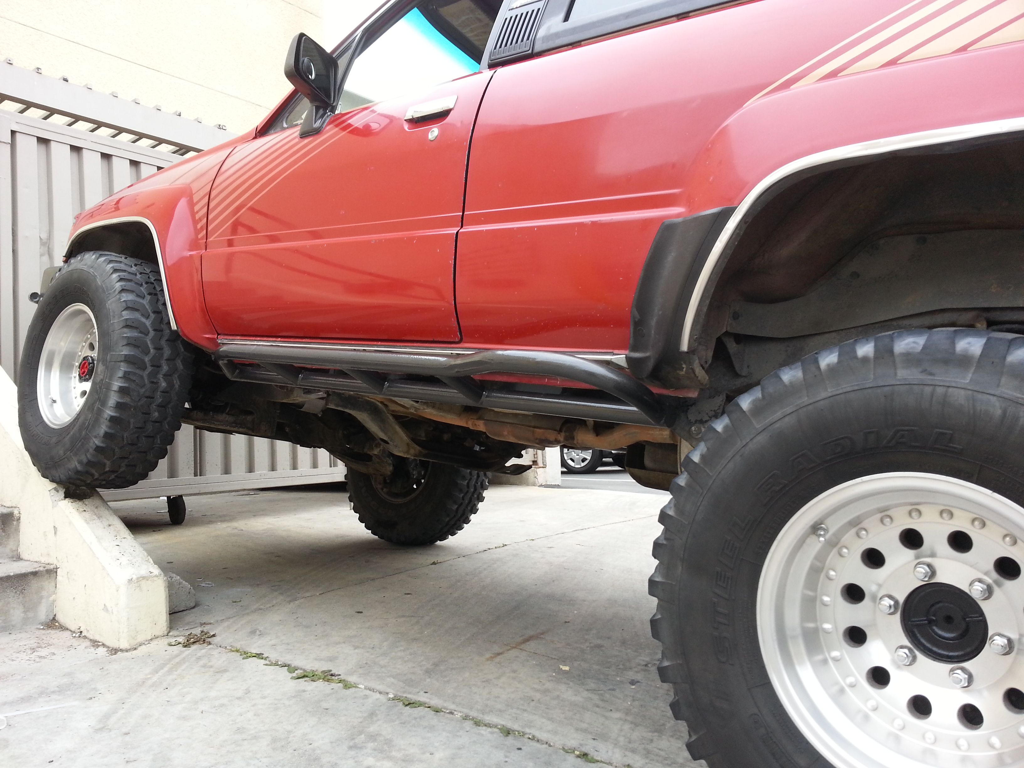

What I showed in my build, which CO- mentioned, is that even with my frame jacked up to max and the bottom shock mounting bolt removed, allowing flex beyond natural max, I still had to remove the spring using a huge prybar and wedge.... And these were 12" x 125# coils (12" being the important part). As u remove the blocks, obviously this will increase the distance between top of pack and frame/bump stop...... But that is what the zuk mod is for, right?.... Well, if its long and soft enough, and ur running normal 4" lift shocks (not shocks that are 5" travel longer, coming up into the bed to extended upper mounts)... then u should not have to worry, if done with the right springs (whichever those are), about the springs coming free from the bump tower on the frame or rubber stops....
Personally, this is why I chose to only cut the very tip of the stop towers off.... This gave them 3" more to drop......

I didnt do the torsion bar portion. I was told by the owner of Downey when I picked up the Mega Travel Bj's, that I should run BJ spacers with relaxed t-bars to get the most travel possible, up front. The OME t-bars are fatter and tighten things up a lil, and I'm not sure whether or not I could pull this off without that spacing between the a-arms......
(The last pic is with the Zuk, whole trip at Tierra Del Sol... Upper 2 pix without the Zuk/with the new leafs)....
I dont know if the fatter t-barslimit flex, but would assume they would have to? But I think Toyotech has em and seems to be happy with em....???
