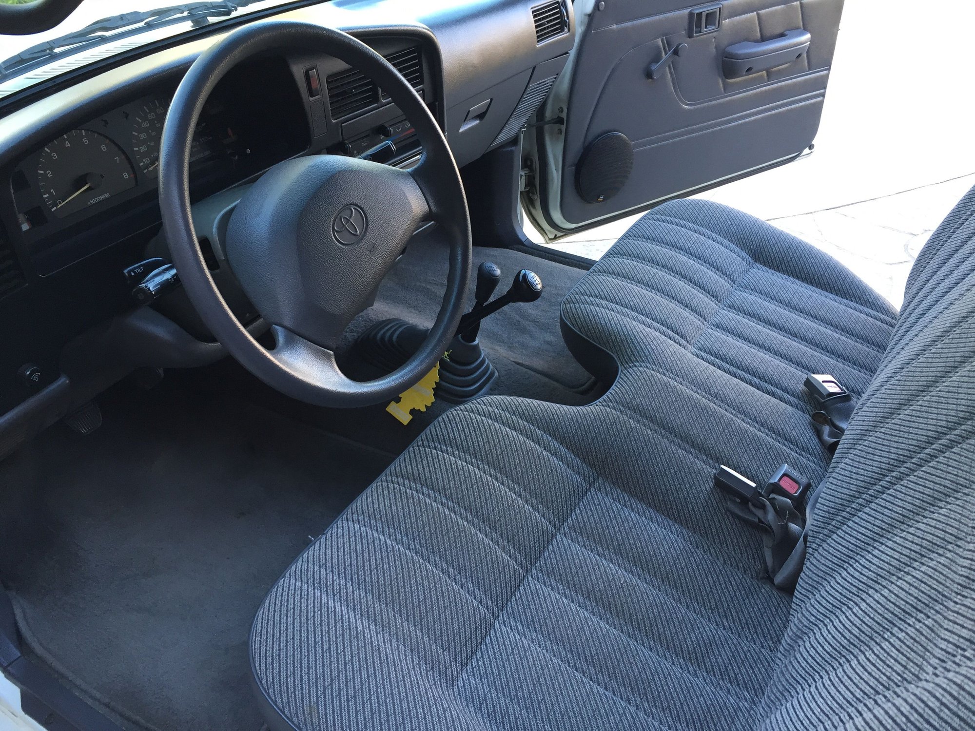

Hey everyone. I'm new to this site but have spent a lot of time on toyotanation.com try g to get a feel for my new truck. It's a 1993 dlx std cab with a leer she'll and 31x10.5x15 all terrains. I bought it from old folks who had a receipt book as thick as your wrist from brand new and it's had the dreaded head gasket done twice and timing as well. Once from a factory recall at 37,xxx miles and again at 67k. It's currently at 124,200 and "seems" to be very well in order. I live in So Cal (north San Diego) and these trucks command a premium here so I paid $3900 all in with smog and reg to my name. Any suggestions on what I should look for and do to her? I get a drop of oil every other day from somewhere in the rear of the engine and it collects at the low point of the Trans housing. Coolent is GREEN and I believe it should be red based on my 22re experience. I'd love some feedback. Thanks all.

Wow that interior looks clean

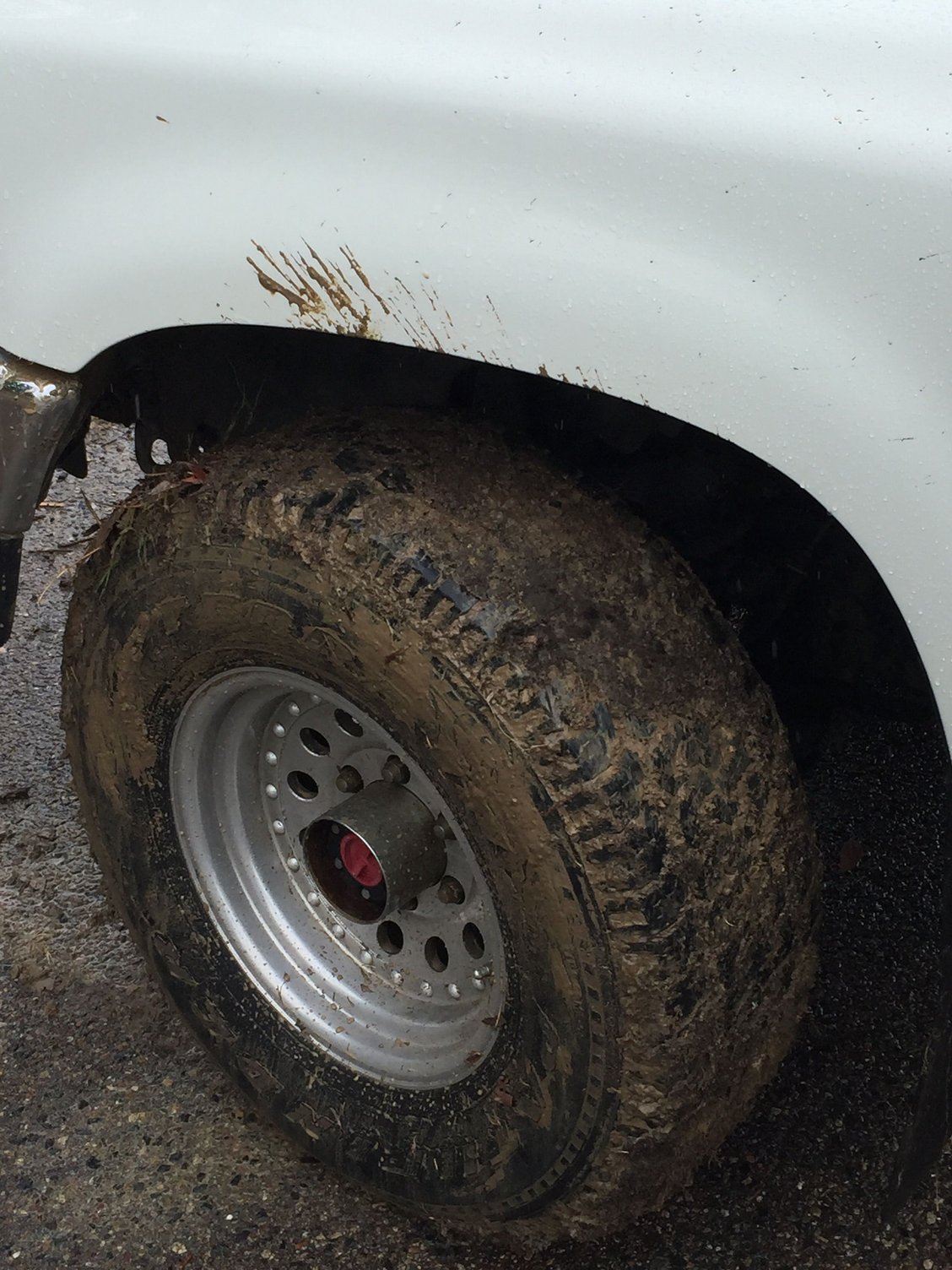

A few adds in the past few months after getting stuck in the mud with my AT's. I added some 31" Nankang mud stars and love them so far. They look really aggressive and perform well without the noise of some mud options.
