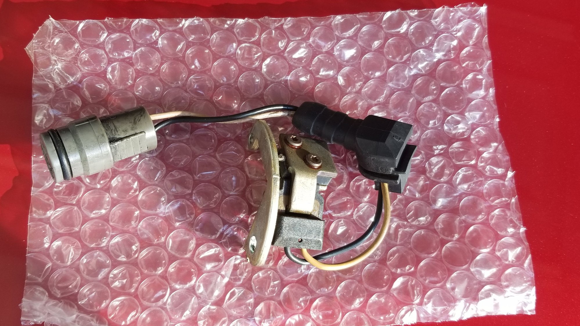

Some of you guys were really helpful. This forum was supposed to be helpful for all of us. And for some others, they didn't really want to help out one another. I'd figured I tell y'all what happened so that if some poor soul finds this thread, they know what to do:
So the truck stops working again. It turns over and crank but wouldn't start, period. The previous shop did not fix the problem. Yes well they took my money though. So, I found mobile mechanic who came by and figured out what the problem was. It was the freaking distributor pickup coil. You can get this at RockAuto.com or O'Reillys. It costs me $85 at O'Reillys.
​​OEM Part Number(s): 1925035180
After he installed a new one, everything was working fine and dandy.

I had a friend who is also a mechanic that diagnosed this problem when it first started. He said that the truck has no spark and told me to get a new ignitor and coil. So I got a new one from eBay and threw the old one away. Now this pisses me off even more because the old parts could have still been good. It's beginning to be harder and harder to get parts for the truck because this thing is becoming an antique. And to find an exact part with the same code is very difficult. Well I got lucky and found 2 ignitors with the same exact code as my 1990 pickup and so I got both of them, just to keep one laying around as a backup.

Is the Distributor Pickup Coil adjustable? According to this thread, it is adjustable on the 22re. I haven't had the opportunity to open up my Distributor to verify or check mines one with a feeler gauge.
