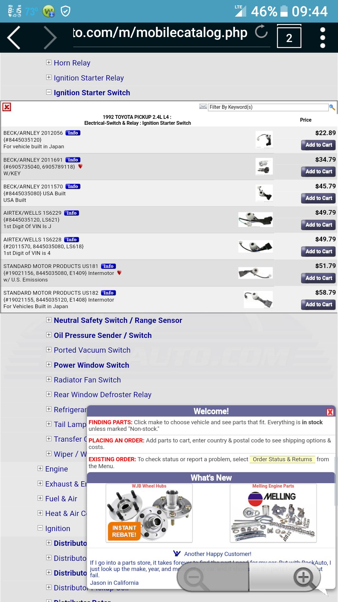

https://www.ebay.com/p/?iid=40094024...pp=true&chn=ps
http://parts.lakelandtoyota.com/show...tring=ignition

I just bought the one that closest resembled the one i broke. Also happened to be the cheapest ( maybe my problem in the first place?)

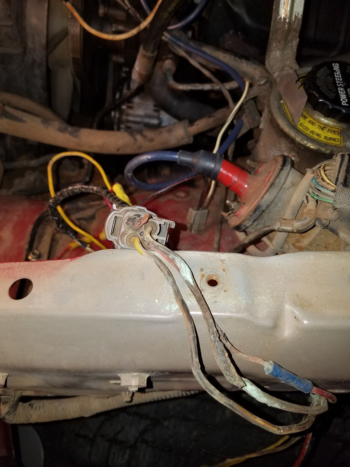

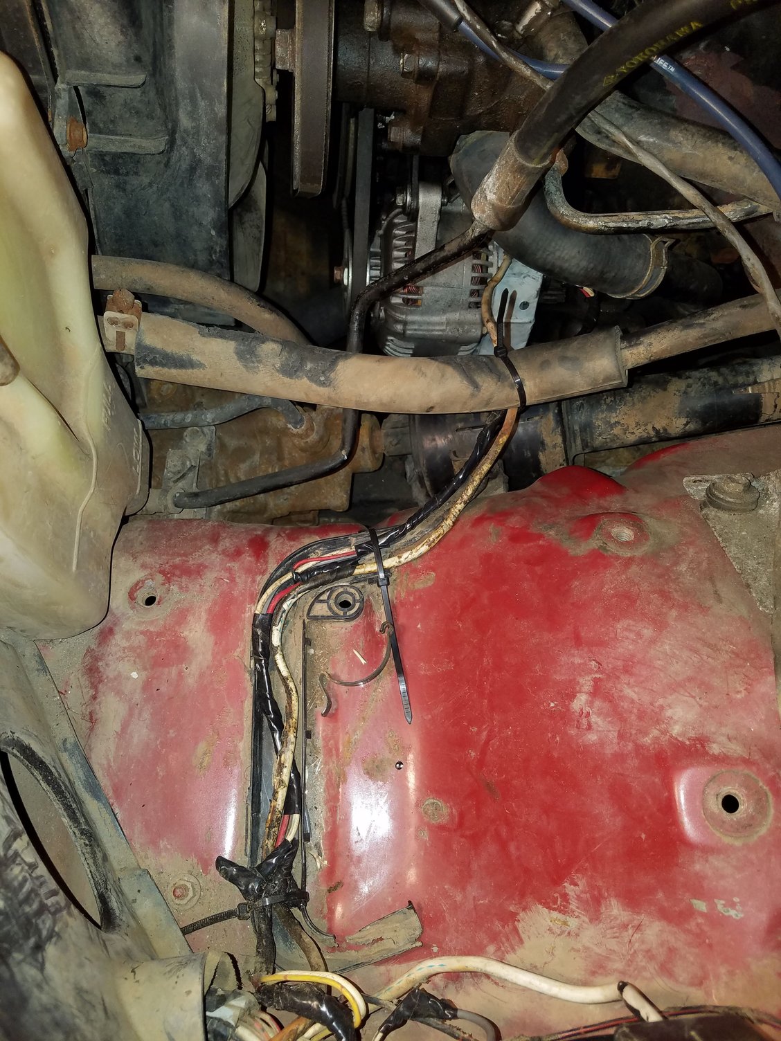

I followed the blk/ylw wire from the no.1 pin on the EFI relay. I lost sight of it where it should go into the back of the fuse junction box on the drivers side. I checked out the wiring diagram that is for a 91 Toyota (even though mine was built 12/91) and the next thing in line is the generator fuse. I could not find a fuse marked GEN. I think it is built into the Alternator. I checked all the wiring at the Alt, and it was JACKED UP... that's where the electrical fire was years ago with the previous owner. The rewiring they did was a hack job albeit not much better than I could do. I cut out all the burned out bits just to make sure that was not the problem. Once I got it all back together it still would not fire up. I then tried jumping some stuff around in the fuse junction box while the key was in "on", and I heard a relay click. I looked up at my dash indication lights, and all the lights were working. Charge warning, engine light, etc. Even with the jumper not connected! Then she fired right up, and drove fine. When I turned it back on she fired up again! I thought "well that's that I hope". I hoped too soon. This morning when I tried to start it there was nothing, just the seatbelt warning light. I touched IGN. fuse to the Wiper fuse I think, and the same click of I'm thinking either the COR or the EFI relay and she started. I don't know what could cause this. If you haven't completely lost interest in my plight I could still use some ushering. Thanks for all the help so far, I feel like I'm almost there.

My suggestion would be to find the same truck as yours in a wrecking yard and get the wiring harness. It seems like you are burning a lot of clock messing with a burnt and hacked harness.
