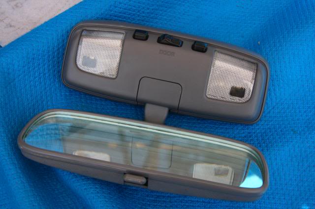

Hey there i am replacing my regular rear view with this one i picked up at the scrap yard today. anybody know how this thing is wired? it grounds to itself as demonstrated. the center switch is labeled "door" but im not sure how exactly that other wire is used. might be obvious but im tired from studying all day

I imagine that the center switch takes the place of the switch on your dome light (which is probably also labeled "door"). Unless you really hate reaching back over your shoulder to turn on the dome light, you can probably ignore that switch.
The other two switches probably turn on map lights. Are there lights on the bottom of the mirror? Those probably just need a hot wire to work.

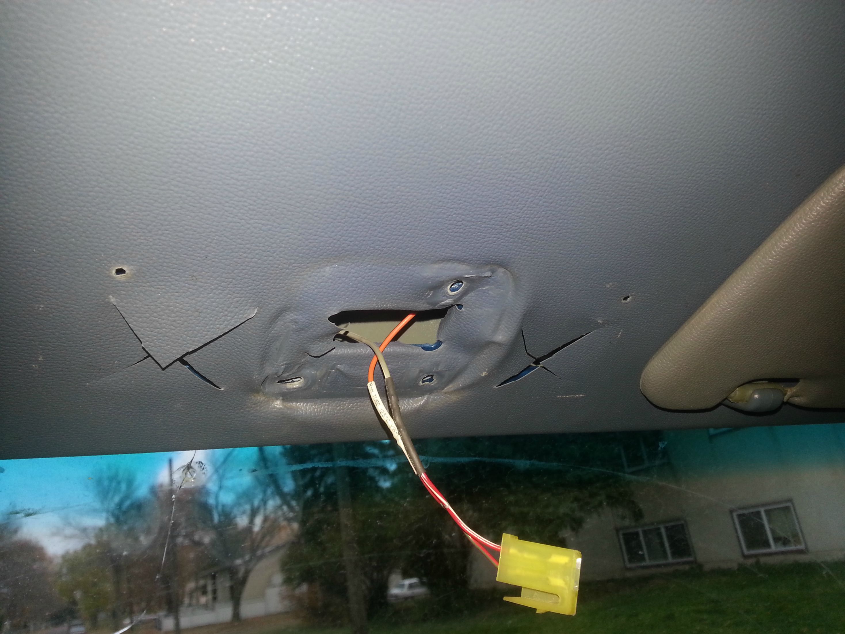

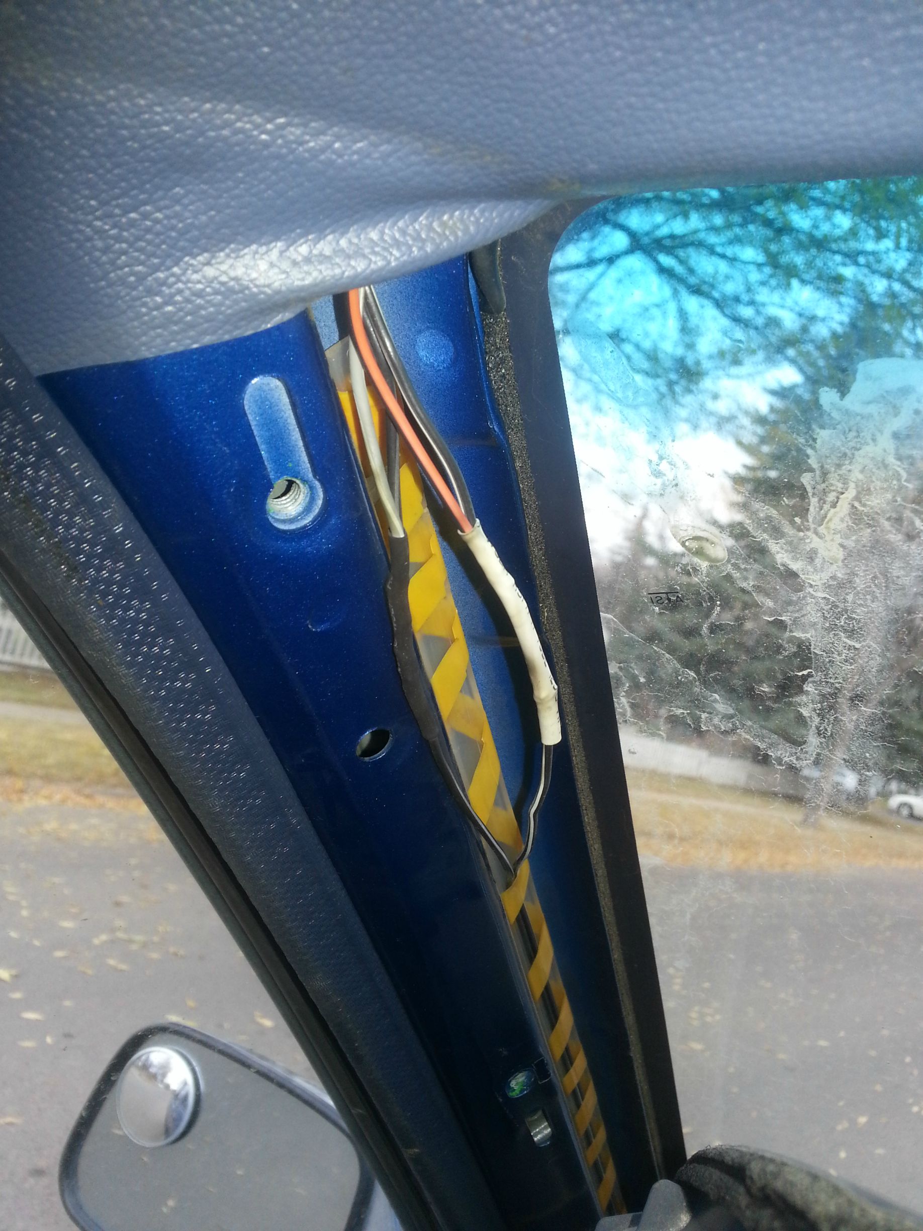

Had some time today between school and side jobs to clue this up
My truck already had the recesses, but no wiring, so i spliced into the dome power and door ground at the A pillar

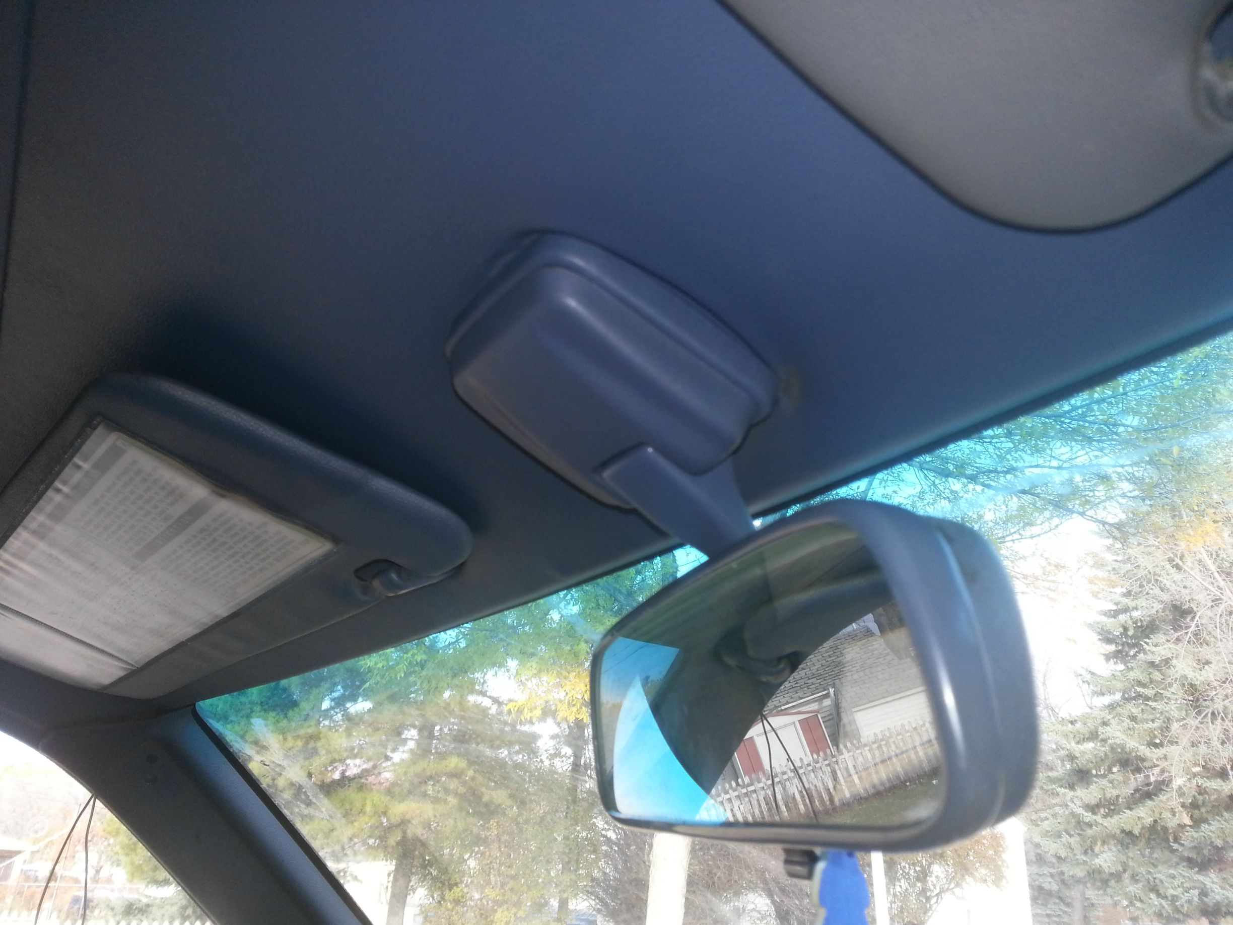

Don't mind the offcolor passenger visor. replaced that today also

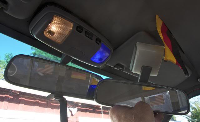

Instead of making room in the headliner to fit my junk yard mirror I fashioned a pieve of wood to take up the space....I just used the plug from old mirror/light.Name:  2013-07-05150411_zps0b6bd988.jpg
http://i561.photobucket.com/albums/s...ps2f453b12.jpg
