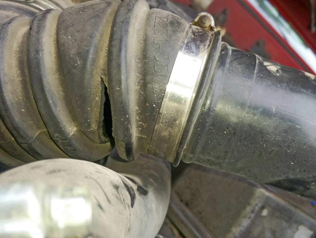

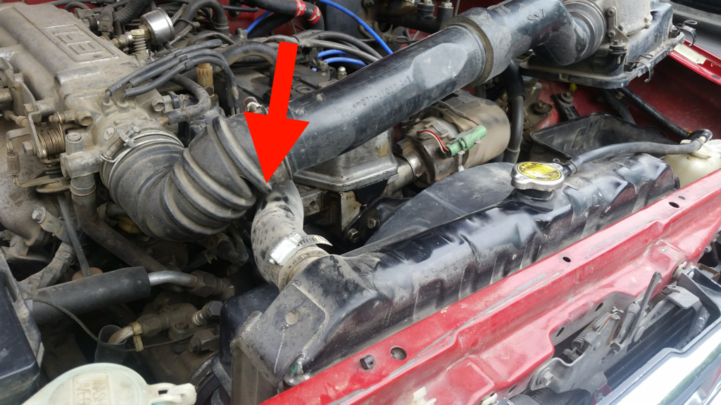

Another disadvantage of having the intake duct cross over the radiator/hose.
It's not bad when in normal position, I could not find replacement at pick a part, and the 86 will get her kicks on Route 66 tomorrow, so I sealed with two layers of 10-mil pipe cover tape.

When mine cracked I taped it as well. Ran the tape for almost a year before replacing it. I bought the Dorman part last year and it fit just like original.

one way to avoid stressing the accordian when opening the box to change/clean the filter is to loosen the hose clamp at the plenum first, then unsnap the box and lift.
Awesome! Could it be this one? Found it on Rockauto.
DORMAN 696707 {#2223135011}
http://www.rockauto.com/en/moreinfo....2158&jsn=10426
Thanks Arlindsay, and Thanks Wally for the tip.
