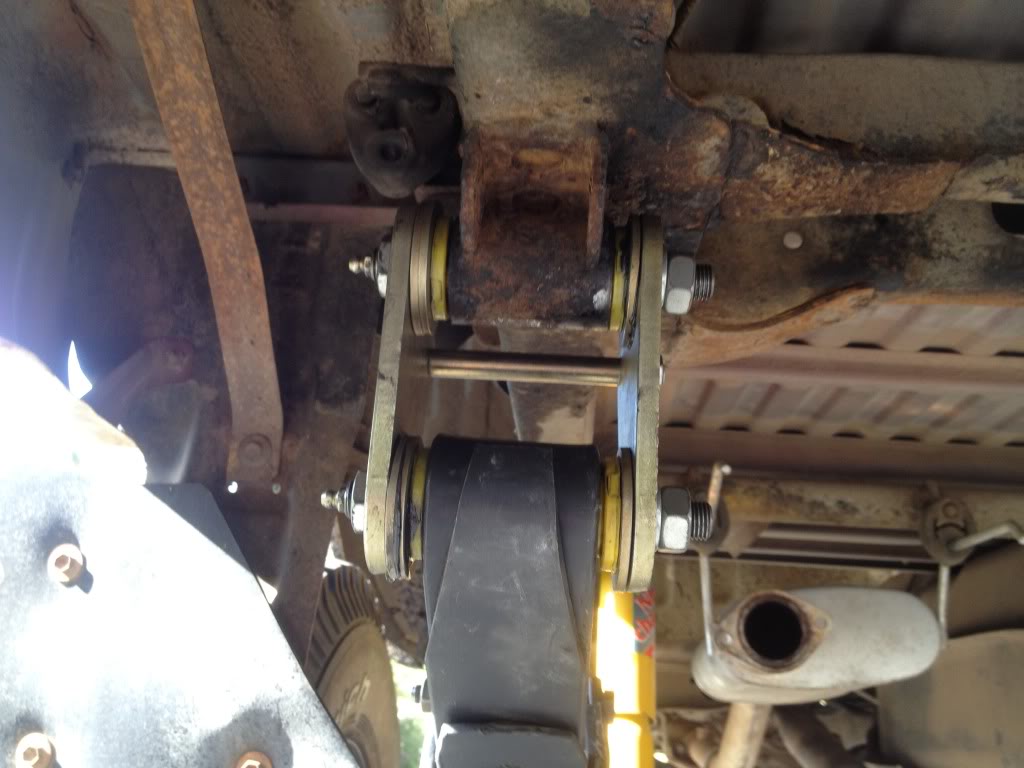

Well here's the temporary fix. It should work until I get new shackles and I must say I've had quite the revelation today.
I'm not entirely sure as to why I didn't catch this earlier, but the shackle I have right now is the OMEGS1 NOT the OMEGS3. I talked to ARB and it turns out that the GS3 is actually the correct shackle.
I could have sworn I purchased the GS3, but my invoice from SierraExpeditions says otherwise.
Man I feel dumb haha.

idk. i dont see why you cant just run it like that

looks good!
you should technically be ok running the shackles this way. what length of shackle are those anyways? shackle length will have a lot to do with how tall it's sitting, and you may find need to swap them later once the leafs have finally settled.

I tend to agree that you should be fine running this way. You can barely even tell that there are washers in place. My main concern was the bushing getting shredded and your fix looks like it'll do the trick to keep them in place. Personally, I wouldn't worry about getting the "right" ones. Especially for the price.

Keep the ones you installed, btw your truck looks good.

The shackles are essentially the same length as stock. Maybe an 1/8" longer. I think I'm going to keep everything shock mount related the same for a while.
