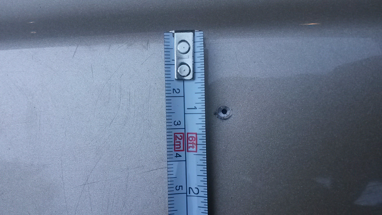

After 15 minutes it was in a location I was happy with. So I took out my awl (pointy nail on a handle like tool) and punched the roof to make indents for the drill bit so it wouldn't skip out.

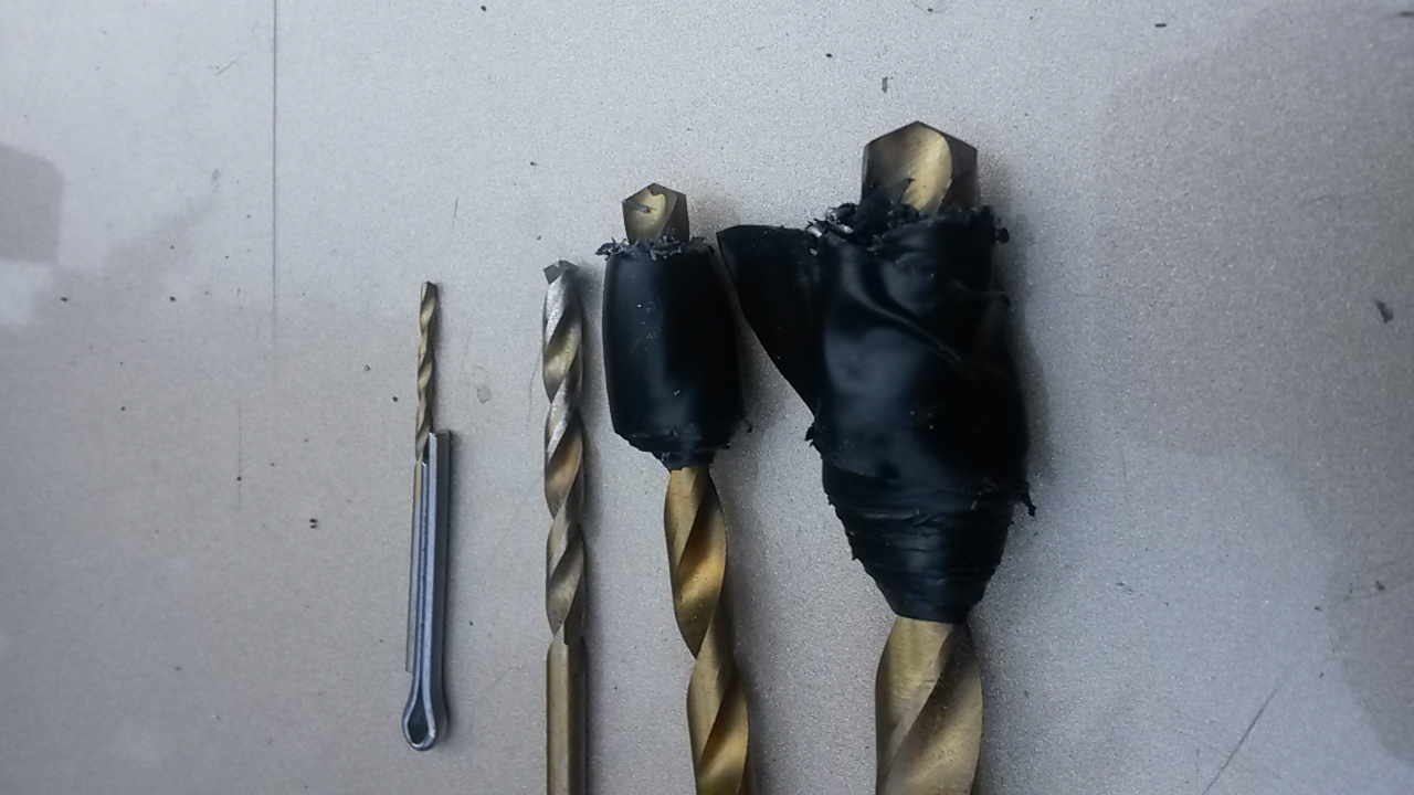

Once the holes were punched and I was happy with how it sat came the most terrifying part, drilling the first hole. The first holes I drilled were tiny (1/16th) and acted as pilot holes. Lucky for me the drill bit was short enough that almost the whole bit fit into the drill so no guide or stopper needed to stop the bit from punching the liner. I did a few scratch the paint once the bit did punch through the metal from the drill itself (not a concern as once the correct size hole is punched that bit of scratched metal will be gone)
I actually drilled each hole a total of four times increasing in bit size, maybe over kill but I didn’t want the bit to jump all over the place on me.
Once I had my first four guide holes drilled I increased the bit size until the final size needed for the nut inserts. As you can see from pictures I used electrical tape on the bit to make sure it didn’t go through my headliner.

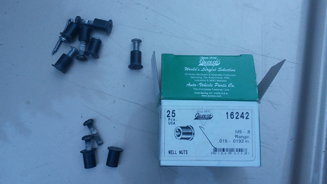

Once all 8 holes were drilled I used a sealant on the rubber nut inserts to make sure the install didn’t leak. One major issue I had was the rubber nut inserts were spinning and I couldn’t get them to stop. After an adult beverage I had my eureka moment and went back to it. Being that the rubber nut inserts had a gasket on the top I decided moved to my impact drill and simply applied pressure to the rails as I was putting the screw in. sure enough the pressure held the rubber nut and stopped it from twisting enough that the impactor was able to suck the nut up and grip onto it.
After a few head scratch moments I was finally able to get all eight screws in place with sealant around them. Big test comes when it rains next I guess.

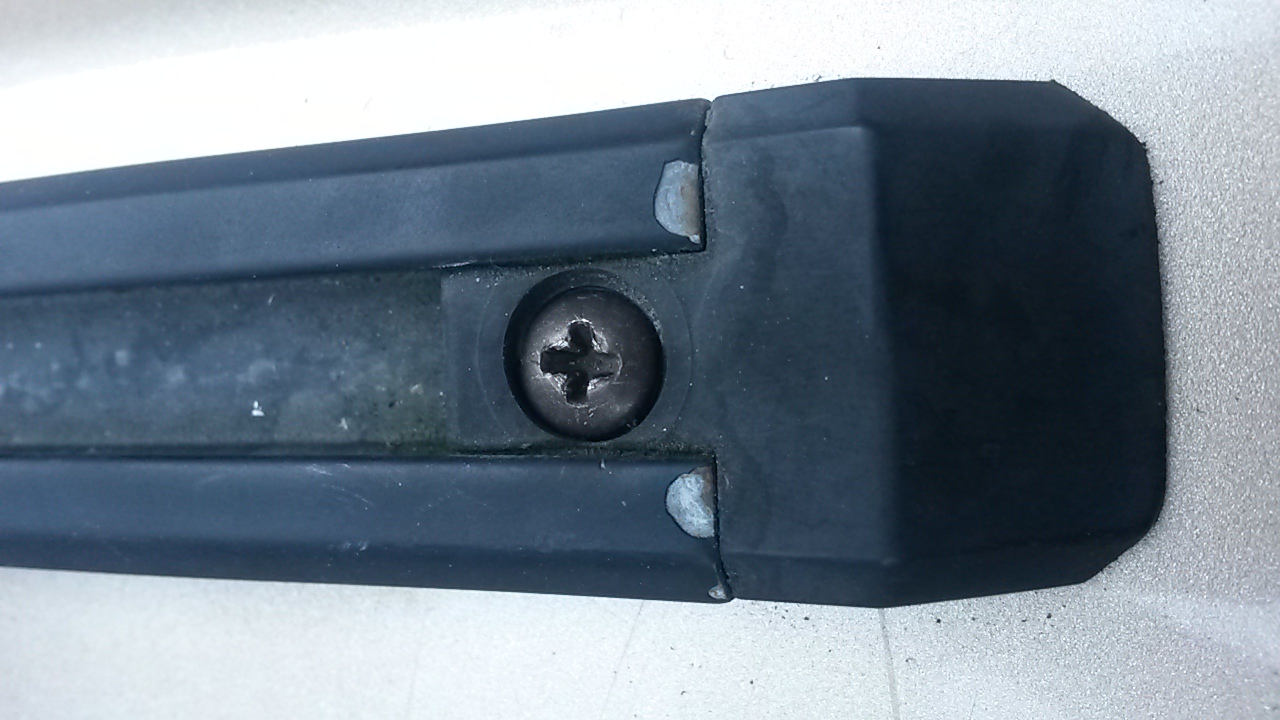

Important to make sure you place the correct screw in the ends/ middle. the screws i got that came with the rack had 4 long and 4 short.
long ones go at the end and short in the middle.
Awl punch doesn't need to go through the roof just make a dent so it doesn't skip out.
Finished product

I do remember there were longer ones on the end than in the middle, and that it was a PAIN IN THE ASS to find the expanding rubber nuts.
I would go to the local auto store and explain your situation. maybe they have the rubber nuts in a limited sizes. making it easier to start with the nuts then go to the screws as the nuts are harder to source (they literally went through a box of random nuts and bolts and found the exact product i needed at the bottom of the box)

found some rubber well nuts on ebay. http://www.ebay.com/itm/like/121174820335?lpid=82&chn=ps in case someone is looking.
