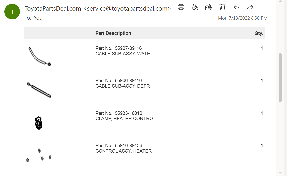

Part numbers please..

The 1st cable is the blue heater valve cable. My OEM was seized and could not free it up. Bought the 2nd cable (55906-89110) just is case. It wasn't needed and it was shorter, so did not use it where ever it was suppose to go. The new assembly connects the heater valve blue cable to frame different than my 86 OEM unit. The cable slides through an hole in the framework and attaches to that new post on the lever. The clip holds the blue cable and is unique to this new assembly. I lucked out ordering it as it was needed.
Cost are in order: $11.23, $10.32, $1.65, $78.83.
Other dealer sites have these items and prices are competitive. Surprised it took 5 days from order to delivery (Atlanta to Norfolk).
