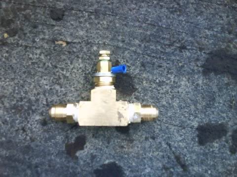

installed it using one pillar from http://www.truckpillars.com/index.html and autometer gauges from jegs.
i decided to put the sender before the radiator and the additional cooler in the rubber line. so i made this out of brass fittings. notive the grounding wire placed underneath the neck of the sender.
