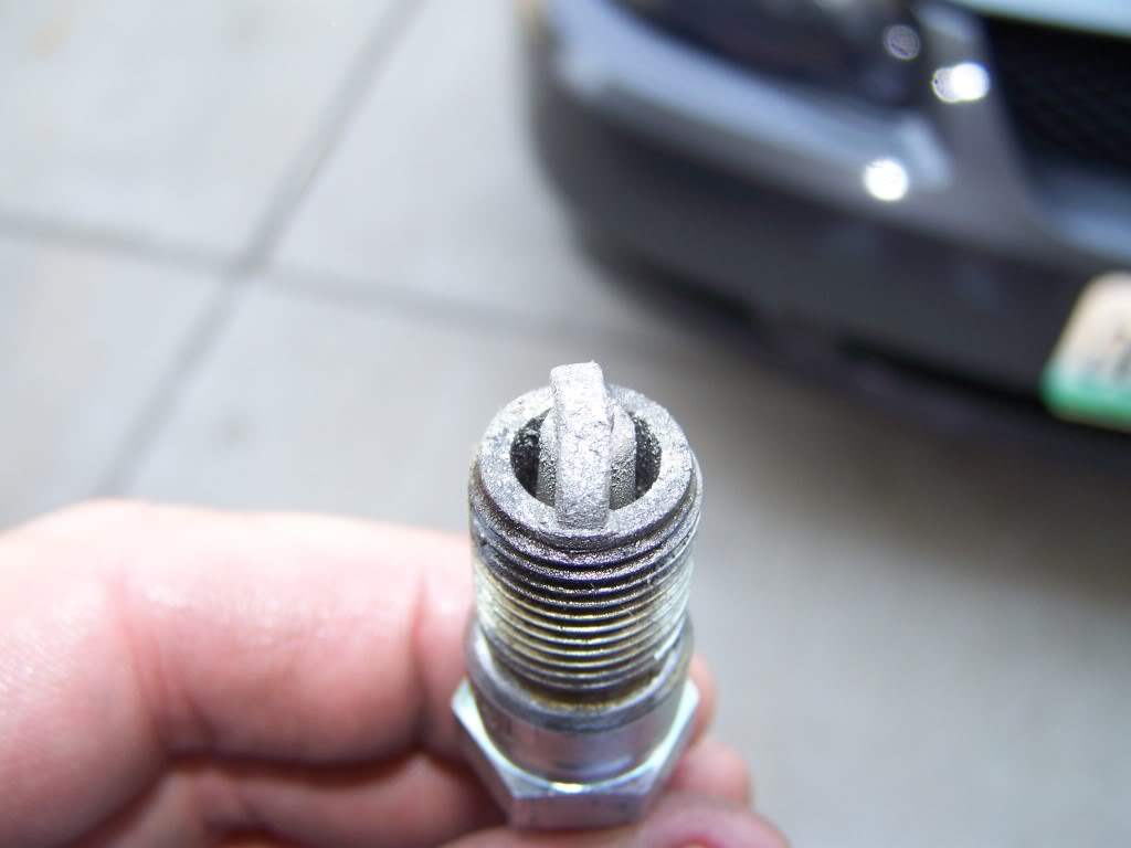

Working on a video or sound clip... In the mean time here are a couple of photos. First is the gas puddle stains where the fuel was dumping out of my leaking exhaust system. The second is the spark plug I pulled from the #1 cylinder.

ouch...

ouch indeed. looks like something collided in that cylinder.

wow! looks like something really smacked that plug hard.

I have a picture of a plug that looks just like that from my 2004 Mach1 I used to have. I leaned it out and burned the ring lands off 3 pistons. It was heat that did mine like that. Coated it with light layer of molten aluminum.
