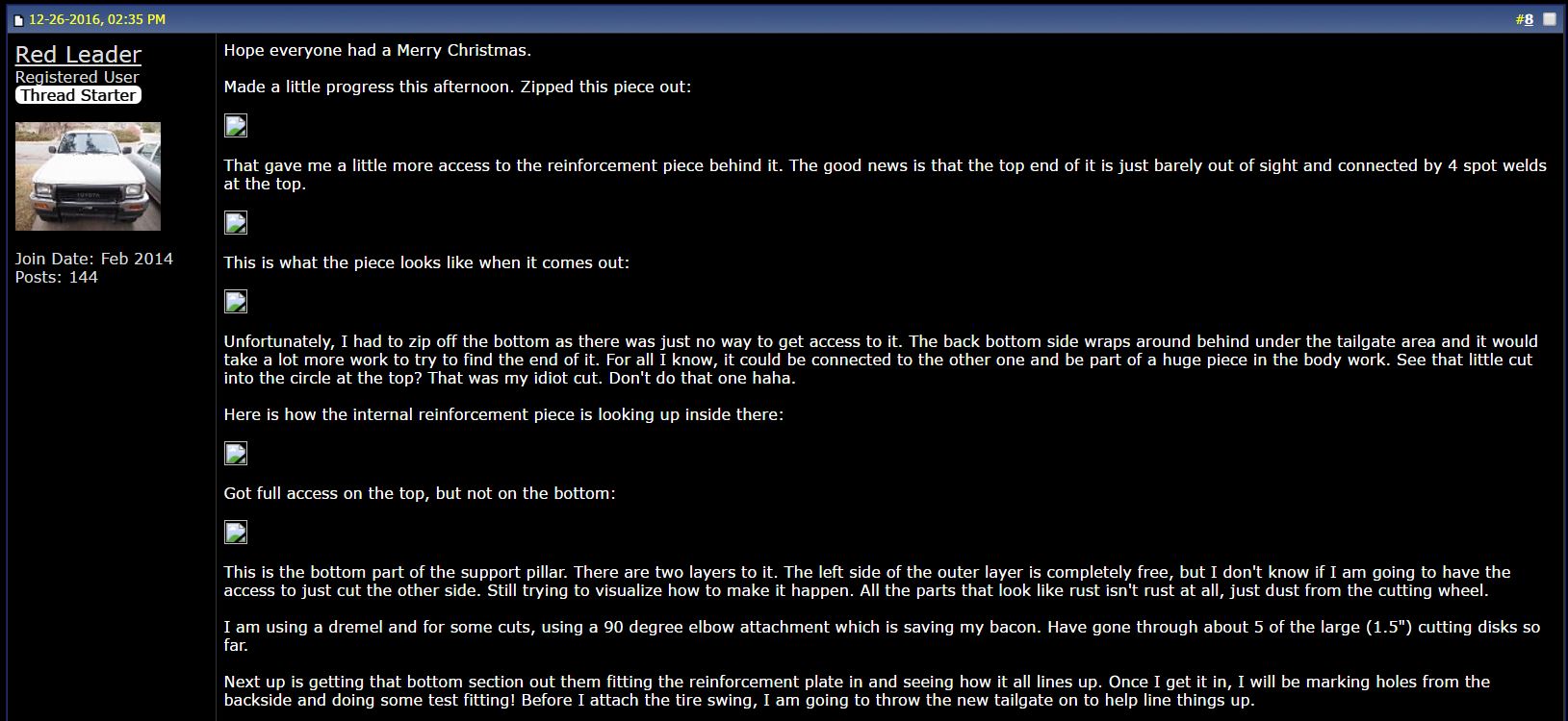

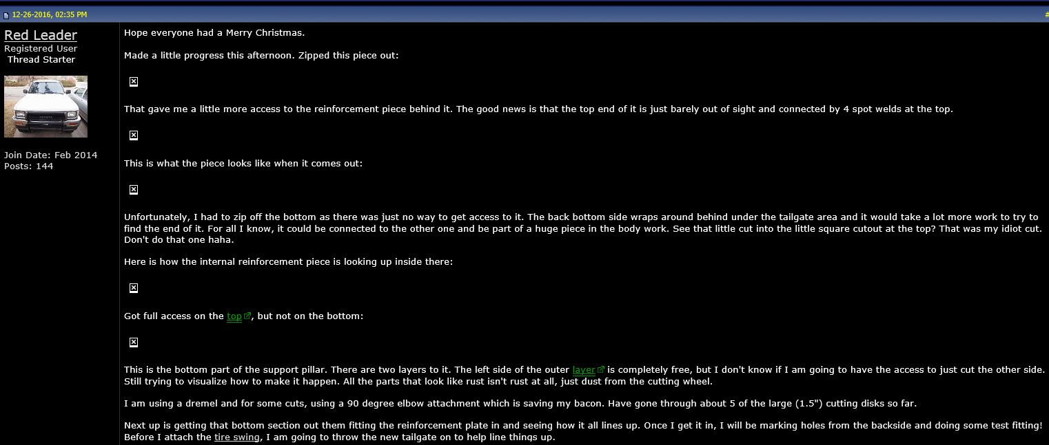

Hope everyone had a Merry Christmas.
Made a little progress this afternoon. Zipped this piece out:
That gave me a little more access to the reinforcement piece behind it. The good news is that the top end of it is just barely out of sight and connected by 4 spot welds at the top.
This is what the piece looks like when it comes out:
Unfortunately, I had to zip off the bottom as there was just no way to get access to it. The back bottom side wraps around behind under the tailgate area and it would take a lot more work to try to find the end of it. For all I know, it could be connected to the other one and be part of a huge piece in the body work. See that little cut into the little square cutout at the top? That was my idiot cut. Don't do that one haha.
Here is how the internal reinforcement piece is looking up inside there:
Got full access on the top, but not on the bottom:
This is the bottom part of the support pillar. There are two layers to it. The left side of the outer layer is completely free, but I don't know if I am going to have the access to just cut the other side. Still trying to visualize how to make it happen. All the parts that look like rust isn't rust at all, just dust from the cutting wheel.
I am using a dremel and for some cuts, using a 90 degree elbow attachment which is saving my bacon. Have gone through about 5 of the large (1.5") cutting disks so far.
Next up is getting that bottom section out them fitting the reinforcement plate in and seeing how it all lines up. Once I get it in, I will be marking holes from the backside and doing some test fitting! Before I attach the tire swing, I am going to throw the new tailgate on to help line things up.

Originally Posted by Red Leader
Wait, so are you saying the pictures are not showing up? If not, I'll take a look see at what the issue is.
Thanks!
Also, just a test but does this one show up?
wierd, not seeing them.
here are screen caps of what I am getting
1) using internet explorer
2) with chrome
curious to you how your's come out since I didn't have the inside peice, i bent some flat stock to fit the inside.
I just missed out getting the rear tire mount tailgate on craigslist. I also used flat stock on the inside of the tail gate with i did my rear swing out
Attached Thumbnails I'm retrofitting a factory tire swing onto my 4runner over Xmas break...follow along!-capture-ie.jpg   I'm retrofitting a factory tire swing onto my 4runner over Xmas break...follow along!-capture-chrome.jpg
