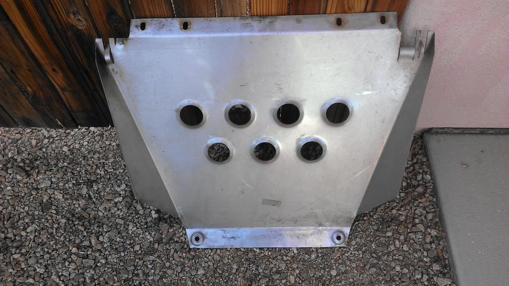

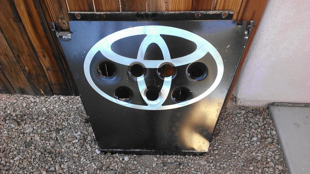

im selling one that is for 4" lift...
give me some measurements and i can make sure it will fit your lift.

stock skid is garbage. i only run one because it's better than nothing. on my last truck i bent it by looking at it wrong, haha. your only option is to either get an aftermarket one, have one made for you, or modify bracketry to compensate for the lift. IIRC, there was a thread on this last month and the person contacted BudBuilt, who told him he no longer makes the skid for bracket lifts despite what the website says.
