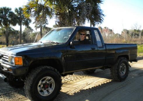

I know the weekends over but I got a black extended cab. Let me see if i can scrounge up a pic. Thats it minus the boggers. I got black steelies and mud terrains now.

looks just like that, 'cept there's a sticker on the front window that says "BINGO", and there's some other stickers on the back window (a Browning one, and some others), and there's no front bumper like that on it
but man that's close; I had to look at the pic twice! lol
