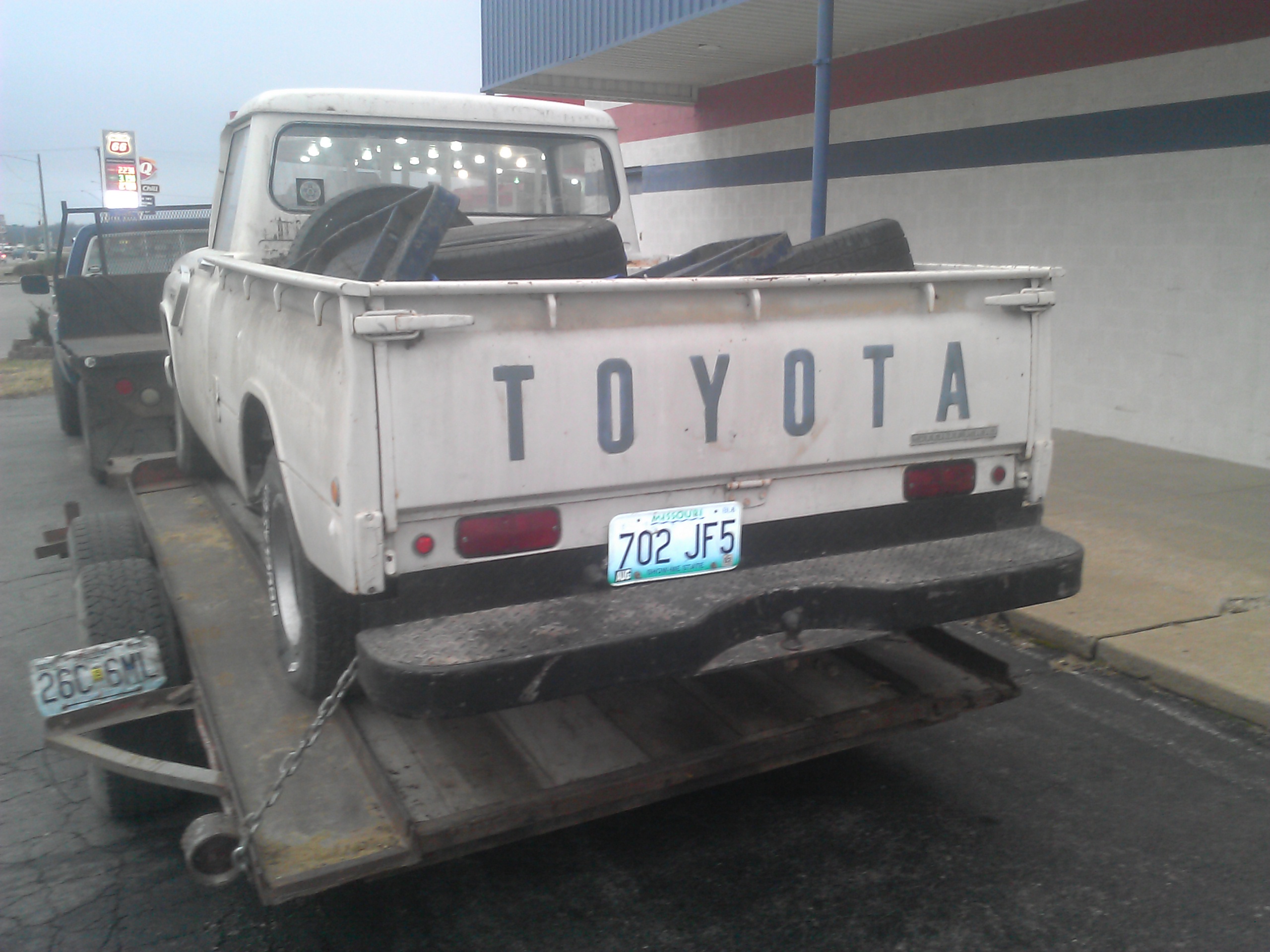

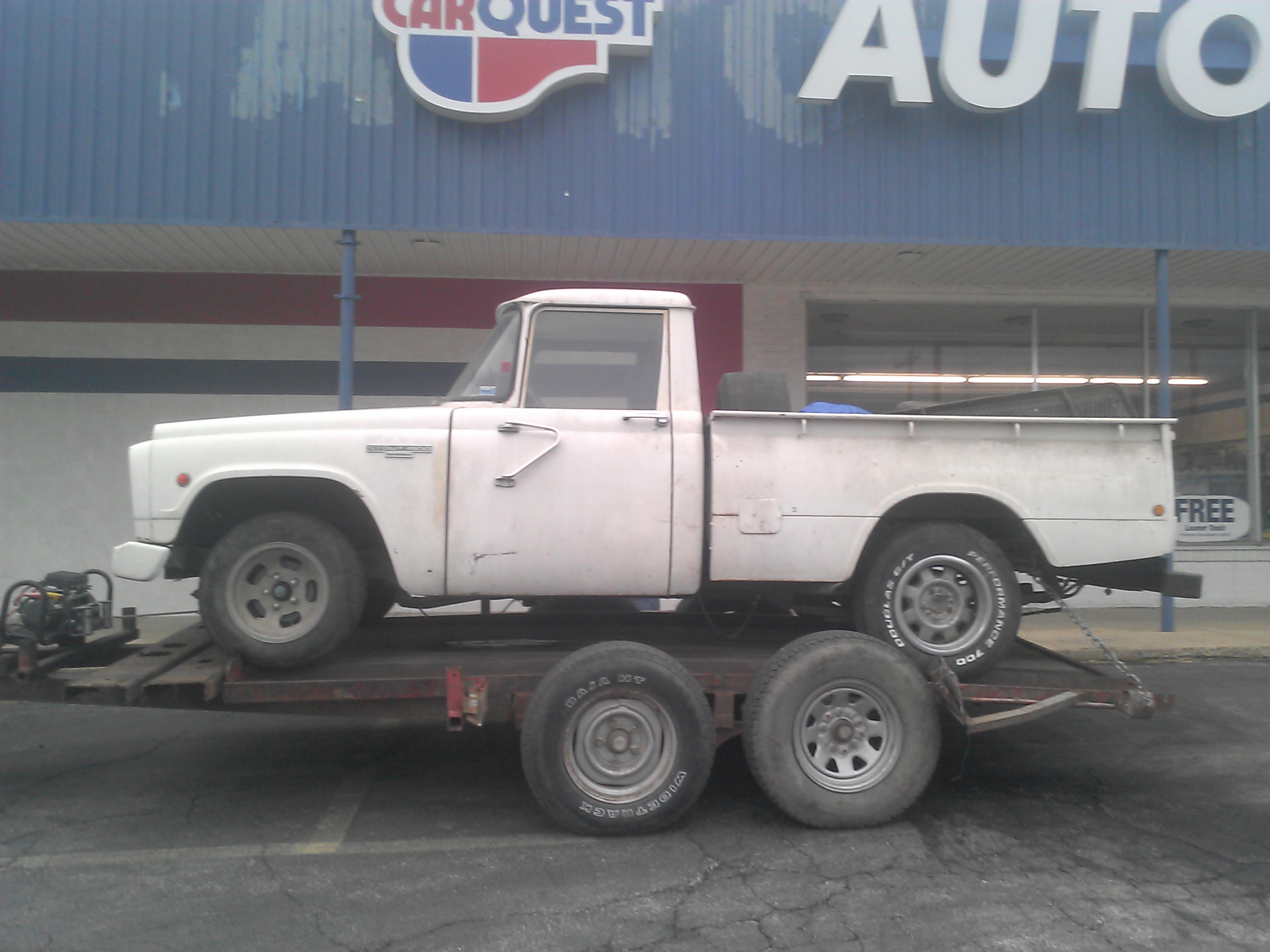

Here's the pictures Just got it home today
Attached Thumbnails IFS brake upgrade-1213141559b.jpg   IFS brake upgrade-1213141559a.jpg   IFS brake upgrade-1213141600.jpg
