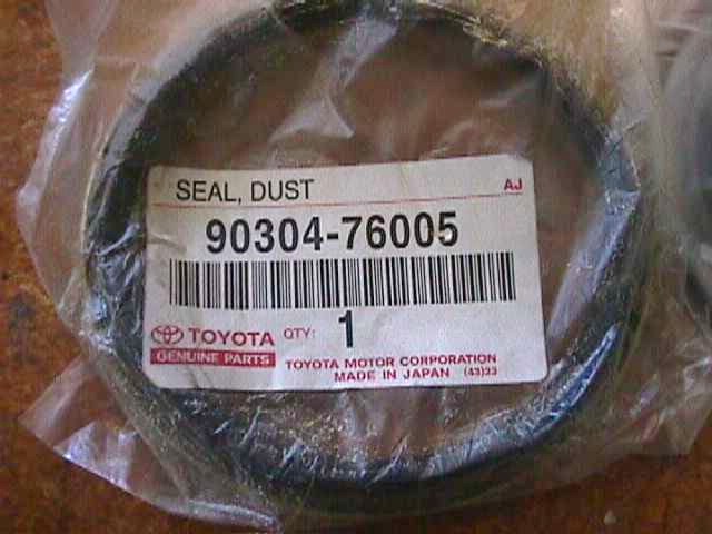

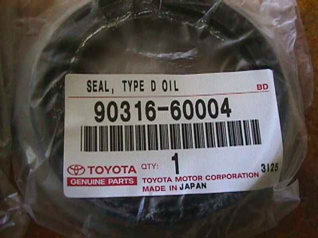

As far as I know, there are four different seals on an IRS side.
#1- the conventional seal that is in the hub right behind the inner bearing.
C/R # 25968
#2- a 'dust seal' that is bolted to the spindle and knuckle with several bolts.
I don't know what Toyota calls this seal, but I know that they costa plenty.
#3 and #4 are seals that interface with each other where the drive axle meets the inside face of the steering knuckle. One goes onto the knuckle and the other one goes onto the half shaft.
Apparrently, the later IRS uses a slightly different design of these last two seals than the early IRS did. I have heard that either type will work on any IRS truck, but that they must be used in correct pairing. New+new or old+old type. I think that relative seal thickness differences make it difficult or impossible to set the snap ring at the outside of the spindle otherwise.
Here are images of the pair of inside seals I recently got.
These are the 'new' type.
