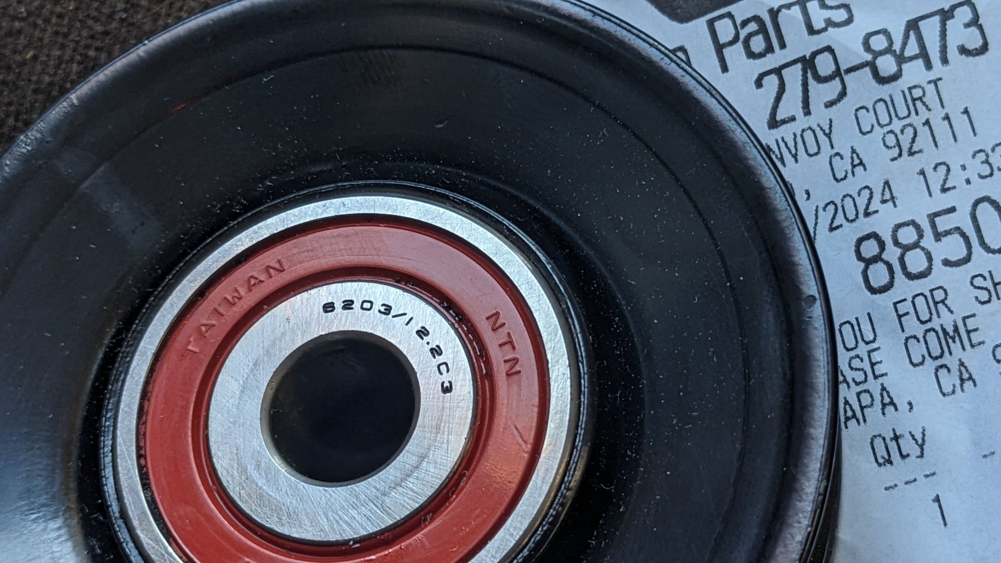

DO NOT USE THE PN 38036 from NAPA EITHER
DO NOT USE THE PN 38036 from NAPA, EITHER. It uses 6203 bearing. Inner diameter is smaller than 6204.
Tnx! Always happy to help fellow Yota owners.
Only DO NOT USE THE PN 38036 ($23 FROM O'REILLY)

I'm gonna go Nachi 6204 or Tim Ken 6204.
