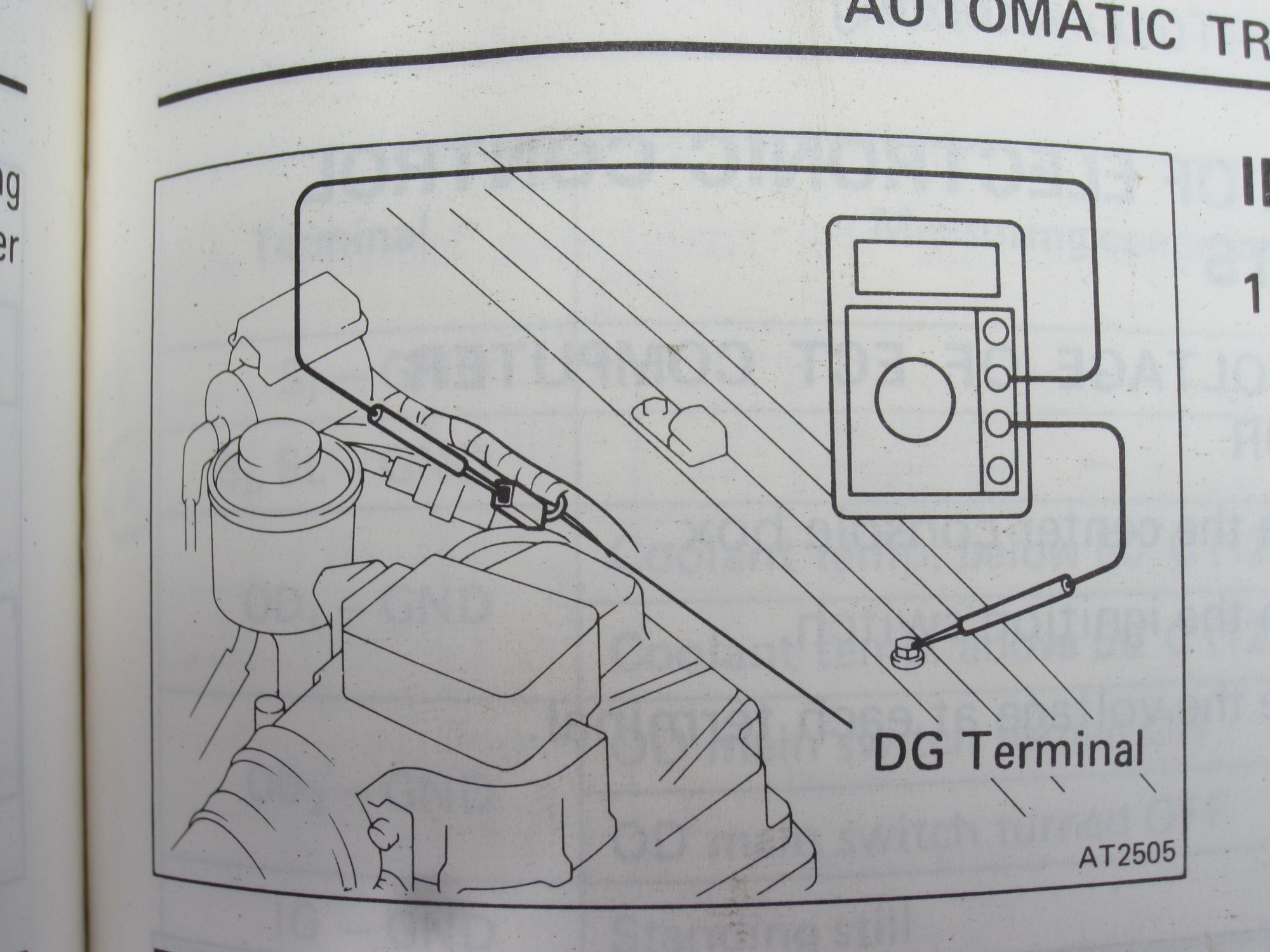

Page 9 of this document http://www.autoshop101.com/forms/h17.pdf says to check voltage reading between ECT and E1 on the Diagnostic Connector. I turned the ignition to ON and inserted the probes, but no reading. The meter reads voltage off the battery so the meter is working. I looked at the ECT and E1 ports and the E1 port is greased and seems to have a pin/connector, but the ECT port is bone dry and looks empty with no pin/connector. The sticker on the lid has the ECT identified, but could it be that there is not an ECT pin/connector in my setup? If there is not one, any ideas on how else I could run this test?
(87 4Runner, 22RE-T, A340H) ECT connector circled in red. I don't see a pin or connector in there ...

1987 seemed to be the model year where Toyota was transitioning from multiple diagnostic connectors and integrating them into a single diagnostic port.
My 1987 Toyota Truck & 4Runner Repair Manual (FSM) shows that your 4Runner may have the older DG terminal, even though you have the newer style diagnostic port:
Better picture of DG Terminal location:

Thanks for the link, scope103.
old87yota - That looks to be my setup because I have that DG Terminal on my 87. Thanks for the help.
