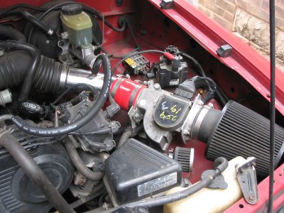

Here's my intake in what I hope is its final iteration.

Just a question - nice intake? What kinda difference did it make?

Hey, thanks. BIG difference. Sounds really agressive when you get on it too. The combo intake/exhaust gives it killer throttle response.
The exhaust IS a Borla -- stainless, mandrel-bent, 2 1/4 with the Borla tip. I don't have the P/N handy, but I bought it in 2001. It was for all pickups, so the only mod was to cut down the mid-pipe to match the wheelbase. Then I bolted it all together and that was it. Makes lots of low-rpm torque, but I still feel the 3.0 could use 2 1/2 to wake up the top end. Now I want headers! It's addictive.

What I think might help the top end a little is instead of considering headers, replace the pipe that goes from your exhaust manifold to your cat (which from my understanding is 1 7/8" and pressure bent), with a 2" or 2 1/8" mandrel bent pipe. I bet that'll provide a big difference. But at the same time you gotta be careful....what you gain up high you'll probably lose down low. I like the 1750-3200 RPM power band. If my truck takes off at those RPM's I'll be extremely happy.

Yeah, unfortunately, I did. Were you the one who needed a breather? And to answer Coed's question, that's where I bought the Borla.
I shoulda mentioned that the mid pipe was extra long with an O2 bung for those who've nixed their converter. Since I have mine, the pipe needed to be cut.
I've thought of a bigger down pipe -- and the price would be right. But still, I've been told the headers are worth the effort. And all that good stuff like a ported intake, etc., when the time comes.

did you fabricate the element-to-vafm adapter? Or did you buy it?
I bought it -- it's from Vibrant Performance. Any speed shop has them, as long as it sells import performance parts.
