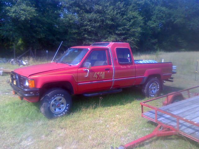

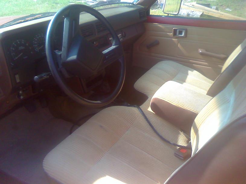

I am now a proud owner of a 1986 Custom Cab. It has extremely low miles but the engine block is missing due to it "throwing a rod." I have the turbo unit and everything to reassemble it just no block. I have never had a turbo, and don't know much about them in Toyotas.
Is there any difference in the standard 1985 and up 22r block and a turbo 22r?
I do not plan on doing much if any modifications to the truck, just looking for a dependable truck.
Any advice would be great!
Thanks
Attached Thumbnails I need some advice on an '86 custom cab-toyota.jpg   I need some advice on an '86 custom cab-toyota-2.jpg

well if you want any kind of power in that thing WITHOUT the turbo..then you need atleast 22RE pistons...not the 22RE-T pistons because they have a lower compression thus resulting in less horsepower..
and you cant just use any 22RE block to work with the turbo..it HAS to be a turbo block..or what Toyota calls the "Lazer Block"..its basically the same but on the driverside of the block there is a cut out for oil for the turbo..without that i believe it would be quite a task making the turbo work right..lol
if it were me i would find a good used Lazer block..(with pistons and crank and all that)..i believe it would be easier..and then you wouldnt have to deal with the big A$$ hassle of changing wiring harnesses, ECU's..and all that other junk..
and since you dont know much about turbo's...you would DEFINATELY want to get a Lazer Block if you keep the turbo..that way you dont have to figure out how to adequily(spelling??) oil the turbo..
oh yea POST SOME DANG'D 'OL PICS OF THAT BEAST!!!!!!!
i LOVE the custom cabs!!!!!
*EDIT* just seen the pics..lol..that thing is in AMAZING CONDITION!!!!!!!!!!!!!
theres an '
84 custom cab with the 22r and 5spd about 30 miles from my town..its sittin on 36's too..lmao
