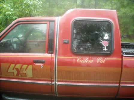

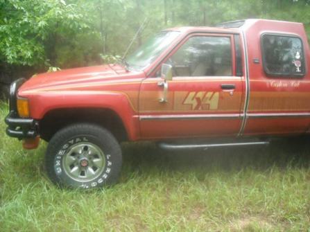

some pics
Old Sep 19, 2009 | 07:15 PM
  #33
SC-TOYOTA-FAN's Avatar
Joined: Feb 2007
Posts: 38
From: South Carolina
It took me a while but here are some more pics.....
Attached Thumbnails I need some advice on an '86 custom cab-gregs-camera-069.jpg   I need some advice on an '86 custom cab-gregs-camera-074.jpg
