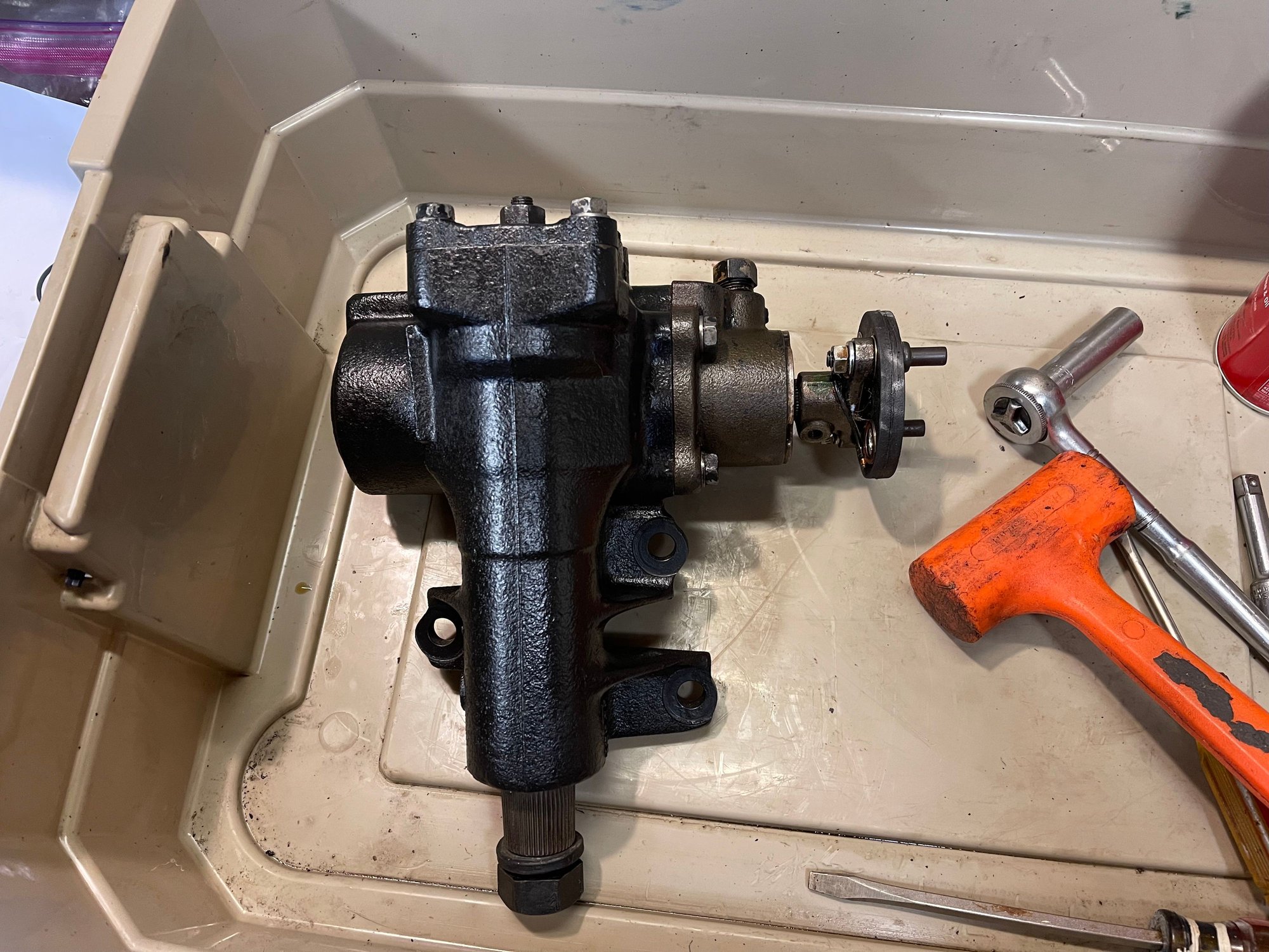

I just rebuilt my steering box and you can too
It was not difficult and really fun. I had watched some videos previously and found them a bit confusing. The service manual has more complete instructions than i will list here. In my case, i did not disassemble any further than necessary to reseal and adjust it. The problem I aimed to address was a very loose feeling on center. I remember driving my Dad’s ‘86 4wd extra cab brand new and loved the steering feel so i was trying to achieve that feeling. All other moving parts including the rag joint on my truck have been replaced during the last 20k miles. I had swapped the steering box for another one and that one has been leaking so i decided to rebuild the original and swap it back in.
Old Aug 22, 2021 | 05:52 PM
Melrose 4r's Avatar
5 Year Member
Joined: Jun 2017
Posts: 2,436
Likes: 965
From: 02176

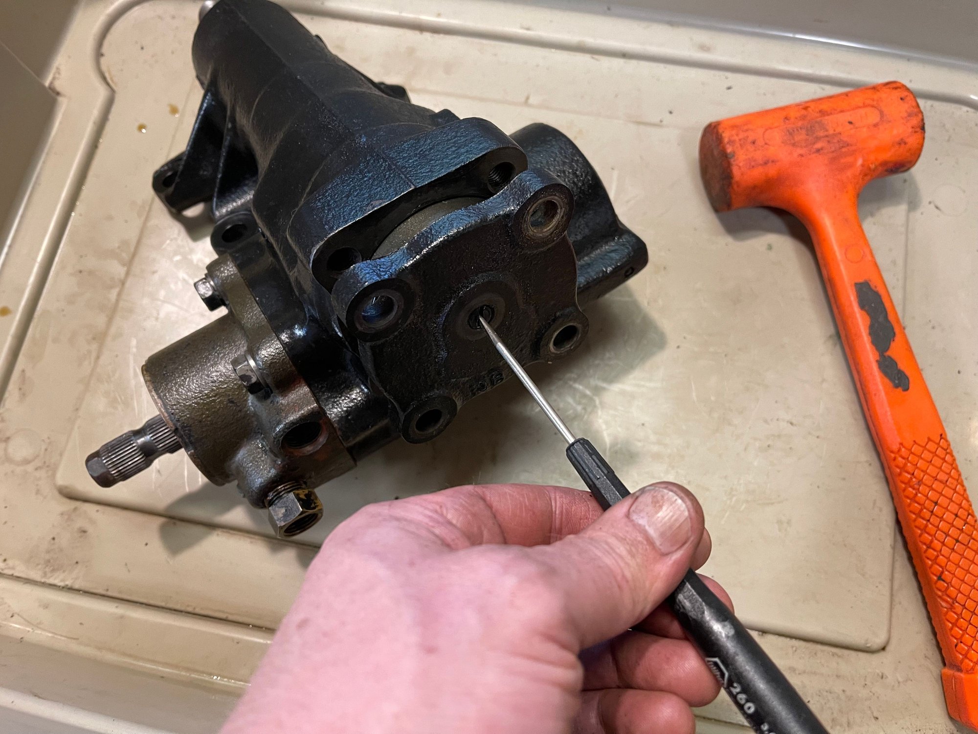

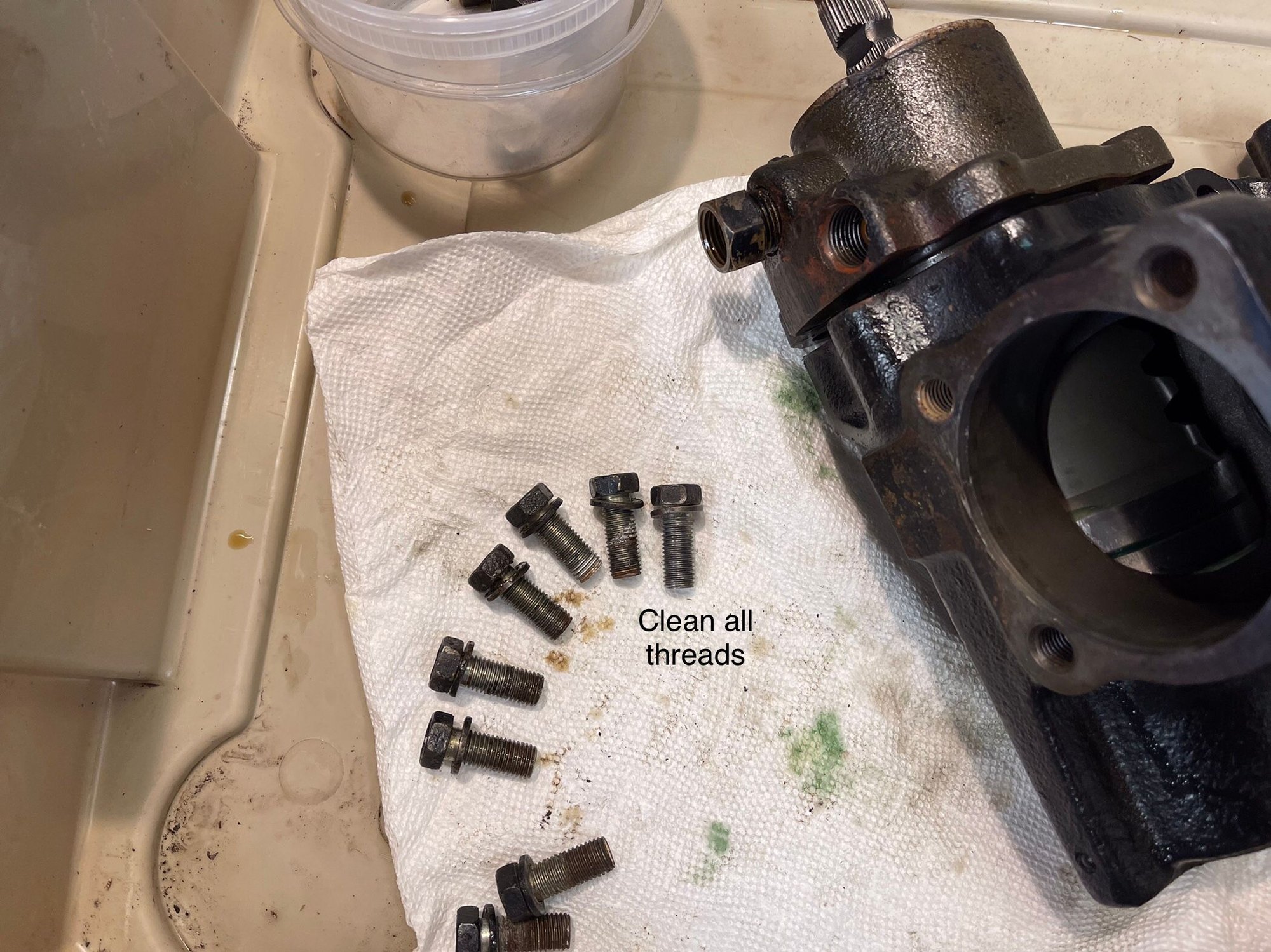

Working in a clean, shallow tub helps control the mess and parts. No special tools other than a pair of snap ring pliers.

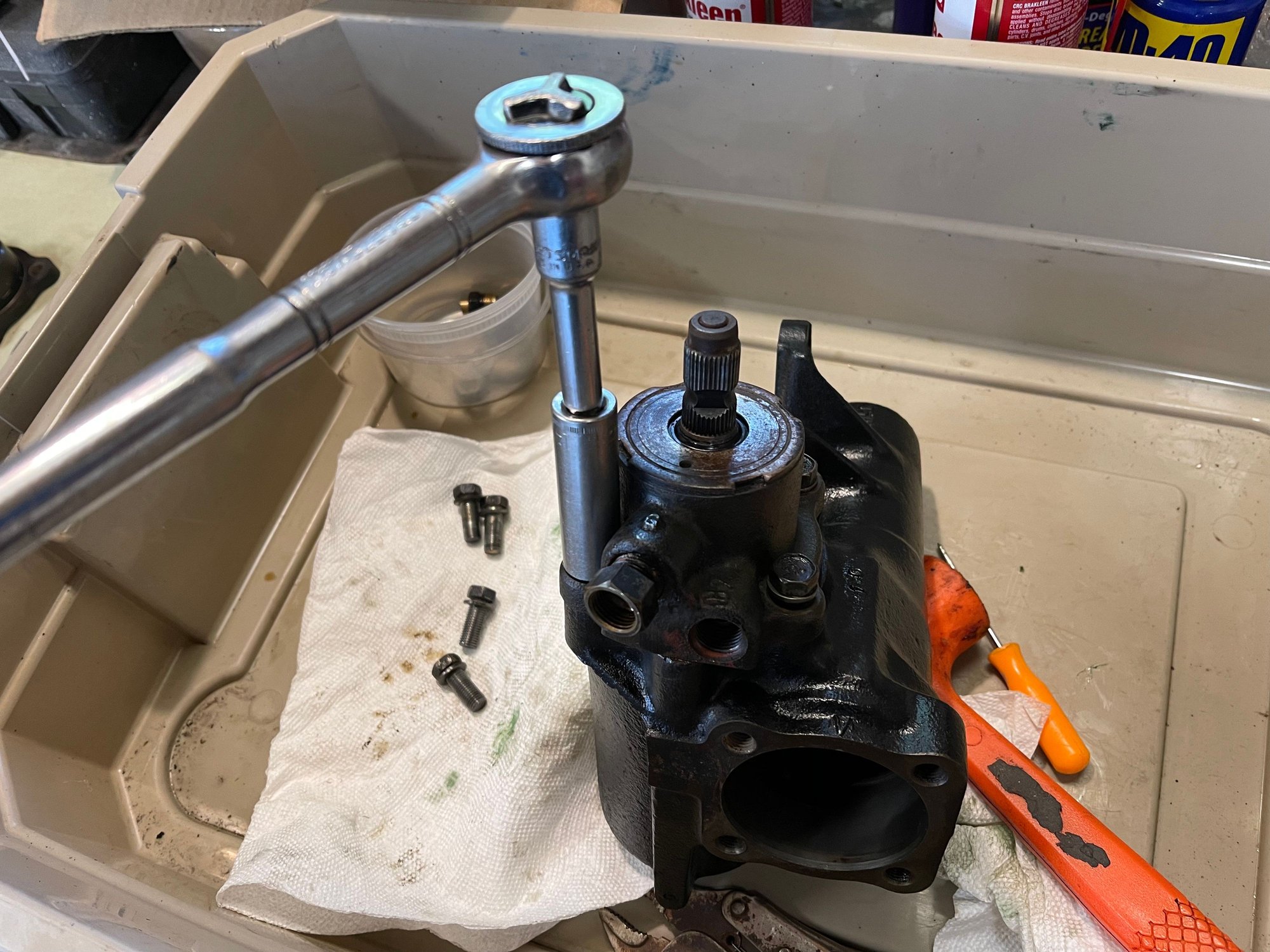

Remove top 4 bolts and one nut. Turning the screw clockwise will push the top cover off.

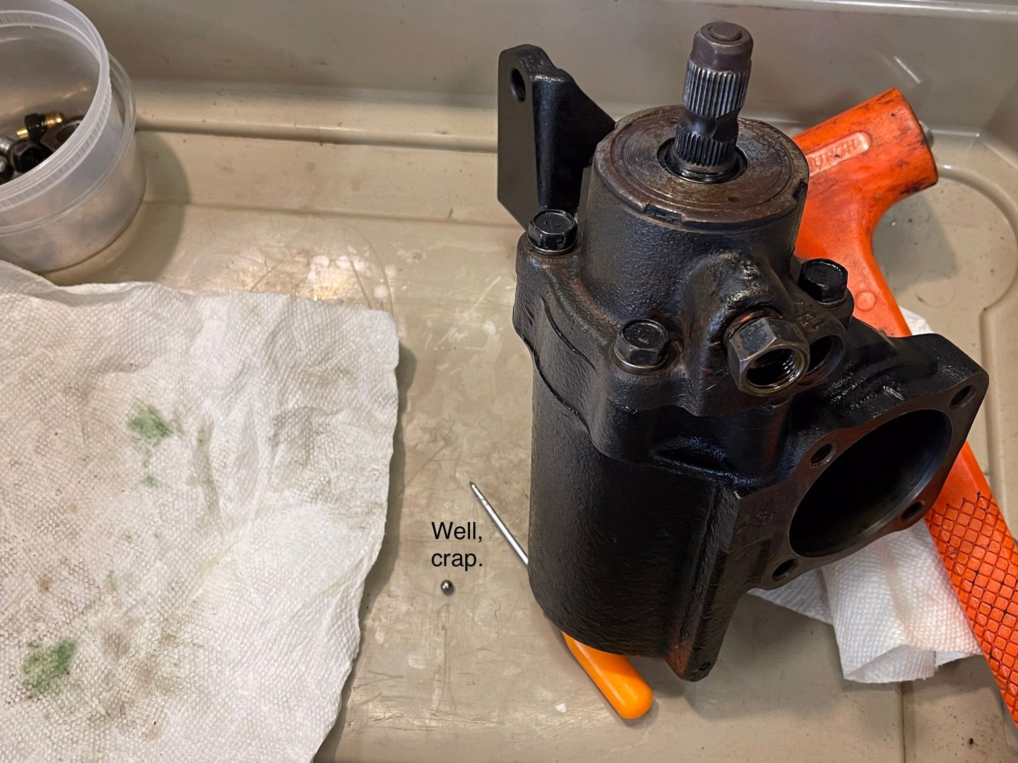

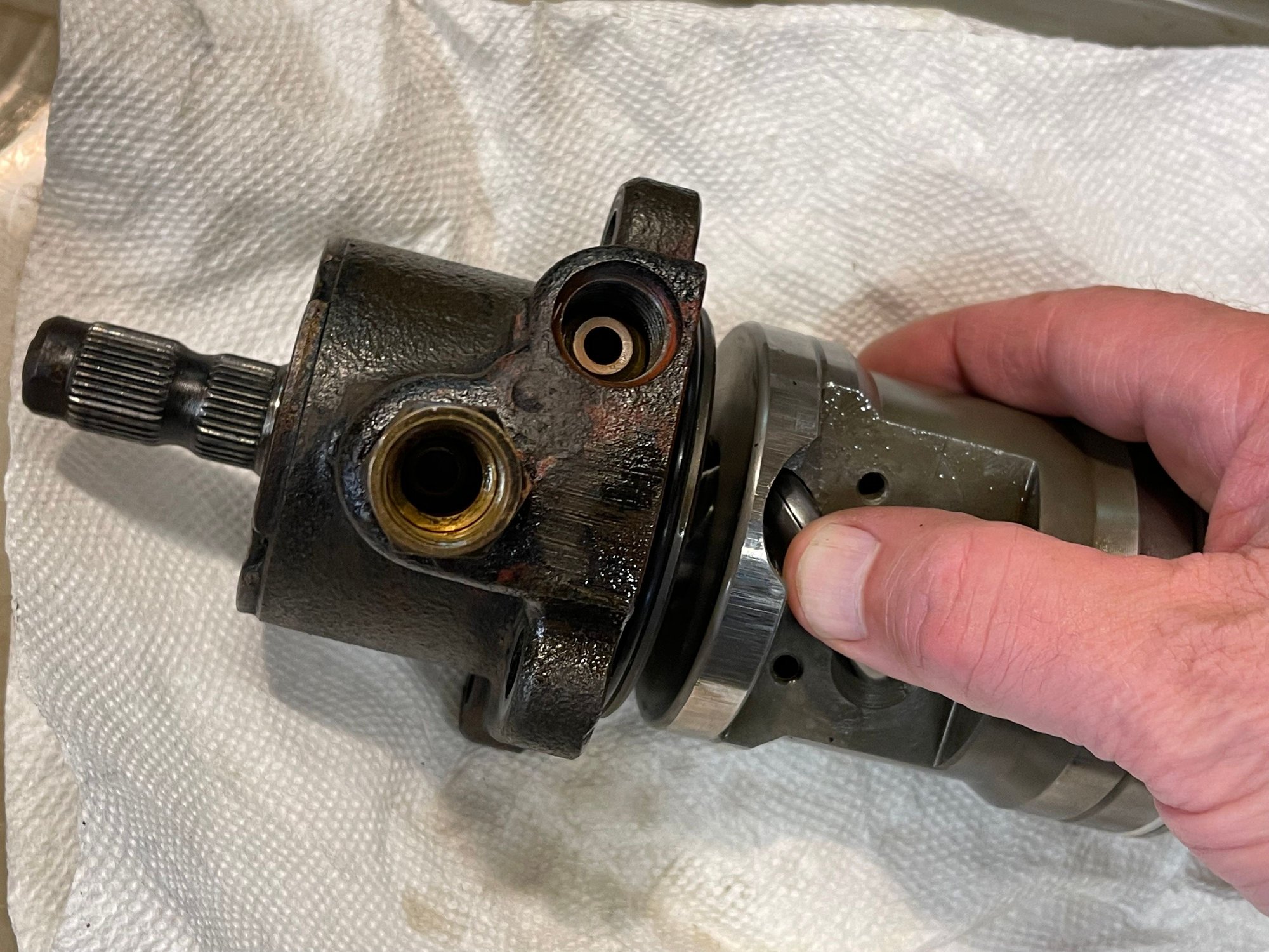

Remove 4 bolts on the valve body and turn the inpt shaft to separate. Prepare for about 44 ball bearings to come falling out.
Old Aug 22, 2021 | 06:05 PM
Melrose 4r's Avatar
5 Year Member
Joined: Jun 2017
Posts: 2,436
Likes: 965
From: 02176

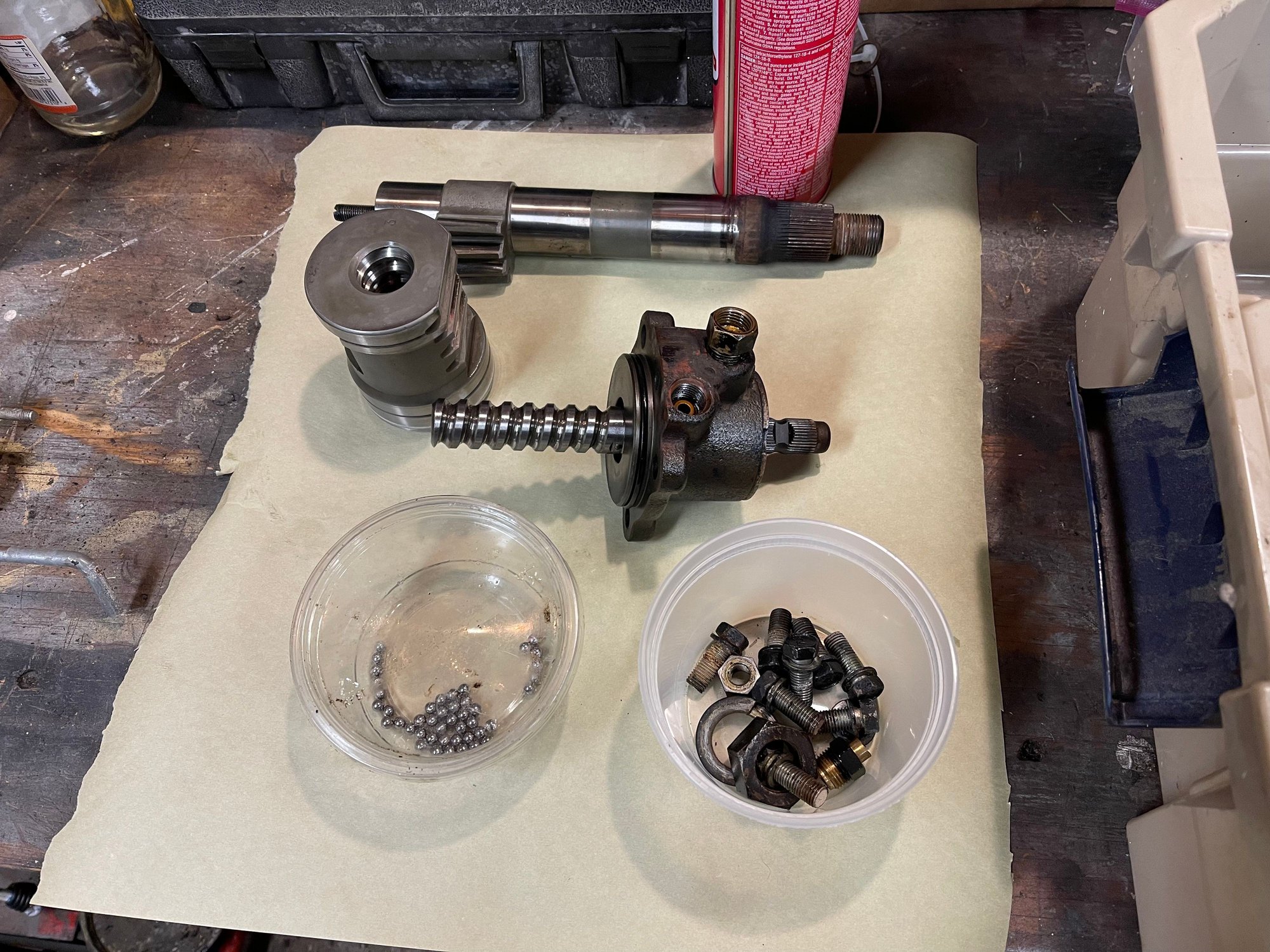

Unscrew the input shaft from the power piston. Bearings will fall out! Clean everything. Spray thru the valve control with Brakleen and make sure movement is smooth and not loose. If yours is leaking around the input shaft you will need to disassemble further to change the seal.

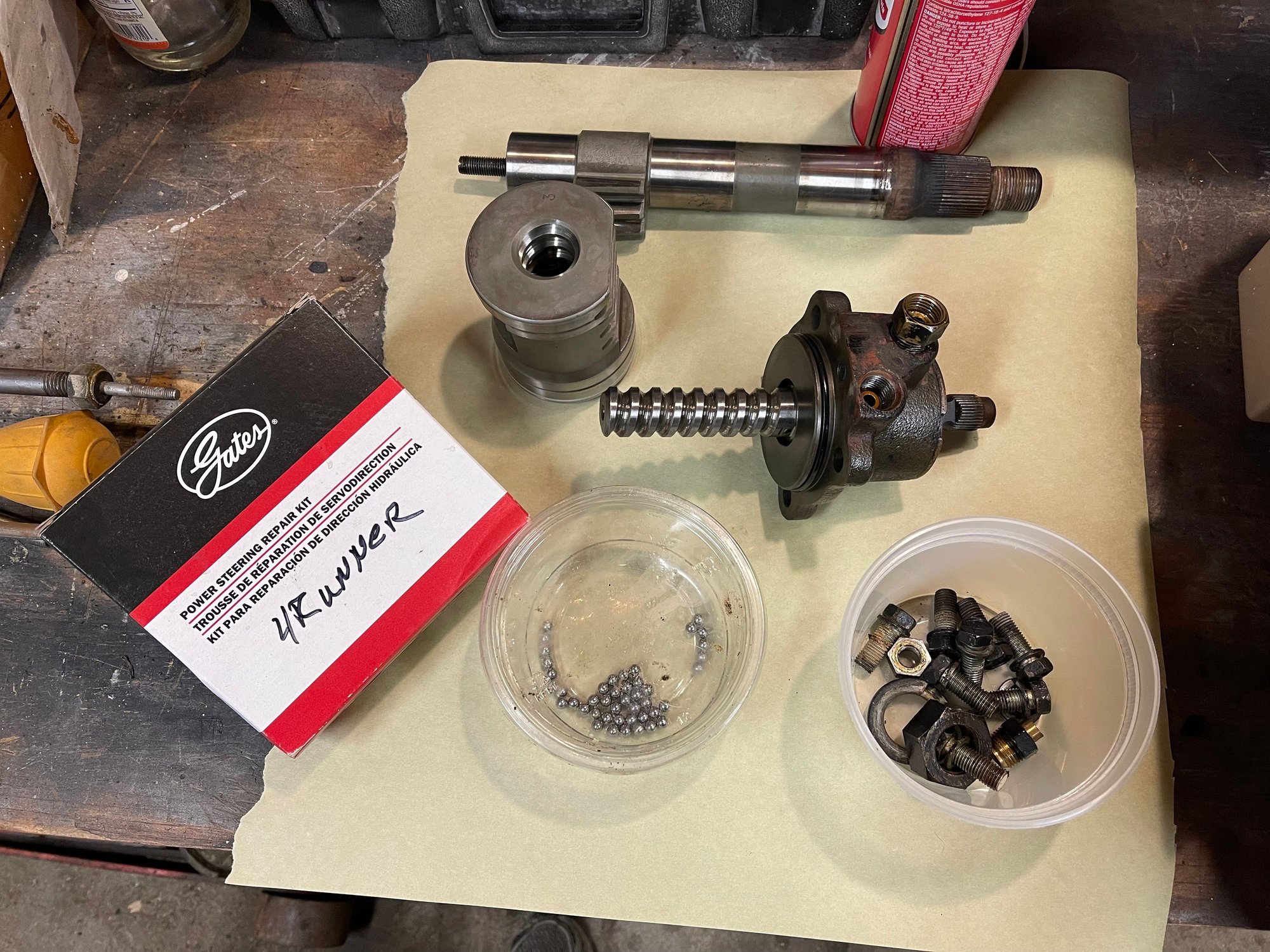

I used a Gates kit from Rock Auto. About $30. They sell two cheaper kits but all appear to contain the same parts, mostly seals.

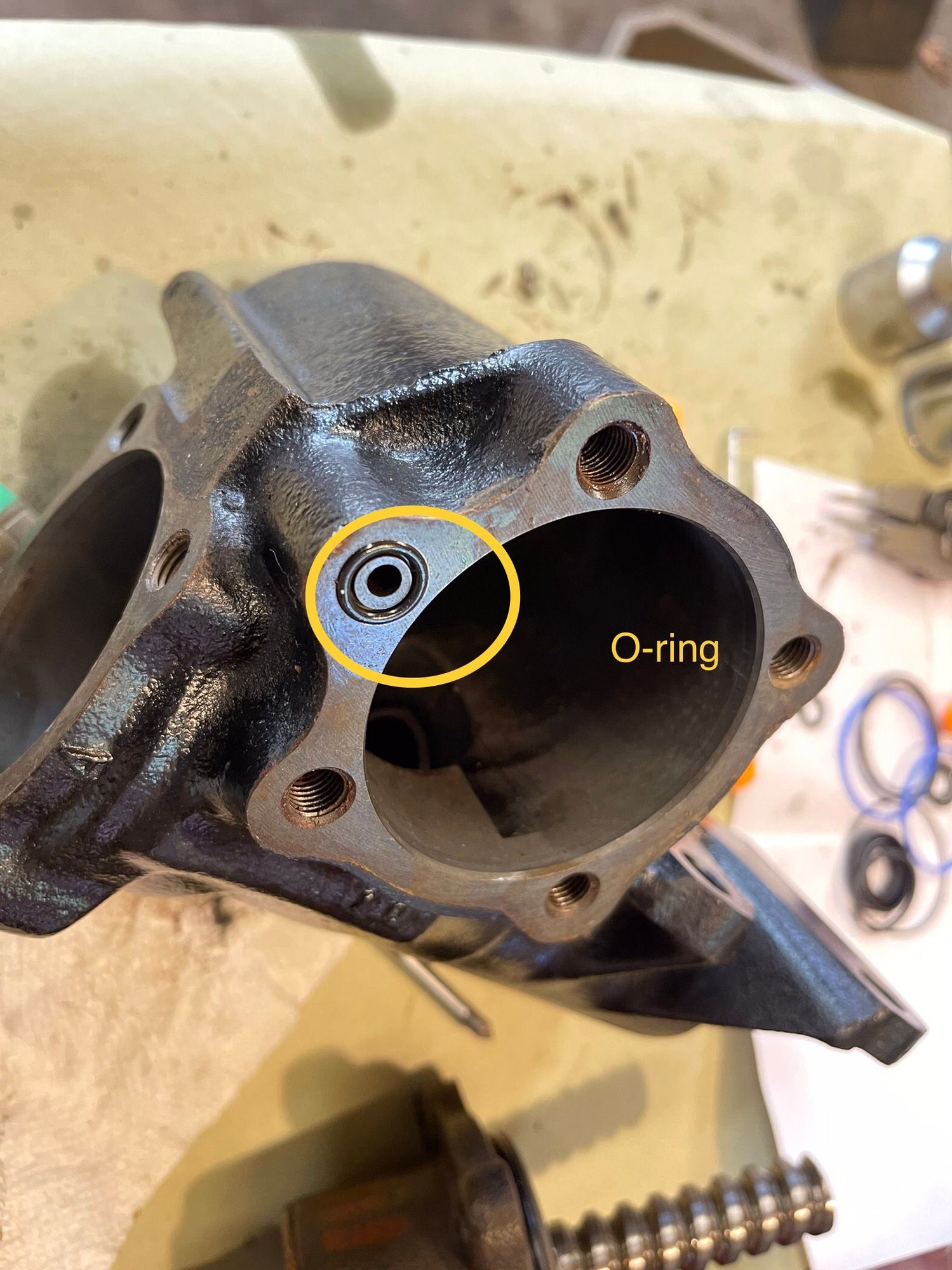

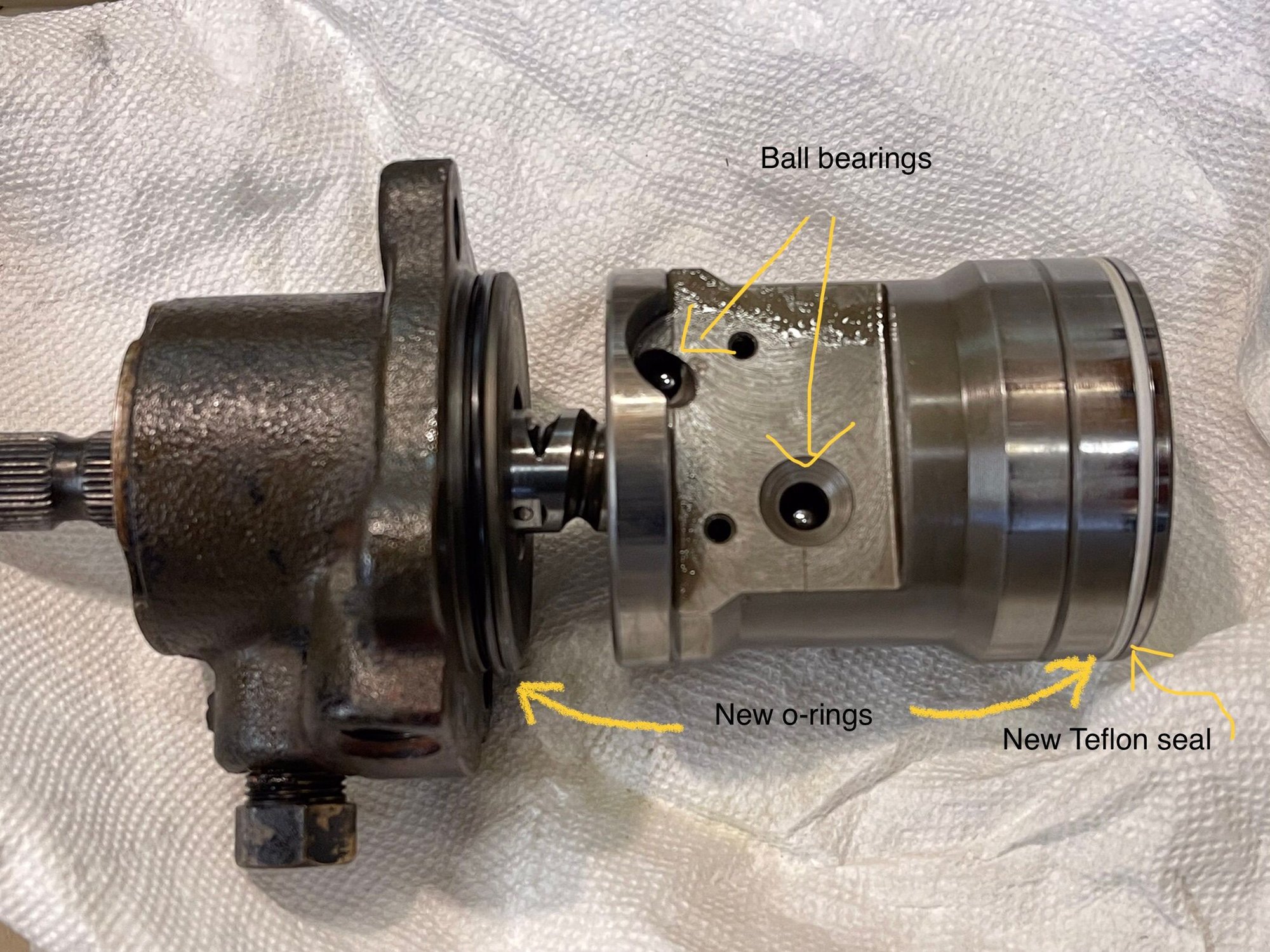

Replace the rubber o-ring on the top cover, then the parts in this photo. Put the worm gear into the power piston and get ready to load bearings.
Easy to miss this little one!
Old Aug 22, 2021 | 06:20 PM
Melrose 4r's Avatar
5 Year Member
Joined: Jun 2017
Posts: 2,436
Likes: 965
From: 02176
As you load the bearings in each hole about three at a time, apply pressure with your thumb and turn the input shaft to get them to move in. Put grease in the ends of half the bearing shell, then 11 or 12 bearings and then put the top half on. After all other bearings are in the power piston, put the bearing shell on and apply some pressure with your thumb. Again turning the input shaft back and forth see that it moves smoothly. Screw the bearing shell keeper down. Be cautious, the bearings can fall out again if you turn too far.

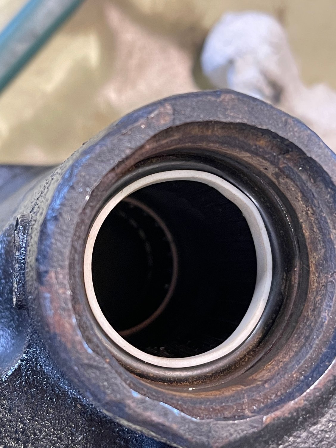

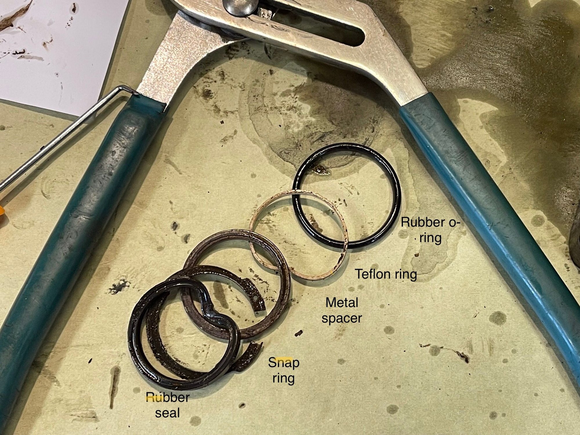

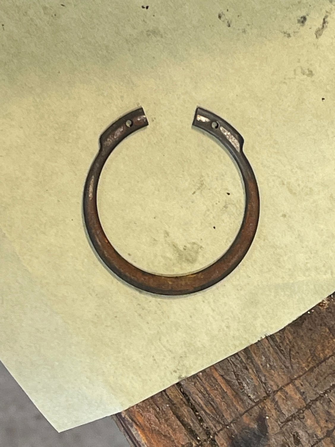

Now remove the rubber seal that seals the sector shaft with a hook, seal puller or screwdriver. Below it is a snap ring and then these other parts.
All these parts except the snap ring come in the kit.

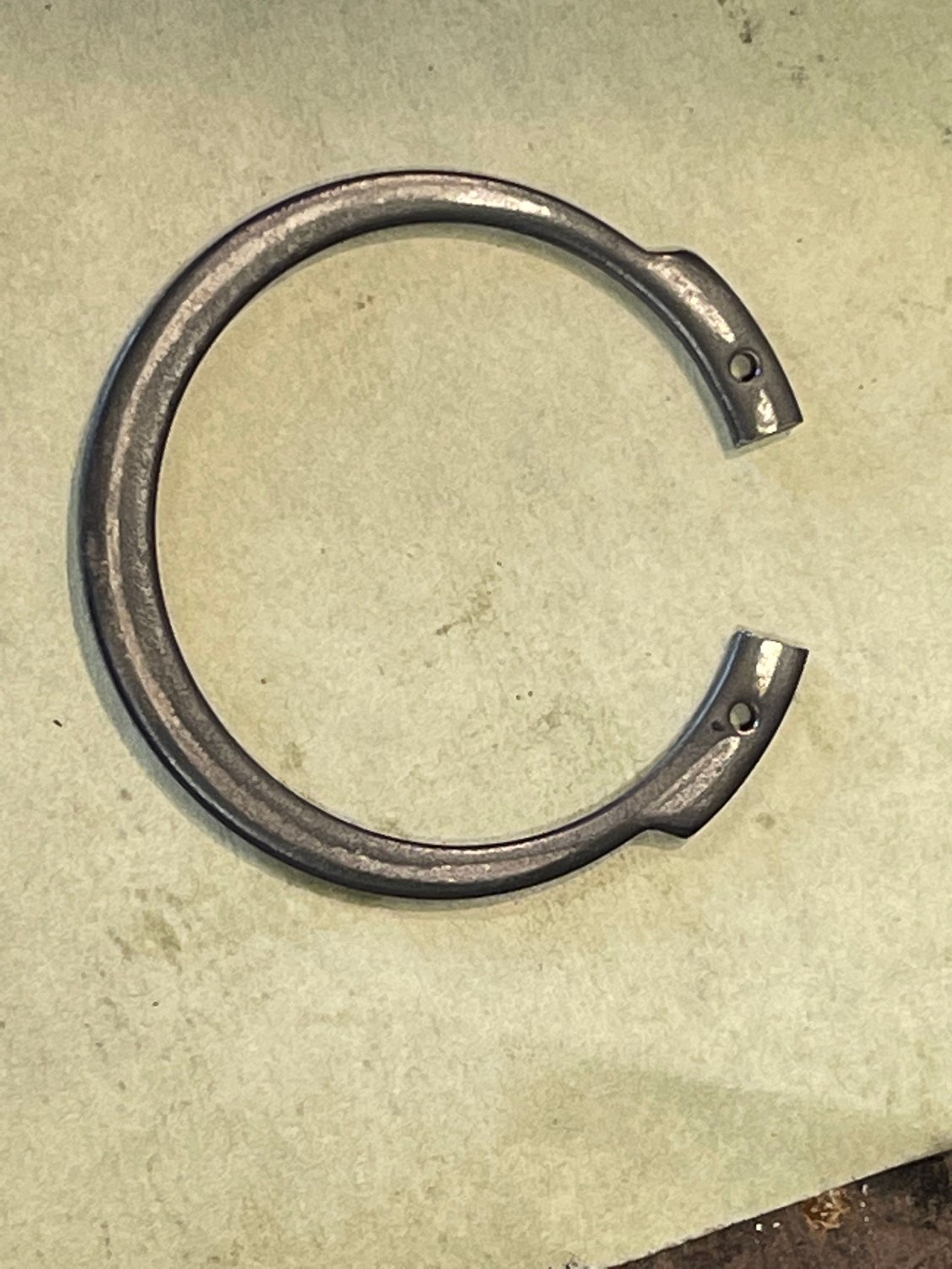

Gotta reuse this snap ring!
Cleaned up on wire wheel.

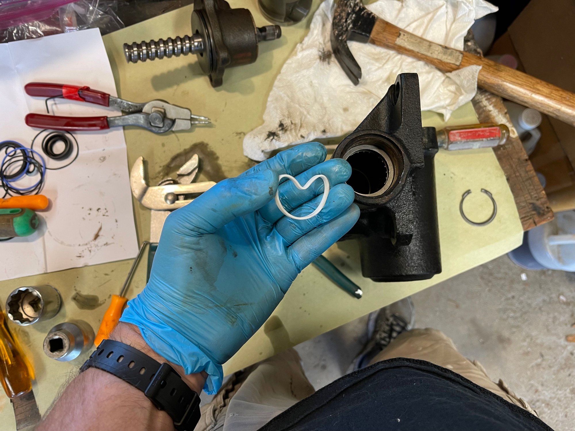

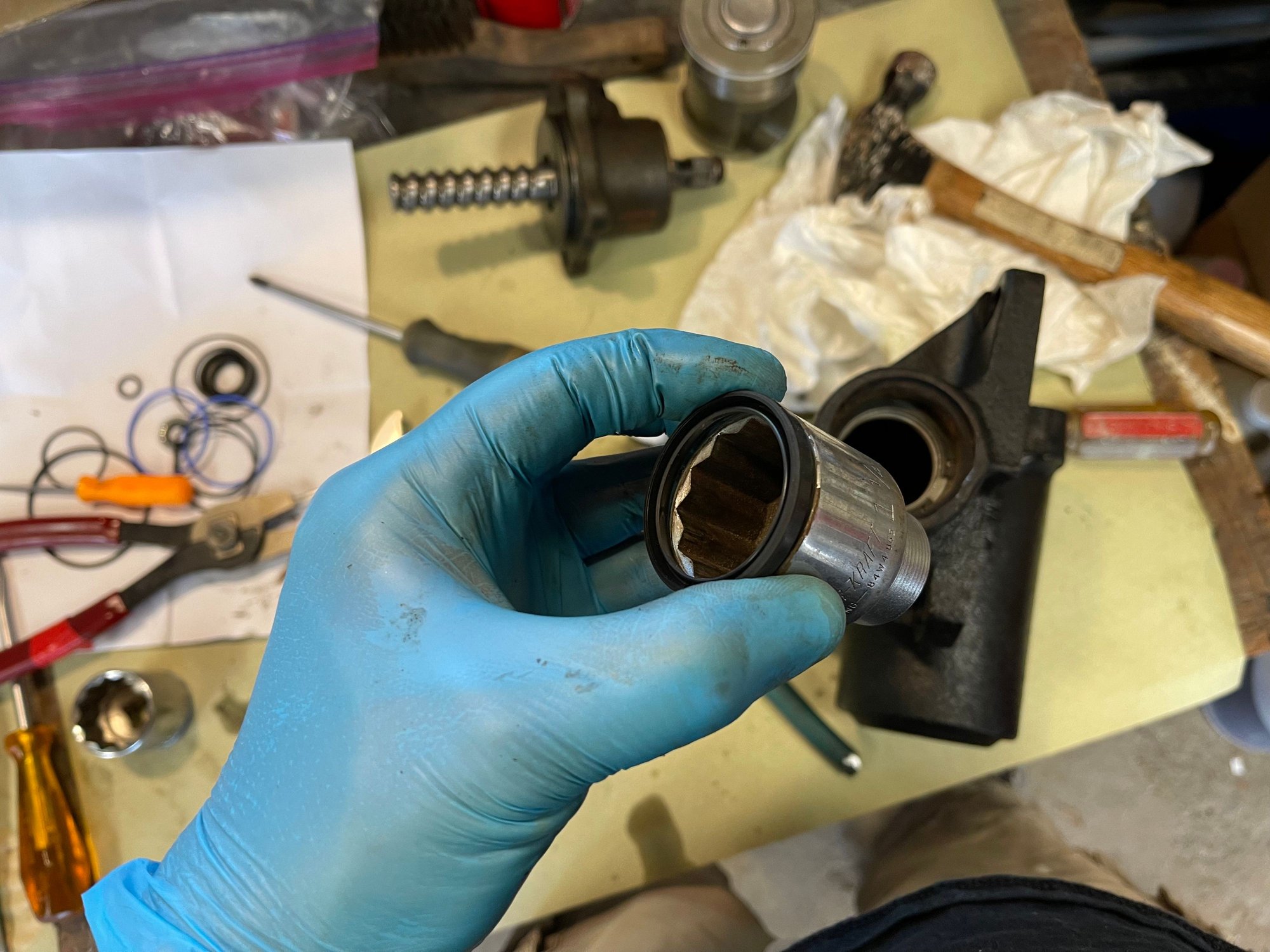

Reassemble the seal stack in reverse order.
Teflon seal is easier to place if you bend it into a cardioid shape.
Teflon seal goes inside o-ring.
1 1/4 socket is good for pushing down the seal. I also cleaned the sector shaft surface where this seal contacts it using a scuff pad and Wd40.

Lightly grease the power piston cylinder and o-rings and use two bolts to pull it until is seats. Then use the input shaft to center the gear teeth on the piston to the middle of its travel. The input shaft turns about 4.5 rotations so put it at 2.25 and you should be right about there. The flattend area on the input splines will be on the bottom if looking at the box in mounted position.

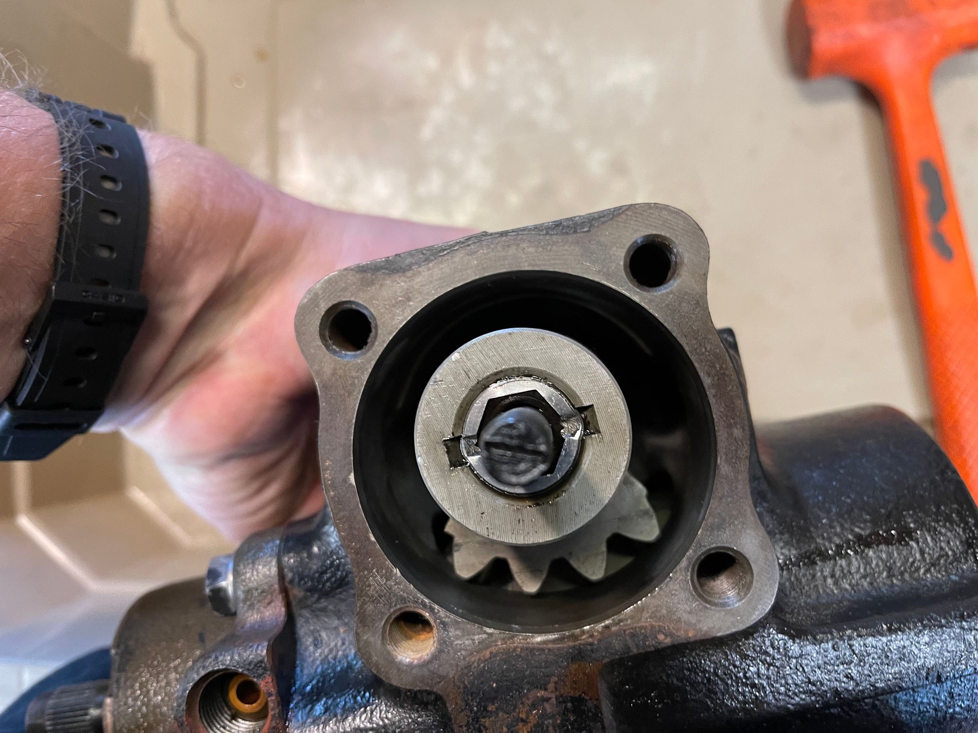

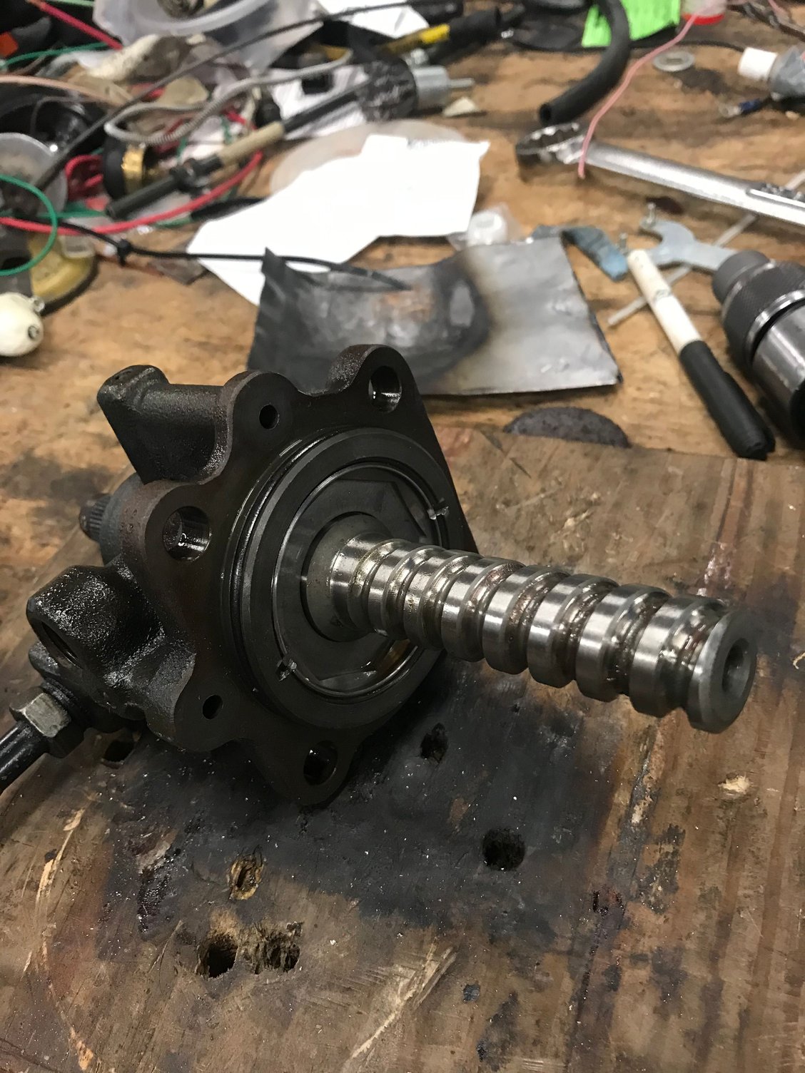

From: North Carolina

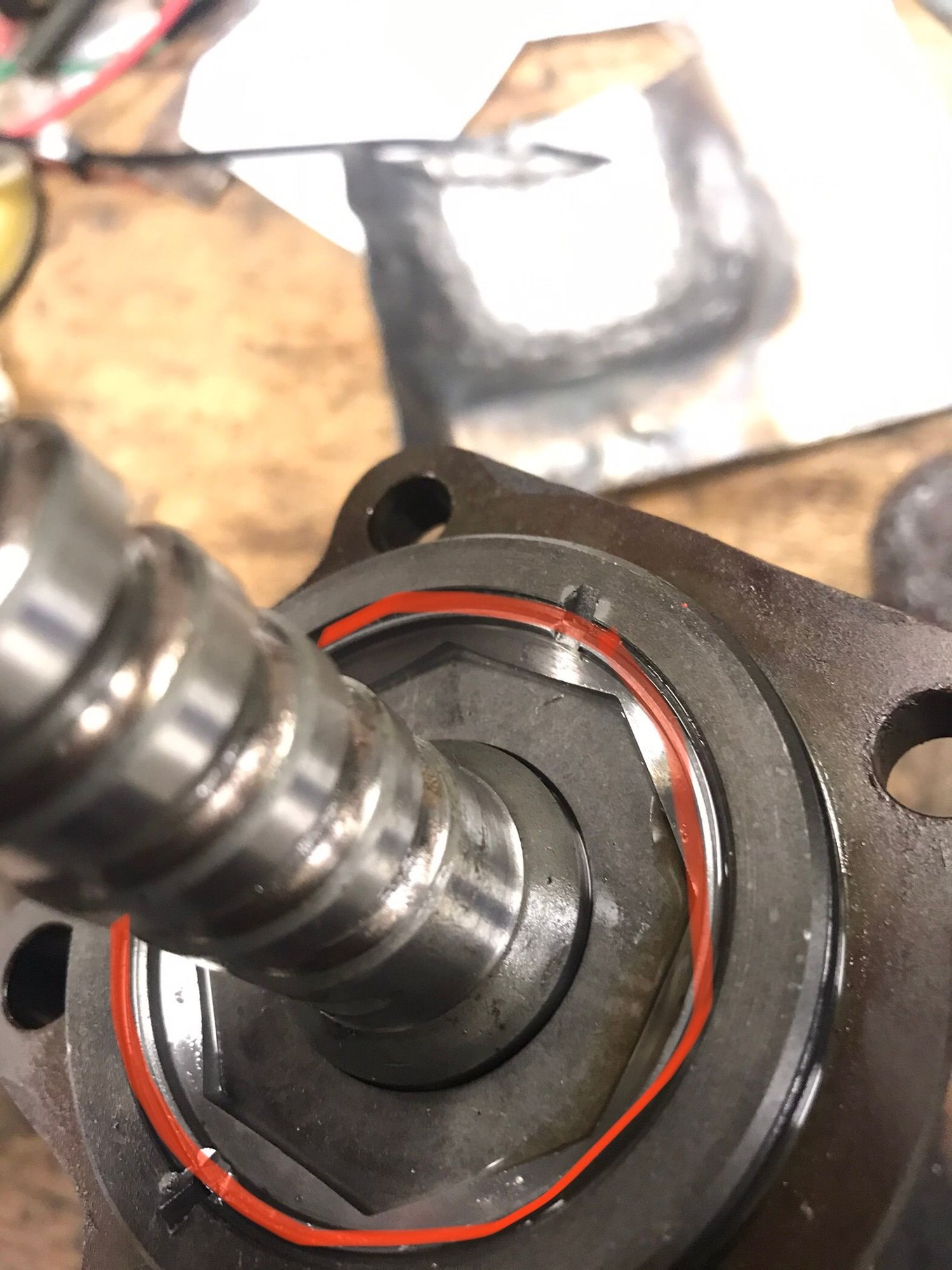

How in the world did you take this piece off?? i struggled for 2 days before I gave up, put it back together and used it as a core for a reman.
I could not for the life of me figure out how to get that piece off without a SST
(piece highlighted in red)
i suspect mel didn't take that apart, as he notes:
Old Aug 23, 2021 | 09:30 AM

From: 02176
Yes, Wally is correct. I didn’t have to, and your photo is different than my box.
But, if i was to attempt it on yours, my strategy would probably be to grind the staked areas with a Dremel tool,
Then fab some kind of spanner to fit that large hex. Then maybe use a couple tack welds instead of staking on reassembly.
