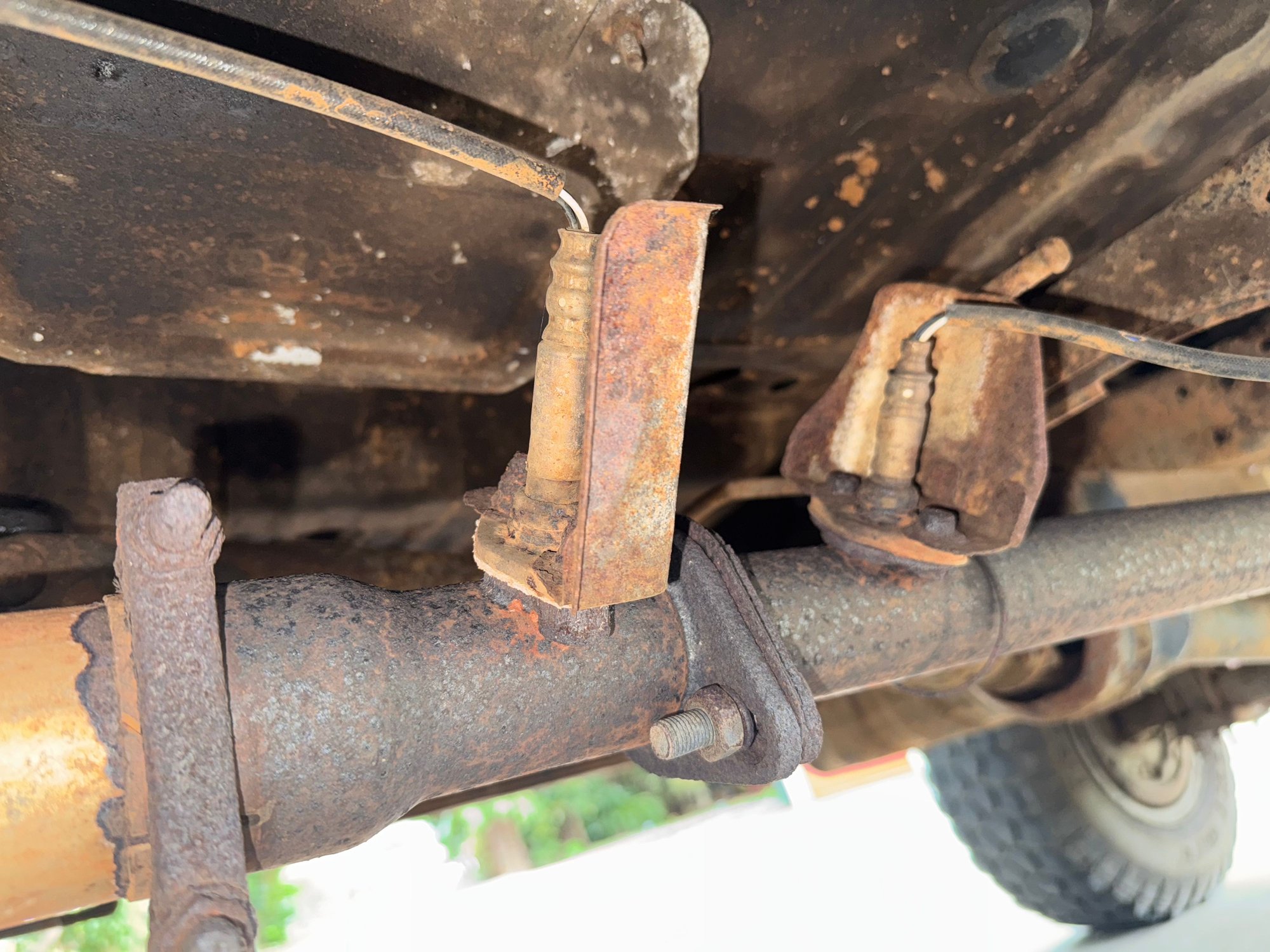

Aloha All,
I know this is an old thread but im confused as to why why OBD 1 22re has two oxygen sensors on the exhaust. Keep in mind there is no cat on it. Here is a photo. Would like to replace both but i dont know if its both the same type of o2 sensors. if anyone can give me a lead as to where to purchase these and how to effectively remove them that would be great!
Mahalo and Happy New Year
Left sensor leads to headers. Right sensor leads to borla exhaust. no cat system

Try Denso 234-4052.

Originally Posted by Fugarrr
Try Denso 234-4052.
Thanks for the reply. For both the sensors?
Yes both, Sorry my replies are late.
