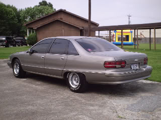

I could go over a long story, on the fan shroud, but I'll sum it up a bit short to say this; get one, and a good one, and put it on as straight and as close as possible. I have a very nice all origional 92 caprice; I will show pics in a bit.
got in a wreck not a bad one, but I had a mech, who shall remain nameless, replace the radiator as well as fix a few things. he did not put the shroud back on correctly, though it was there, and not broken. also your shroud may have a bracket it sits in, as well as the radiator, to keep everything lined up.
Anyway, ever time summer rolled around , for 3 years, this giant v8, which never before got above 160 degrees, even in the middle of a houston summer, was starting to max out at the red area, every summer. Went through several thermostats, couple of fan clutches, etc., to for about 3 years.
Then finally last year, while working on something else totally, my REAL mech says to me, you know, your front shroud and radiator are not lined up right, your shroud might be bad or the bracket it sits in. I say can you fix, he says, we can pull the bracket out, and hammer hear and there, and try, but I cannot promise you anything.
So he does, and puts it back in. Waa laa!!! not only does the shroud fit in, tight and snug and in perfect alignment, but once again, my gauge inside the car, does not move more than halfway, above the first heat stripe line.
Don't skip your shroud...
Pics.
Me likey very much, and very fast; bows it's back up like a pissed off cat!
