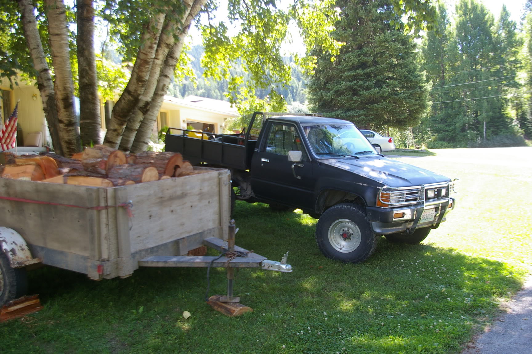

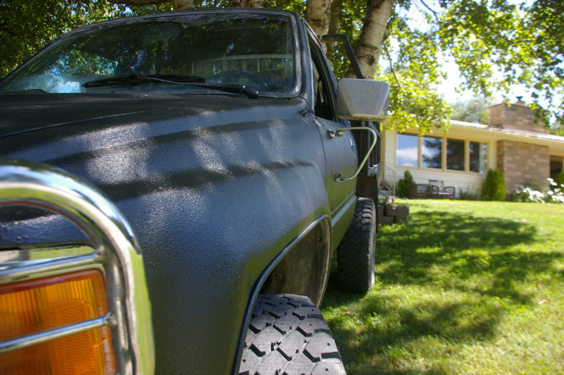

T_F_E's Avatar
Join Date: May 2010
Posts: 153
Received 0 Likes on 0 Posts
Size:  423.0 KB i like it
