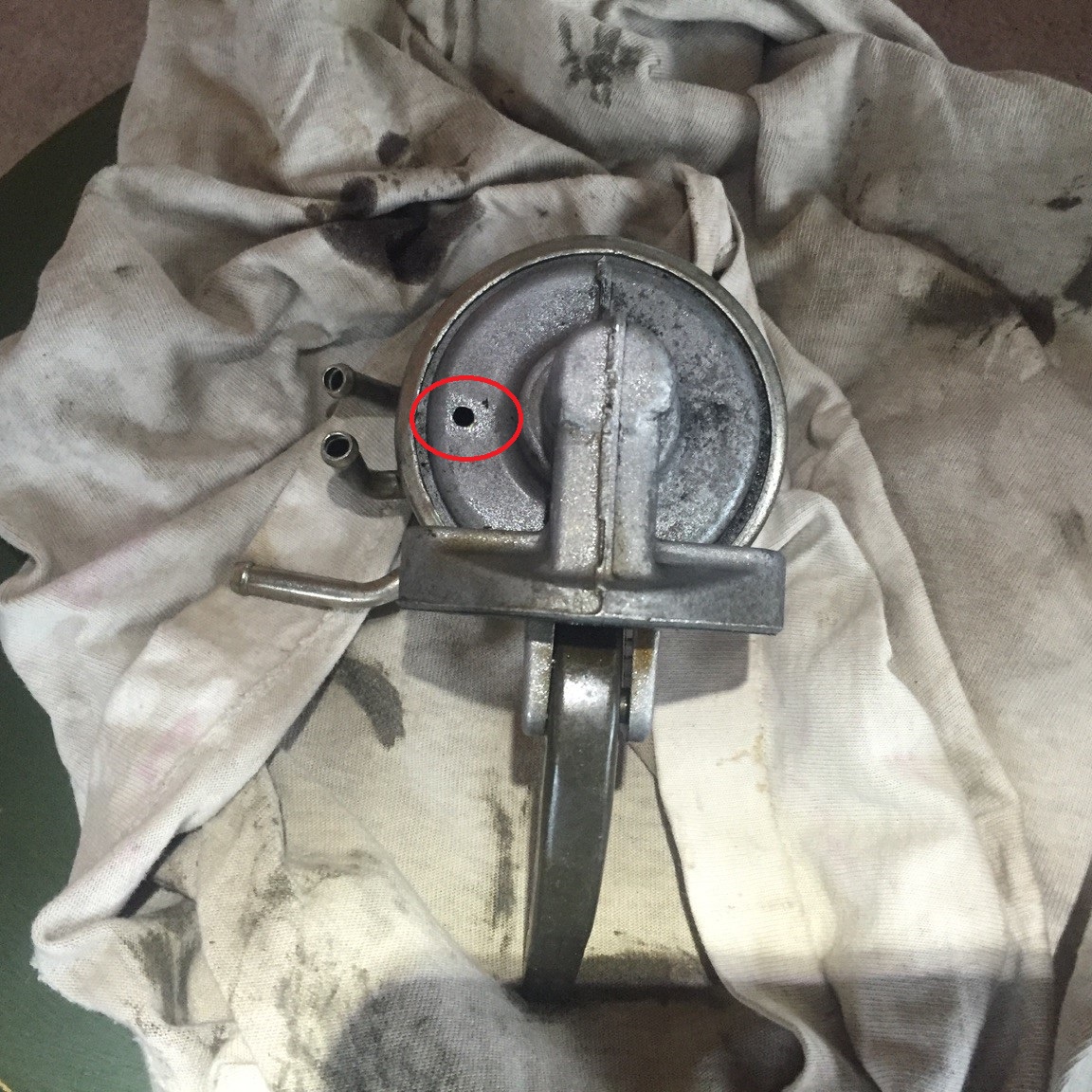

Hi there, I've got a '87 Toyota pickup, the engine is a 22re from a '87 4runner. I've noticed a significant fuel leak from beneath my fuel pump area. Checked the lines running to it, no cracking or holes. Removed my fuel pump and noticed a hole underneath it. Is that hole normal? Could it be what is causing the fuel leak? Like I said, the leak is significant, literally squirting, dripping fuel.

You don`t have a 22Re engine unless that picture is not yours .
The EFI pumps are in the fuel tank.
Just what engine do you have??
EFI or Carburetor ??
Carburetor diaphragm in fuel pump worn out.

Fuel pump shot. Diaphragm broke, the hole you see is a vent.
