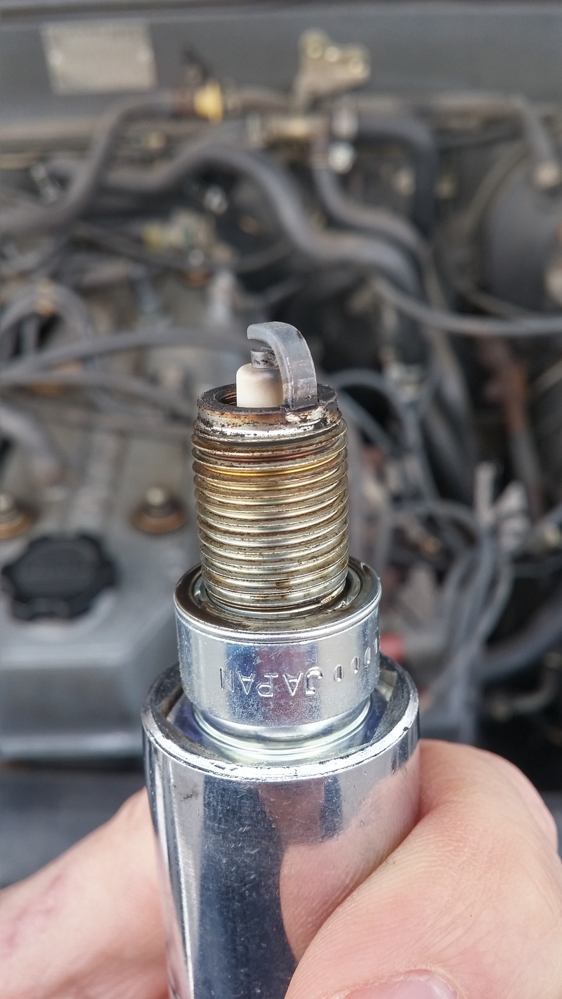

The other day I swapped my spark plugs and changed nothing else. Since then, every time I'm on the highway I get an awful pinging/bucking at speeds above ~60 mph. But not all the time or right away. Seems to be dependent on load. Uphill, it starts sooner (speed and time-wise) and lasts longer after I get out of the throttle. Downhill, it only does it if I'm hard on the throttle. Level, it does it when I try to maintain higher speeds than ~60 mph but as I back out of the throttle it stops fairly quickly.
I changed from AC Delco R43XLS to NGK BPR5EY. Were the AC Delcos a colder plug? I tried to look it up and didn't find an answer. I'm going to go buy some more in a minute to see if I can at least get it running right again.
There might more to the issue though, if I can't run the "normal" 22RE plugs. I think it might be running lean for some reason. I think I'm going to grab a new O2 sensor as well, since I know I've been burning oil (my old plugs were caked in ash) so I think that might be part of the problem. I'm going to pull the codes before I run to the store, so I'll post them up when I get done.
Any other ideas?

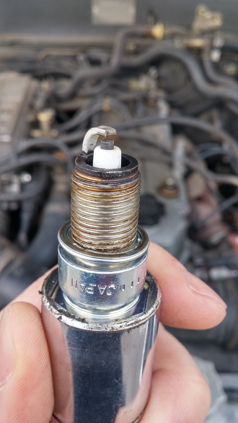

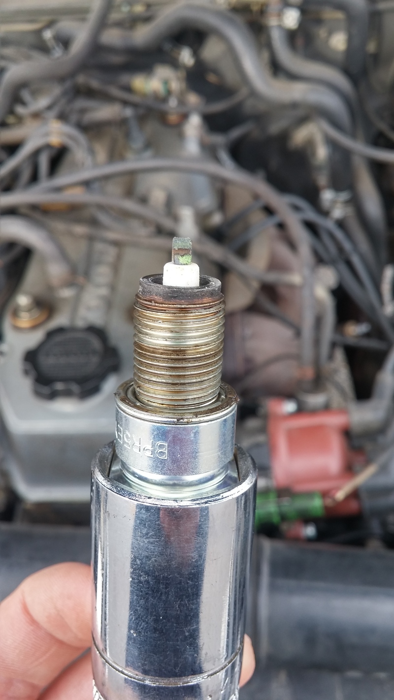

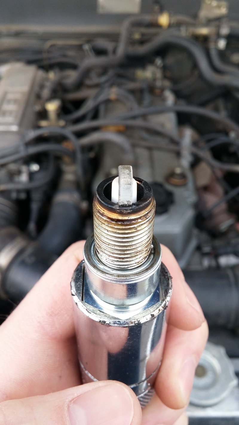

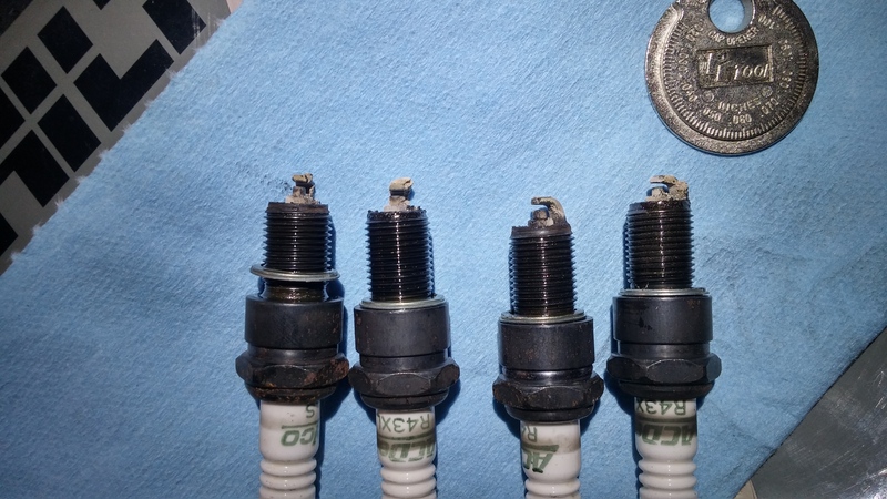

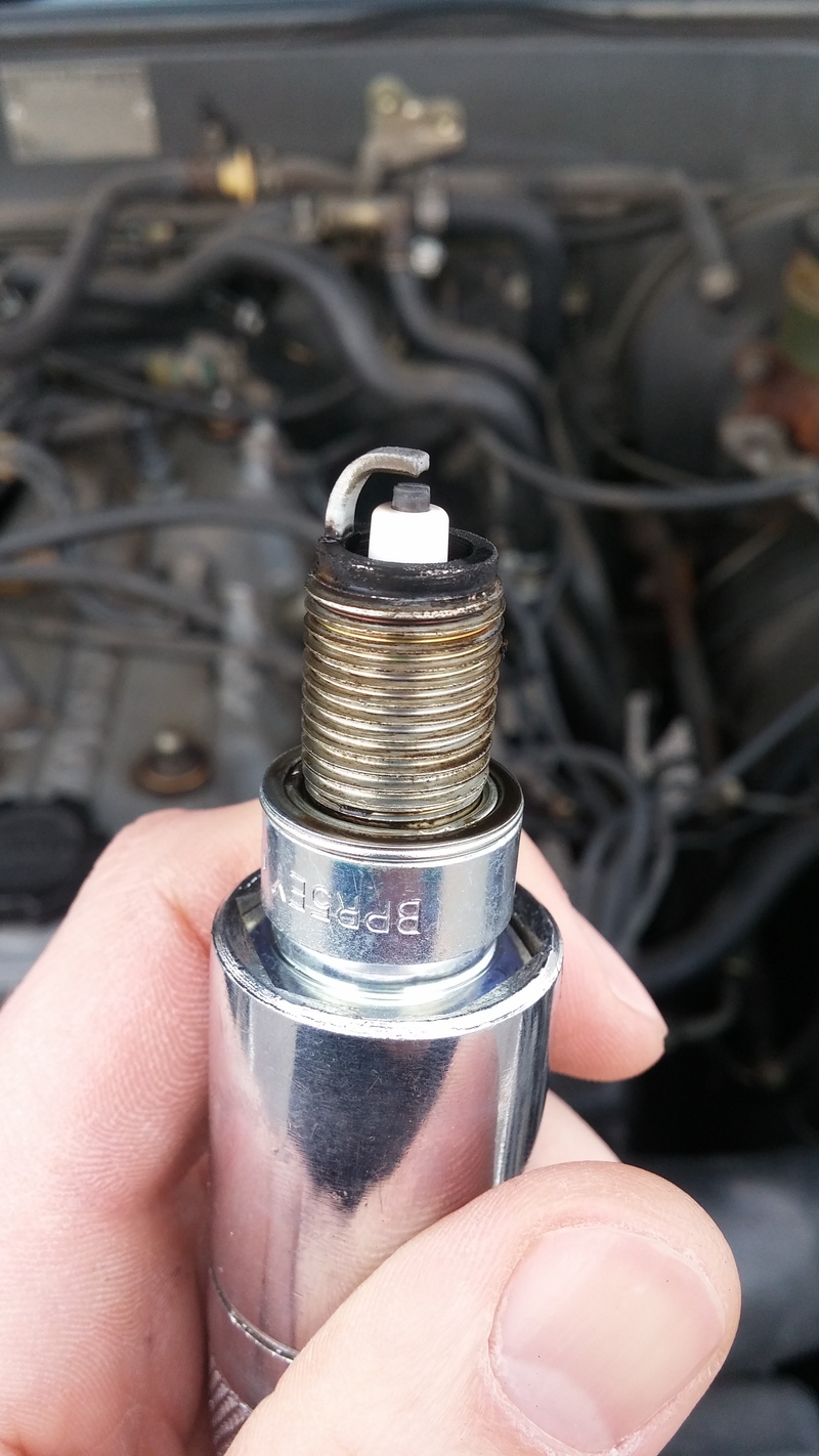

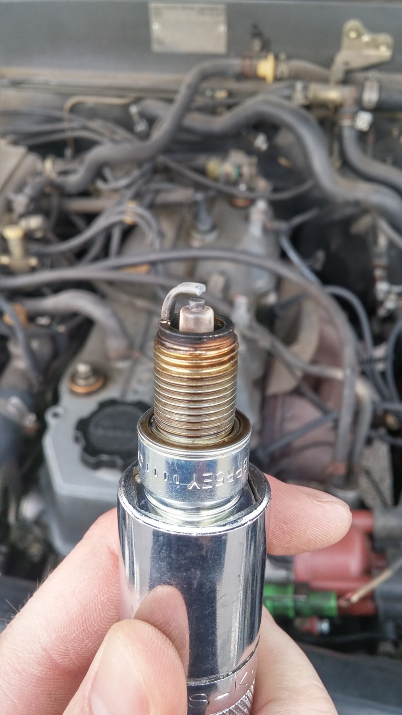

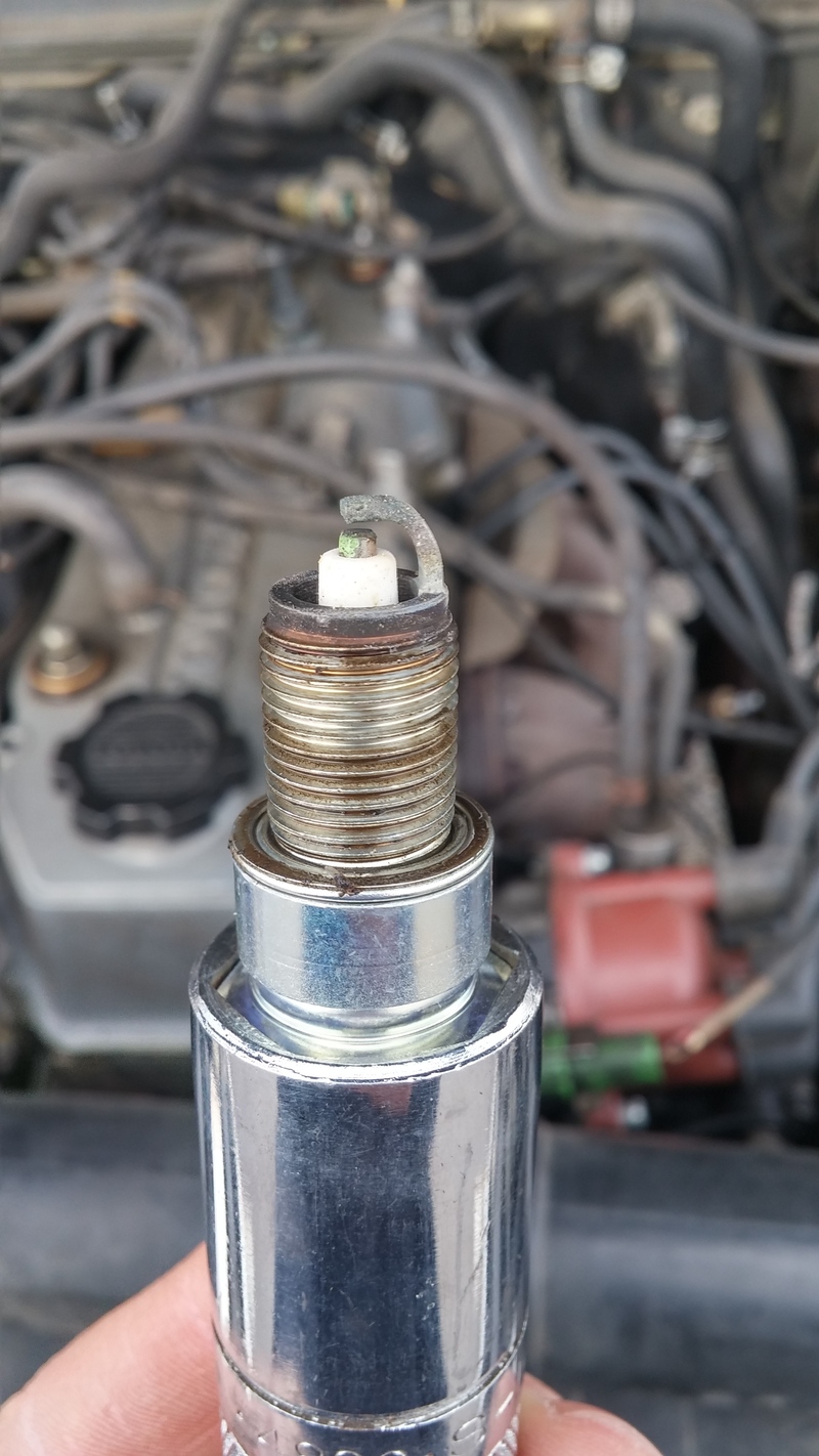

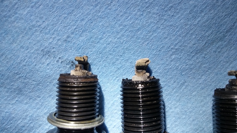

Old Plugs:

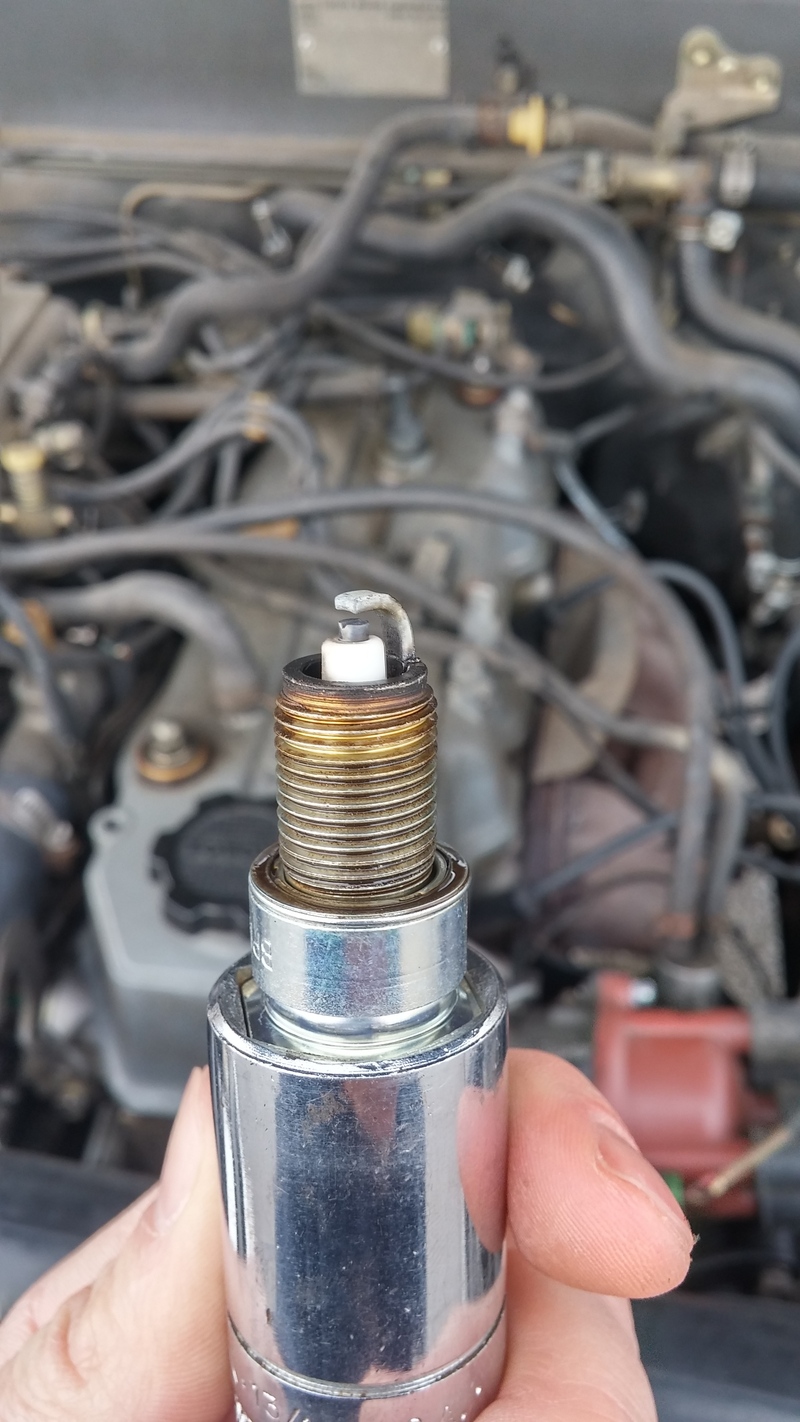

New Plugs:
#1:
#2:

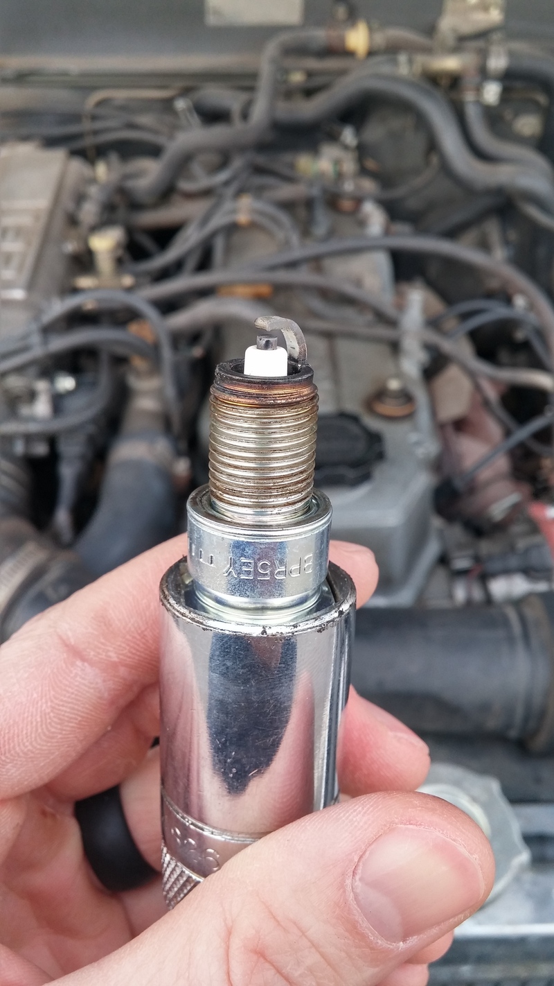

#3:

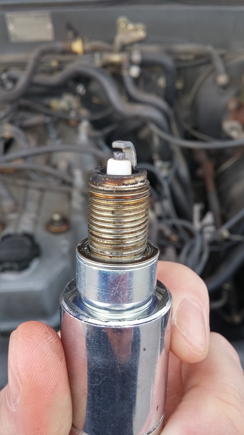

#4:
