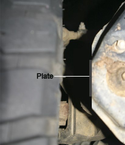

I think it would be too close for my comfort. Exactly how wide are the tires you have on now? In my opinion, I don't think it would hurt to grind the lip (and maybe a little more) of the A-Arm, like the picture below. I would weld a plate on the side afterwards, just to retain the strength. Doing it like the picture, I really don't see any issues with clearance of the bushings.
Attached Thumbnails HELP! Toyo M/T Tire fitment?-tire_arm3.jpg

Well, if the "actual" tire width is 12.5" and your new ones are 14.2", they are going to stick out .85" further to the sides. I would either grind off that lip or install modified A-Arms like jacksonpt mentioned. It's way too close otherwise.
