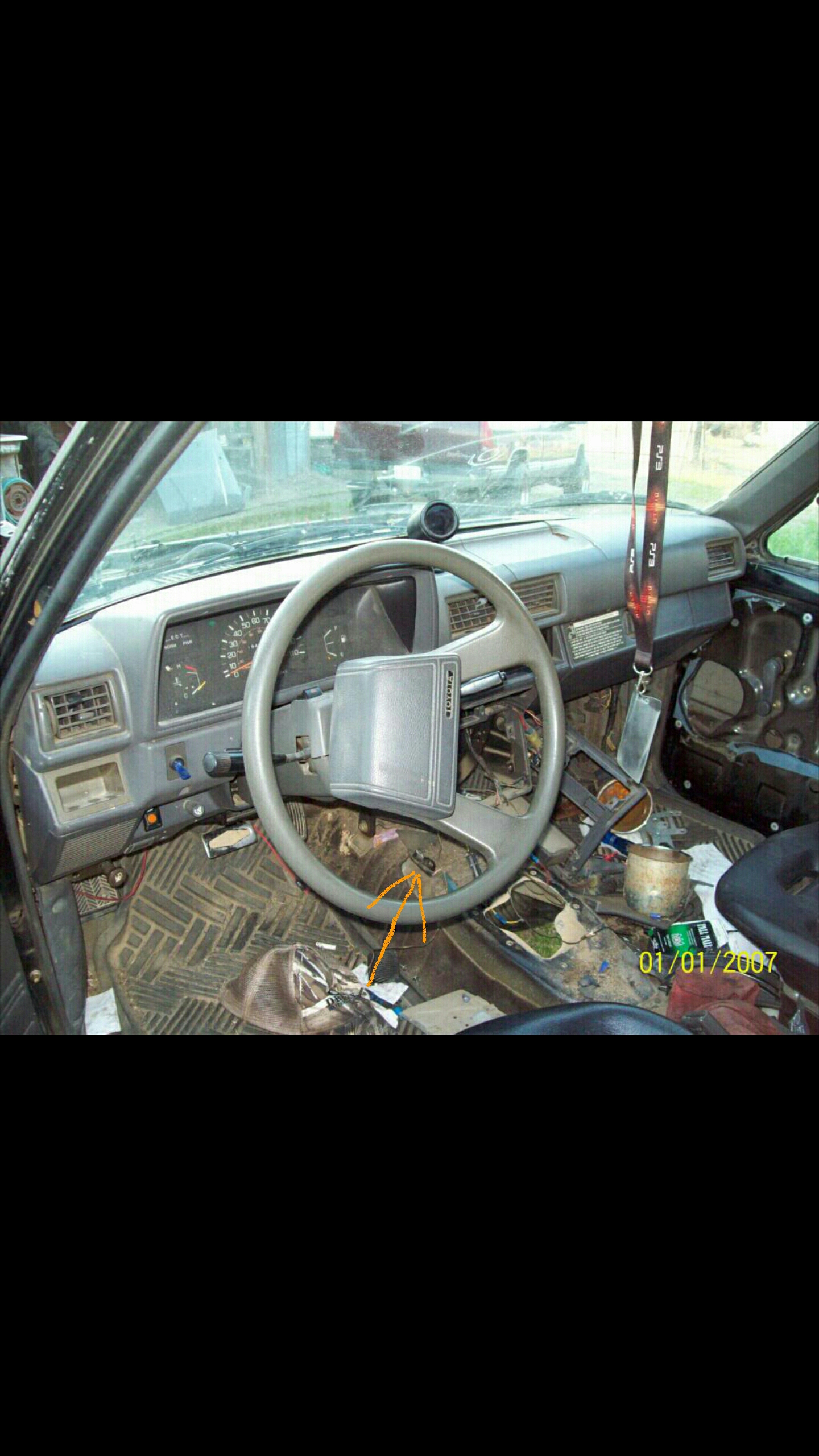

Negative. It's under the plastic under your radio directly in front of your shifter. Remove the plastic in front of shifter and you'll see the tcm.

If you look closely I marked where the location is and the bracket that it bolted too
Attached Thumbnails HELP! Superpooch-screenshot_2016-09-10-00-53-51.jpg   HELP! Superpooch-screenshot_2016-09-10-00-55-29.jpg

These photos were actually taken during my 5 speed and seat swap
