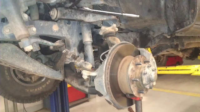

NOt true the only tention is from the tortion bar, adjust the tortion bars down and then unbolt the control armfrom frame and spindle, its easier to undo the 4 bolts holding the ball joint in place over trying to bash it out of the spindle. i also found it easier to use a drill and a wire wheel to get old bushings out, i say this because the bushing kit i got does not come with hardwear so i had to reuse the metal. the excess rubber thats stuck to the metal will come right off with a wire wheel and then press in the new bushing with a ball joint press, seemed to be the easiest way for me

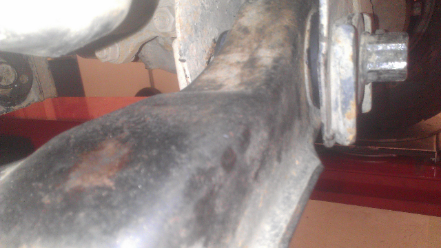

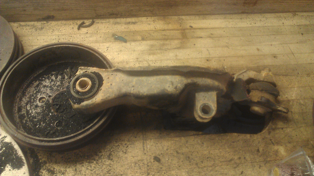

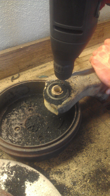

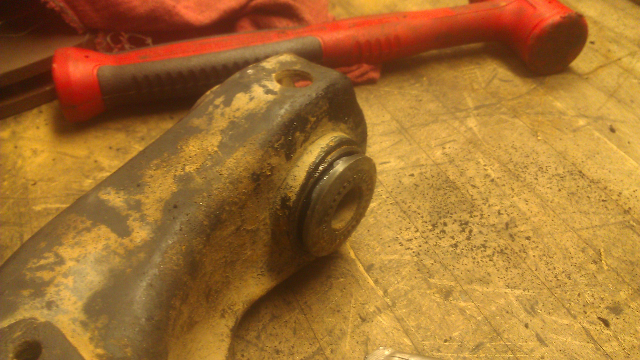

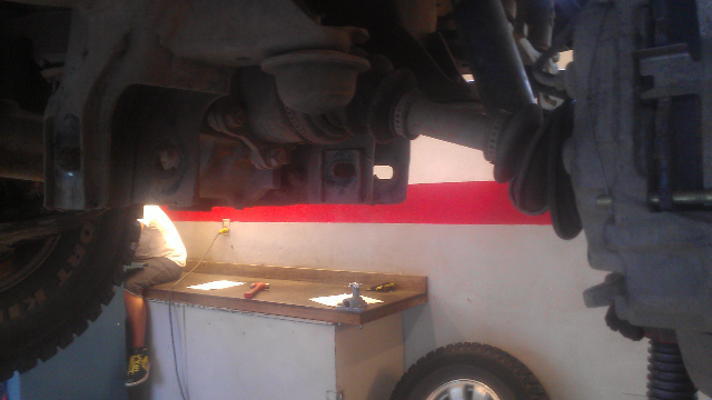

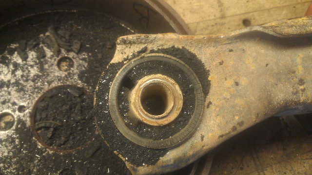

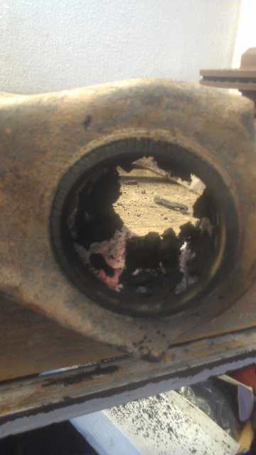

So here is just the lower for now!

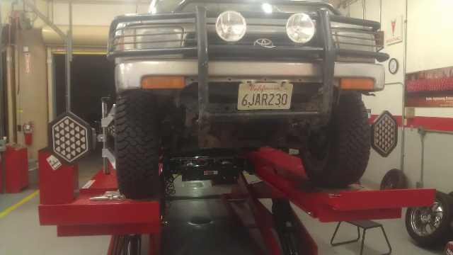

I'm in advanced allingment at cuyamaca college so it's helped having an allingment rack!

Isn't that your Lower Control Arm?
Those are way easier to do than the uppers...
Glad it worked out for you
Old 09-06-2013, 06:42 AM
crawling4runner86's Avatar
Join Date: Jul 2012
Location: San Diego CA.
Posts: 20
Received 0 Likes on 0 Posts
Didn't I say here is the lower for now waiting for shocks and bj spacer before I tackle the upper... It was to give them an idea of how to drill it out...

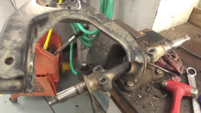

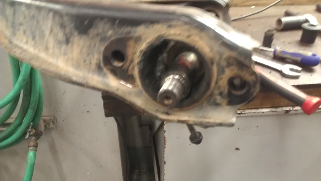

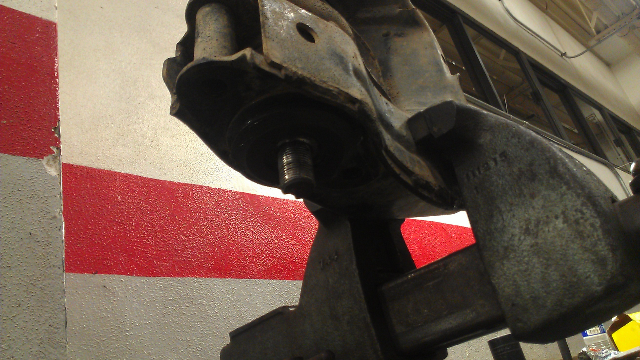

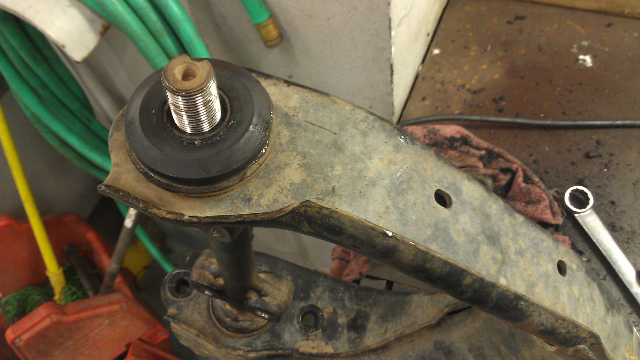

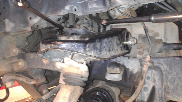

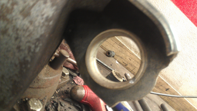

Here is the upper! However I did snap the adjuster bolt so now its back together getting new bolts tomorrow... Once you drill out the bigger bushing the smaller one will come out with some force and the mounting bracket comes out

Any questions feel free to ask I'm sure this is the only photos of how the upper is done on the web

you said how you free'd the upper bushings, but how did you get it all back together? with a hammer or a press? i need to do this on my truck, you make it look WAY easier than everyone else has made it out to be.
Old 09-11-2013, 09:35 AM
Join Date: Jul 2012
Posts: 20
Just a mallet didn't need a press and they were the original bushings, after drilling out the bigger bushing the smaller bushing just slipped out with a little force
Old 09-11-2013, 09:58 AM
Join Date: Jul 2012
Posts: 20
You can never use enough lube they slipped in with a couple swings of a mallet
Old 09-11-2013, 10:03 AM
Join Date: Jul 2012
Posts: 20
The whole process took about an hour just make sure you pre soak torsion bolts days in advance so you don't snap them that was the only problem I had
