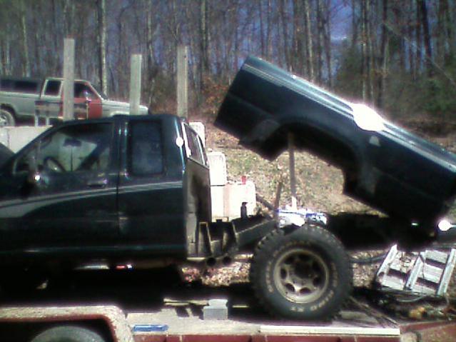

fast forward to this past friday(3-19-010) and my truck leaves me stranded(yet again) in the middle of a two lane road. lucky i was about 100 yards from my dads work, and we towed the dang thing back to the house. scoming up a hill on the road the engine started bogging out and left me sitting ten feet from a road to pull into to get it out of the 2 lane. the truck was acting like it does when the engine is trying to start while the motor is warm(see above posts).
that saturday, we decided to pull the bed off and replace the fuel pump. we were going to unload it off the trailer, but since the bed bolts were coming off we decided to leave it on the trailer to make it easier to reach the underbody bed bolts. a can of WD40 and 20 mins later, the bolts were off. we propped the bed back(think dumptruck) !!!!!!!!!!!!!NOT SAFE!!!!!!!! DO NOT TRY THIS AT HOME!!!!!!!!!! with some poles, and began pulling the lid off the pump. got it replaced, and it wouldnt start.
dad said "you sure you didnt run outta gas?" NOPE my fuel light wasnt on, but the indicatior was below a 1/4 tank. so we put in two gallons and after about treee mor tries(and killing the battery) the truck fired up.
we unloaded the truck and it ran stronger than it did since the check engine light first came on(knock sensor=see above also)
i am finally able to start the truck without starting fluid, but it is still not on the first try. when i take it to the shop to replace the knock sensor i will have the mechanic check the fuel injectors to see if any are leaking down, or clogged. in the time before that though, i will be removing the cold start valve to soak it in throttle body cleaner, to see if it is clogged as well.

Attached Thumbnails Help!!! My truck wont start warm or cold!!!-dump-truck.jpg
