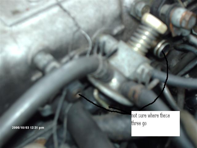

I am looking for this. What is the part # and where can I purchase it?
Yes I found the pic from a different thread but nobody said a part #?
All I know is it's a: Diaphram Sub Assy, Cooler; Diaphram Sub Assy, Idle Up
I have a 1986 Toyota 4 Runner SR5 2.4 22RE EFI non turbo
I've just been trying to replace what is missing!

A/C Idle-up valve.
Click here and scroll through the next couple of pix.
Does the A/C not work? Might have been removed for that reason.

88031A Diaphragm Sub-assy, Idle-up Actuator 88606-35020
And it's available still, not discontinued.

Hey thanks! and no I don't have A/C

If you don't have a c you don't need it...

Now my buddy's 22re had that too, but was connected to the PS pump idle up. He had no AC, either. I don't have AC, but my PS pump idle up just has a plug in that hole, and the lines run into the plenum and throttle body...which way is right?

Really? Because yeah some people still have those things even though they have no ac but yes it could have been pulled out for more horsepower from a previous owner and mine just stripped out completely. So if your saying that vacuum line and switch is for the ac system then how does it work?
