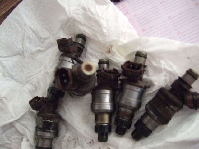

My 3.0 failed nox because it had clogged injectors. It eventually passed (barely by 3ppm) with the clogged injectors. They were full of rust.
I've yet to retest it, but that clogged one caused a very lean condition.
I'm not saying that your truck is clogged full of rust like, but i'm thinking you may want to look into it at least.
