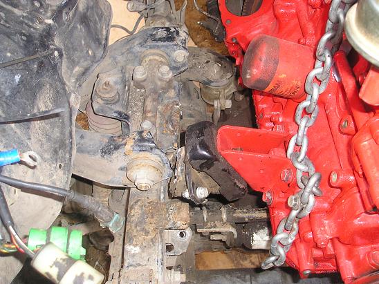

I got a 1988 Toyota Pickup. We put the engine in with the tranny that came with the pickup. now the engine is about 4 inches farther up than it should be, so the fan on the engine hits the radiator.

In the first pic of the second post...is it just me or does it look like the motor mount has been cut away from the frame in the middle of the upper control arm?

yea why are the engine mounts so far up thats about a good 2 or 3 inches foward you might want to check that out i agree with jonnyboy the engine monts looked to have been moved
Well that was what I thought at first too, but after looking at Jasond's pics of his 22re motor mounts I decided the motor mount was about where it should be for a 22re.
Have a look at this pic, this is a pic of a stock 22re motor mount perch:
This is a pic after they were moved to accept a 3.4 motor, which is about the same place the 3.0 is also at:
Old Feb 3, 2009 | 03:20 PM
fireman1559's Avatar
Joined: Jul 2008
Posts: 491
From: new market Alabama
ah ok i see i didnt know he had the 22re my bad they are about close to where they need to be afterall i had checked mine mounts and they were nowhere near where his were thats why i said it looked like they had been moved

its actualy a 22r and im just going to put in a 1985 trannsmision. i cut off the mounts because the guy that owned it before me welded mounts that didnt fit the 22r. i think he gave me everything for a 22re.

Yeah Mt Goat, I remembered 4 cyl mounts being further forward, but it looks like this WAS a v6 truck. There's metal that wasn't ground off when the mounts were removed from further back.
At least that's what it looks like to me. I could be crazy?!

.... but it looks like this WAS a v6 truck. There's metal that wasn't ground off when the mounts were removed from further back.
At least that's what it looks like to me...
I agree

Yea, Jonnyboy is right, those motor mounths r not on the original place. the p/o tried to adapt this old combo the wrong way, setted the transsmition on the cross member firts, and since the old tranny were like 4" longer, he moved the motor mounths frw. now masta boy has to cut the m/mounts, n welded them on their original place, n with the 85's tranny everything will fit Home. !Good luck!.
