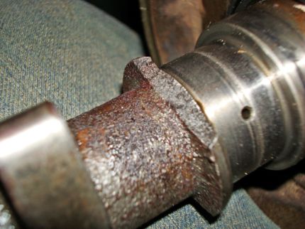

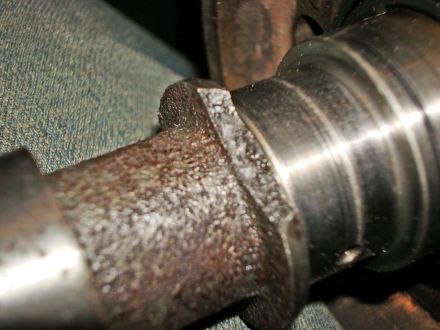

so my 4runner has a bad engine knock/tapping...sounded like it was comming from the top of the left side of the engine(facing in fron of truck) took the exauhst manifold off to get to the camshaft on that side, found the the bearing tops that are numbered and with arrows pointing them in the right direction were put on wrong and bearings on the shaft had some fairly decent depth groves in them...when i removed the camshaft i found 2 peice broken off up towards the belt wheel...could this be what is causing the low oil pressure and knocking?

doubtful. That was probably caused from someone trying to remove the cam when it was in a loaded position and it cocked and broke off the ears

the lobe is 2 smooth to just be a chip or break it looks as if it has been rubbing on somthing but i don't see anything there...what is a good way to tell if the cam journals are bad? i can feel a decent size cut with my finger nail...also the engine was rebuilt before i got a hold of it and the journals were deffantly put in the wrong positions and he had some of the arrows on them that show what way they go in the wrong direction could this have caused it? thanks

which way are the arrows going? Both sides dont point towards the front. There are numbers as well as arrows and they should all be in sequence. If you think that cam is rubbing on that broken part, you should probably replace it to be sure
