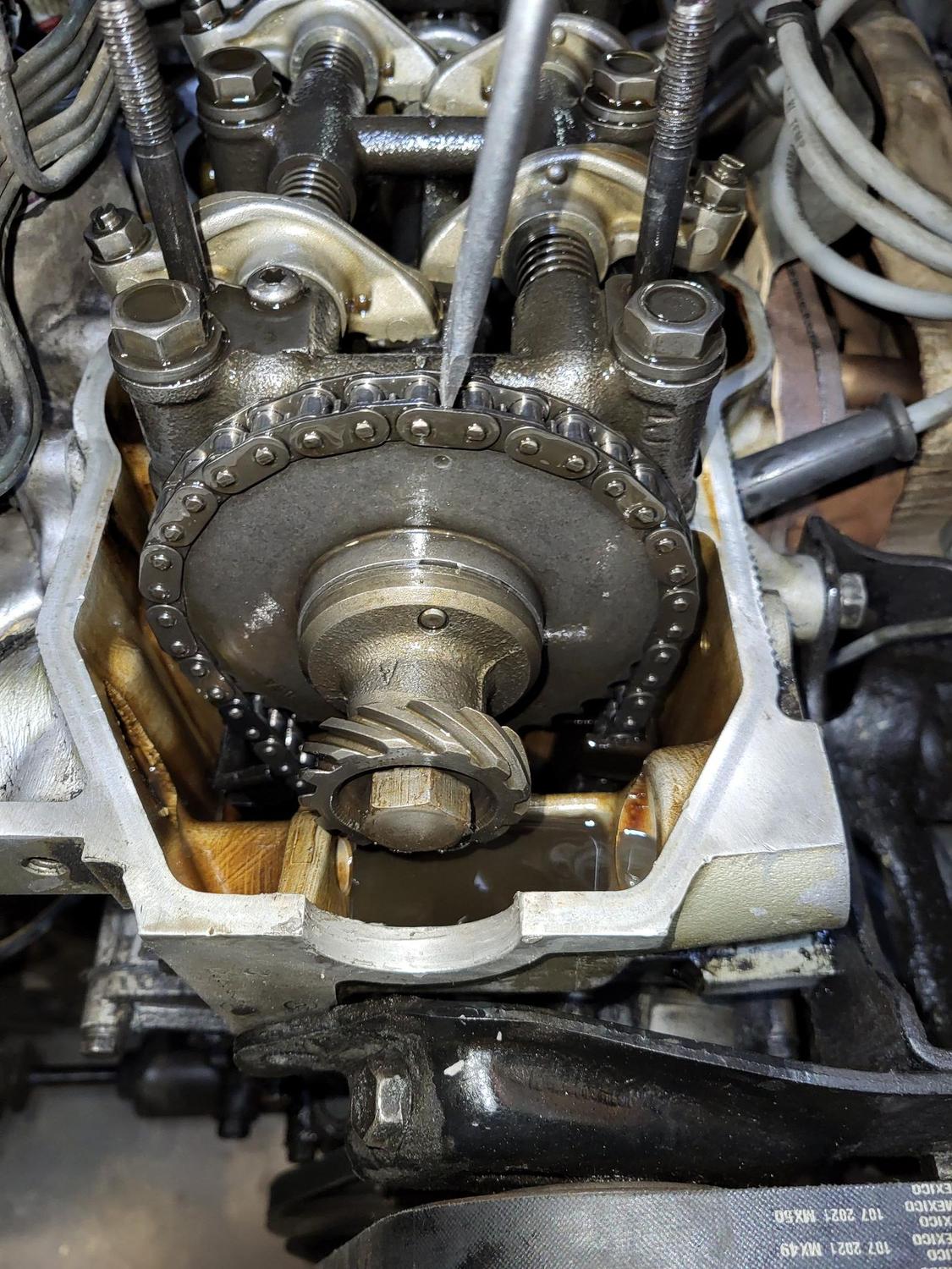

Timing chain off a tooth?
Distributor off a tooth?
Old Nov 23, 2023 | 07:36 PM
Garren's Avatar
Joined: Oct 2023
Posts: 9
I double checked the chain. While it wasn't perfectly straight up... it was really close. It like half a tooth off. I figure that's in the chain but heck, not bad right? Same with the distributor. I moved it a tooth forward and back and things got worse.
What is the mechanism that accelerates timing on throttle up? Is it the throttle position sensor? It seems that when the throttle advances slowly, the engine revs up fine. Quick throttle movement bogs it down.
