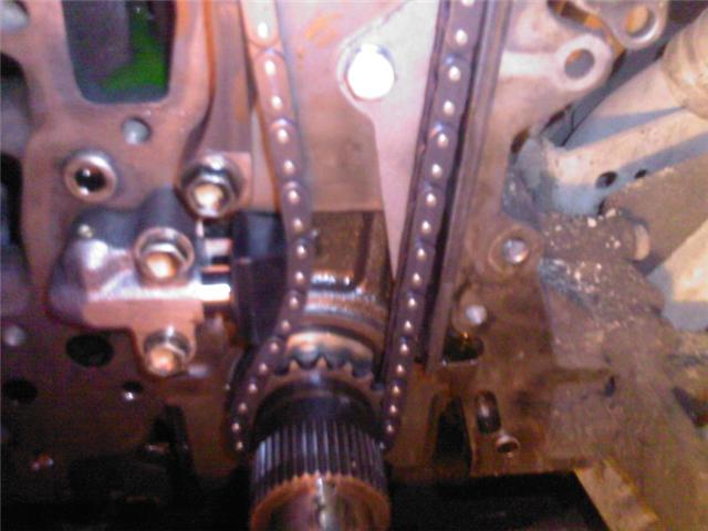

yeah i dont know man... thats what i thought. here's a pic of how the layout was when i installed it....looks fine to me, dont know what that noise could be. never did it before i had a timing chain problem...

Check your vacuum hoses where the brake booster goes into the intake. Make sure it and the PCV hose are not swapped.
Where did you get the tensioner? How did you hold it back while putting the sprocket on the cam? Screwdriver? Do you have the right bolts in the right spot on the chain cover? If you have a long bolt in the wrong hole you will bind the tensioner.
