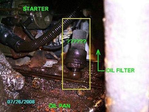

the other mystery fluid doesn't appear to be a mystery anymore. i would say it's definitely engine oil, i just don't know where from. i'd say it's either from the oil pan, or from this "thingy" slightly above it (see picture). i have no idea what the "thingy" is. (which is where all you come in). with the engine running the fluid constantly drips from the oil pan lip right beneath the "thingy", but i can't tell if it is coming from the oil pan lip or above at the "thingy". the "thingy" has visible threads, as you can see. i'm assuming this is not normal to see these threads. what is it? after the engine cools down i can go play with it and try to re-screw it in.
any help on this?

Originally Posted by ayoung101
any help on this?
oil pressure sending unit? and don't tighten it down too far- the threads on it are tapered and will cause the passage in the block to crack if it's tightened all the way down.
judging by the oil all over, I'd lean towards the front crank seal.

it could be a oil pressure sensor/oil sending unit. now that i narrowed it down to a close area, i'll just get the dye if i can't figure out exactly where it's coming from. i'm really hoping it's from this sensor (or whatever it is) and not the oil pan. the sensor would be a wee bit easier to change, haha.

Are there any wires coming out of it? If it was the sensor, there would be wires coming out, but I did not see any in the picture.

yes, there are wires coming out of it. i think 2, but i'm not sure.

i was wrong, it is only a single wire sensor. any idea what it is?

It's your oil pressure sending unit, like Abe said.
