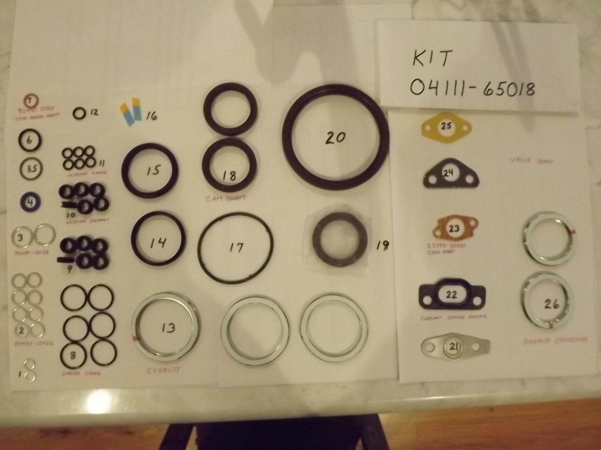

I just recently purchased the 3.0 3VZE overhaul kit from Toyota Dallas online. part 04111-65018 for $300.08, but I think I agree with blueknob and just get the head gaskets from Toyota. Some items, like the crush washer might be hard to find other than at the dealer. I think I have those part numbers too and will post later then you can see if they fit your using their online store.
The kit includes some "nice" items like the timing belt cover gaskets, but I could have just re-used the existing. I did not use several of the gaskets since I did not do removal all of the components. Have not done the math, but think it might have been better to not purchase the kit.
I will post pictures of the contents since I did not recognize some of the gaskets...they are "left overs" for me. The one gasket not included which is needed is the throttle body to intake plenum gasket.
Basically, includes
valve cover gaskets
exhaust manifold gaskets
intake manifold gaskets
head gasket
plenum gasket
injector rail crush gaskets
fuel injector o-rings, spacers and pintel caps (I think that is what they are called)
thermostat gasket
cam shaft seals
exhaust pipe gaskets for cross overs and back to cat converter
front main
rear main
cold start injector gasket
ERG gaskets
dip stick o-ring (at least that is what I used it for and it seems to fit)
water bypass housing gasket
valve seals (missing in picture because they had already been installed)
I have no clue what some of them are...like #16 and 17 in the pictures
For what it is worth, I pulled entire engine....and ended up replacing a lot of other things just because it was easier while engine was out such as stater contacts, alternator brushes, power steering pump gaskets, timing belt, oil cooler gaskets, etc, etc. Had to replace the coolant temp sensor and connector housing because it literally came apart when trying to disconnect the wire. Also plan on the injector housings breaking and replacing the knock sensor pigtail. I have a lot of these part numbers if you think they will help.
Attached Thumbnails Head Gasket Set-dscf7431.jpg   Head Gasket Set-dscf7428.jpg
