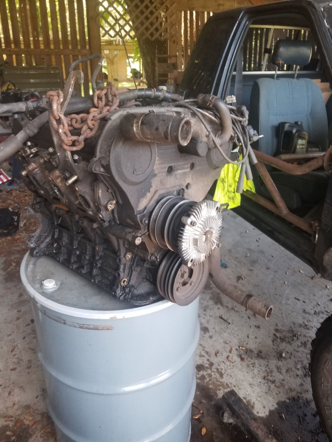

So I called around and couldn't find anyone that would rebuild my 3zve so I decided to buy a long block that was completely redun. So it's been a few weeks since I've gotten the old motor out with the new one sitting. So I decided to start taking everything off from the exhaust manifold down with in the first week or so then got swamped and work and out a ton of ot in. Now I'm tryin to figure out where everything went mostly mounting brackets and motor mounts and can't seen to remember when ˟˟˟˟ went. Wish I would of took pictures now. Can any one help me with pics or something that could help me out. I've been searching the internet and YouTube not having much luck. Thanx in advance. I
