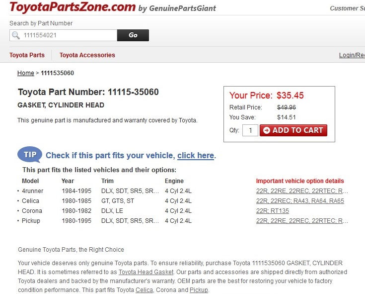

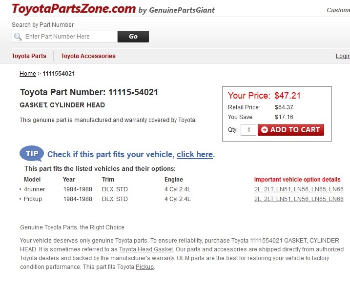

Lucky for you I'm bored...
Bookmark this site for future reference: Toyotapartszone.com
Search by part number and you find the following results:
Note: 2L & 2LT are diesels.
Note: Notice the 22R mentioned for the pickup.
Again, bookmark the site and you will be able to find alot of useful information, be able to cross check, see full part #'s, etc....
