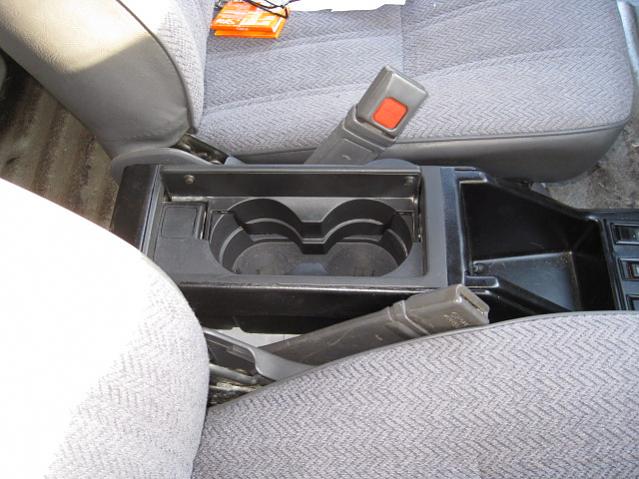

I did the Mich mod on my center console
New custom console - no but I did the mich mod (Mazda Integrated Cup Holder). It looks clean and man its it nice to have two cup holders!
Cup holder unit from Mazda 3 or 5 trimmed to size of 4Runner center console.
4Runner center console interior compartment cut out on drivers side to allow cup holder lid to open
Trimmed cup holder unit epoxied into 4Runner center console compartment
4Runner top trim pieces (Yes I found a use for these) cut to fit front and back of installed cup holder unit (purely cosmetic).
Attached Thumbnails has anyone built their own center console? lets see them pics....-img_1277.jpg   has anyone built their own center console? lets see them pics....-img_1279.jpg
