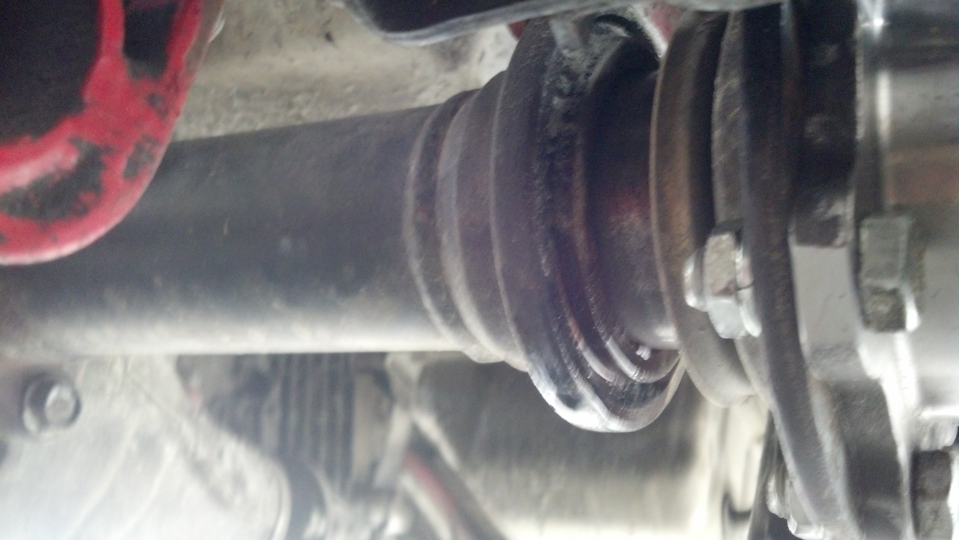

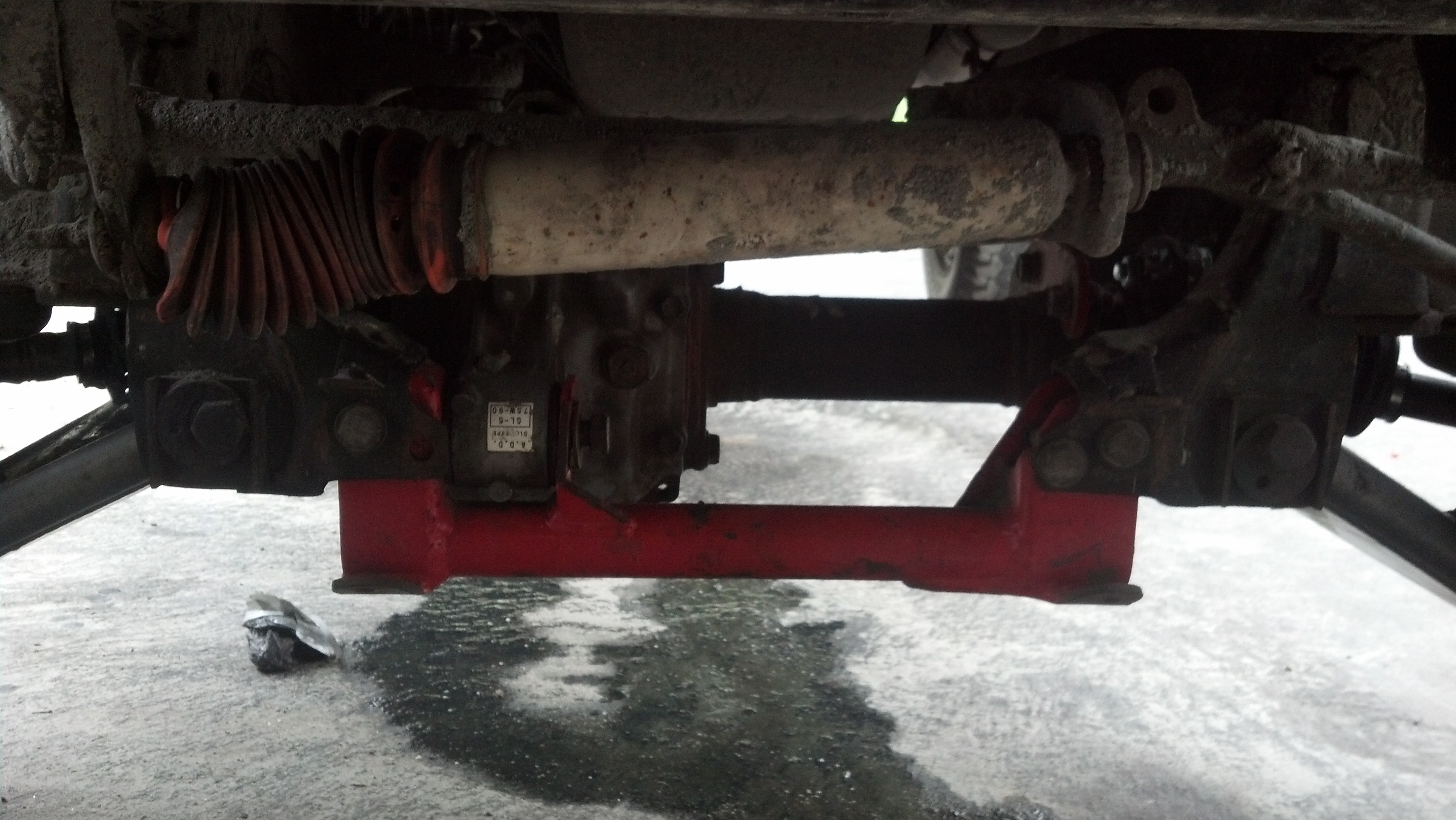

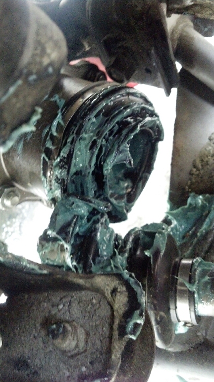

Here's some pics. The first pic is the halfshaft, the second is the axle where it seperated

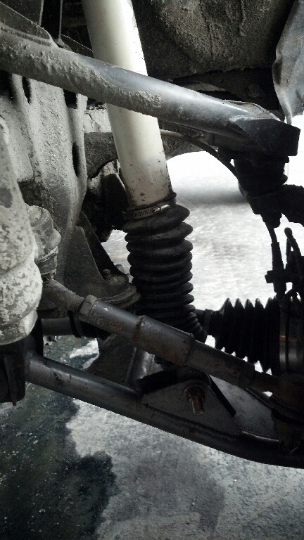

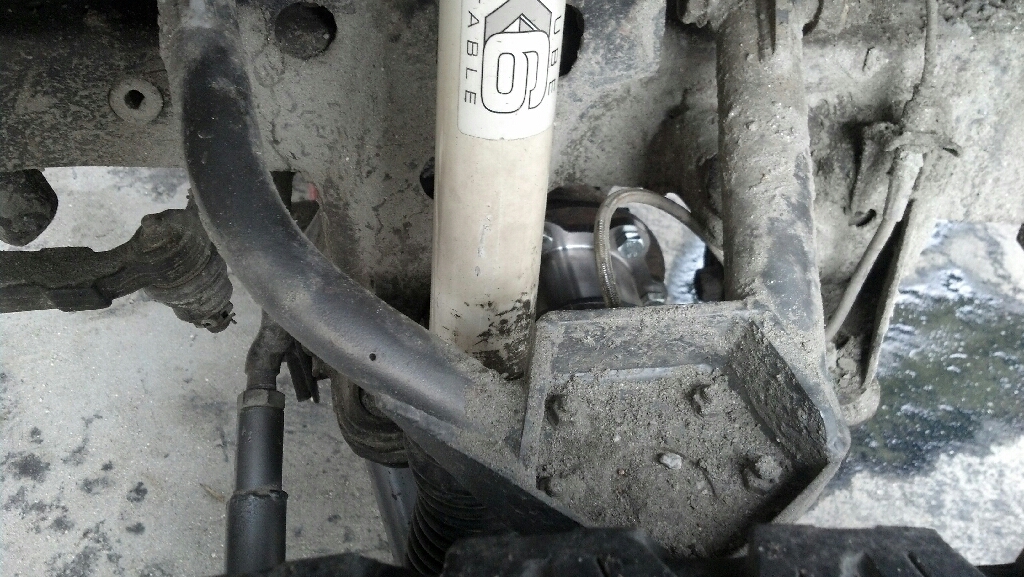

Here's some more. Measurments are 18 inches for the bottom arm and 14.5 for the top

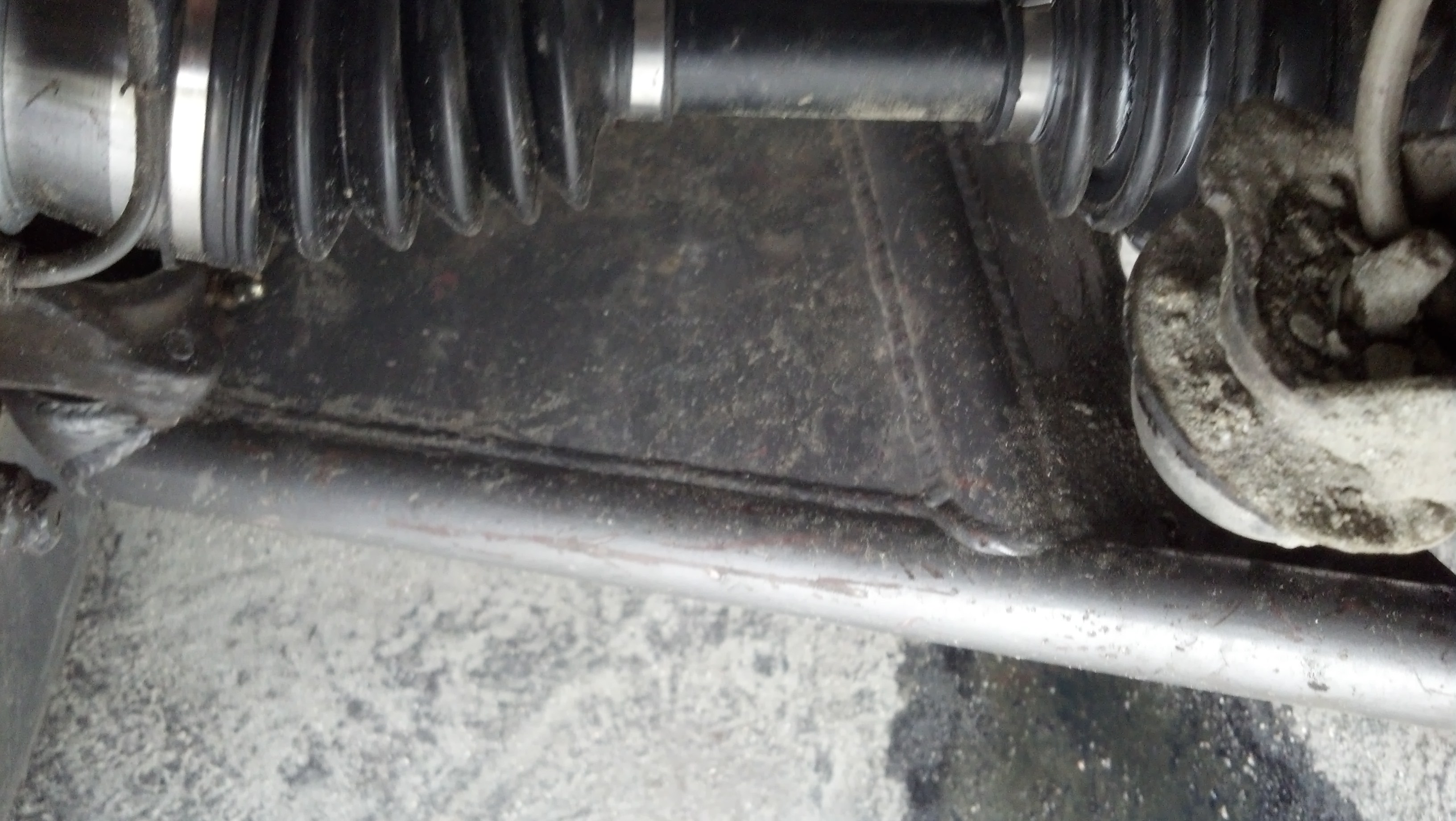

Last one

My lower arm measures about 15" from alignment bolt to ball joint castle nut. Sounds like you need t100 shafts, hopefully they're not actually too long with that custom diff drop(the red crossmember/anchor).

That looks like an old total chaos kit. T100 shafts SHOULD work The TC LT kits for that truck are 3.25 extended on each side.
You should just call the guy you got it from and figure out what exactly has been done to the truck.
That cross member kinda reminds me of how someone explained one of the old rancho kits to me but I have never seen one.
Hopefully that is not one of the first TC kits because they had a lot of problems with the torsion bar mounts ripping off the UCA. They fixed it later though.
on the plus side you could throw a coilover in there if you wanted to I think. And you should be able to get 12 or 13" of travel

I've tried getting ahold of him to no avail. I'm going to take back the broken one here in a week or so, as to not raise to many eye brows since I just returned it four days ago then try to swap both out for t100 shafts at a different store and just tell them I got the wrong ones. Anyways, I haven't taken it apart yet, saving it for after work this week, but in the second picture you can see the part of the axle the connects to the half shaft separated from the rest and is now leaking gear oil. Am I totally gummy beared or should this be a easy fix?

Are you installing the shafts yourself or are you getting the entire t100 unit? The outer CV is a pain to change... stupid internal snap ring...
I Think that whole shaft is held in by a snap ring and that you can just slide it back in.. I have only ever dealt with the short halfshaft on the passenger side though. Im not 100% on how that side is put together
see if you can find a parts diagram with an exploded view
Oh and I would stay away from spacers. I wouldnt mess with changing the pivot location of that inner cv in relation to the A arm brackets.
