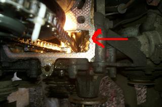

Um.......no, drew. You've got yer head on back'rds. It's the driver's side that has the coolant passage from the water pump. It's the side that has the coolant hose outlet. Seriouly....look closely at the red arrow in the pic. Then, look at the tailend of the arrow and you'll see the coolant hose. As well, if you think about it, it's the driver's side that has the slack in the chain until the tensioner sets up from oil pressure. That's why the driver's side guide rail is steel in the engnbldr kit. The pass side is still plastic. I've never seen the pass side fail, though. Not like the driver's side. That would have to be a mess.
Also, if you look closely at the pic again, you'll see the chain guide right up against the chain. It's hard to see it because of the glare from the light, but it's there.

The tensioner might have failed the oil really got alot of coolant in it, it was almost overflowing but the motor wasn't knocking. I think I'm just gonna fix whats wrong and if I get it all back together and the motor starts to knock then I'll rebuild it.
haha, true that, i shouldn't try to think after I've been drinking
Now that you mention it, I can't remember what side was worn through and re-welded, on my bro's 85 22r he had. ugh ... it was a mess tho. I replaced the cover, chain everything etc, he had the steel guide break on that one.
I stilla wanna say pass side, cuz it i remember it being low, but would make more sense if I saw it on the lower driver side..
