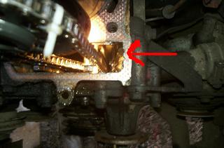

Recently the 22re in my 89 toyota pickup got alot of coolant in the oil and overheated. So I figured the head gasket went bad and pulled the head and when I did I noticed a groove in the timing chain cover where it looks like the chain has been rubbing. I know this can happen on worn chains but I replaced the head gasket 40k miles ago and when I did I also replaced the timing chain and guides with metal backed ones from engnbldr.com. I guess I'll have to pull the timing cover and see whats going on. I don't remember the groove being there last time I had it off but it has been awhile.

Did you replace the tensioner when you did the timing chain? Is your oil pressure good?

Depending how bad it wore thru.. there is a coolant passage way right there and even thoe you cant see it with your eyes it could be a pinhole leak....
mine was way worse btw, haa.

I replaced the tensioner with the chain. The oil pressure has always been good enough that it didn't trigger the idiot light. It may be a real small leak cause I believe the coolant had slowly been leaking into the crankcase for atleast 2 weeks before it got so bad that I caught it. There was also water in the throttle body and intake when i took everything apart.
Well, the only reason I asked was to try and explain why you might be getting wear marks on the timing cover with a timing chain and guide still intact. However, I'd have to say the grooves were there before and you didn't notice them. As was said, there is a coolant bypass right behind those grooves. And, probably.....most likely...........there is a hole. Too bad. If you have gotten coolant your crankcase, the bearings are probably damaged.
